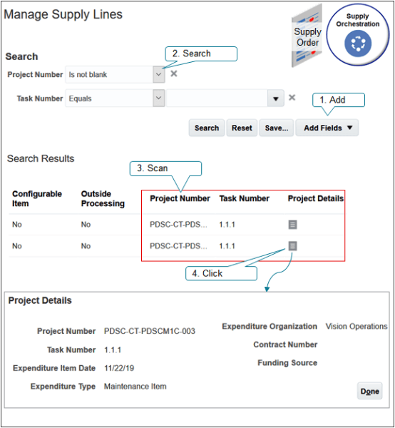

Examine Project Details
Go to the Supply Orchestration work area, then in the Search area, click Add Fields to add the Project Number and Task Number, then use these attributes to search for supply requests that include project data.
You can do your search on various pages in the Supply Orchestration work area:
  • Manage Supply Lines
  • Supply Order Details
  • Manage Supply Request Exceptions
View the full set of project data on each supply line, such as Project Name, Task Number, Expenditure Item Date, Expenditure Type, Expenditure Organization, Contract Number, and Funding Source.
For example, view them on the Manage Supply Lines page:
