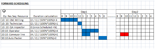

Forward Scheduling
If the work order is created using the start date of day 1 at 8:00 a.m., the application forward schedules the work order and computes the completion date as day 1 at 7:00 p.m. The resource duration is displayed in the following chart:
The following figure shows Forward Scheduling with six resources:
Forward Scheduling with six resources.
The following table presents the information that has been explained diagrammatically for Forward Scheduling:
Operation Sequence
Resource Sequence
Resource Name
Resource Duration
Scheduled Dates With Explanation
10
10
CNC Milling
(2/1)/ (50% *100%) = 4 hours
Forward Scheduling logic is applied from the first resource of the first operation.
The first operation is the Machining operation. Since the work order is being requested to start at 8:00 a.m., the first resource required for this operation is CNC Milling with required resource duration of 4 hours. The CNC Milling resource is scheduled from 8:00 a.m. to 12:00 noon.
10
20
Technician
(2/2)/ (100% *100%) = 1 hour
The Technician performing the task after CNC Milling resource is scheduled from 12:00 noon to 1:00 p.m.
10
20
QA Inspector
(0 hours (Since Scheduled= N)
The QA Inspector has no duration but shares the same resource sequence as the Technician, so the scheduled start and end time is 1:00 p.m.
20
10
Operator
(4/1) / (100%*100%) = 4 hours
The next operation is the Assembly operation. The Operator takes 4 hours to complete the task and is scheduled from 1:00 p.m. to 5:00 p.m.
20
10
Conveyor Line
(4/2) / (100%*100%) = 2 hours
The Conveyor Line resource is used in Assembly operation and is scheduled to start in parallel with the Operator. So the conveyor line operation starts at 1:00 p.m. and ends at 3:00 p.m.
30
10
Auto Packer
(2/2) / (50%*100%) = 2 hours
The Packing operation starts after Assembly operation at 5:00 p.m. and ends at 7:00 p.m. With this, the work order is completed.

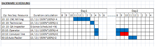

Backward Scheduling
If the work order is created using the completion date of day 2 at 1:00 p.m., the application backward schedules the work order and computes the start date as day 1 at 9:00 a.m. The resource duration is displayed in the following chart:
The following figure shows Backward Scheduling with six resources:
Backward Scheduling with six resources.
If the work order is created using the completion date of day 2 at 1:00 p.m., the application backward schedules the work order and computes the start date as day at 11:00 a.m.
The following table presents the information that has been explained diagrammatically for Backward Scheduling:
Operation Sequence
Resource Sequence
Resource Name
Resource Duration
30
10
Auto Packer
Backward Scheduling logic is applied and we start with the last resource of the last operation and compute the start date by scheduling operations in a reverse sequence of forward scheduling.
Since the work order is being requested to be completed on day 2 1:00 p.m., and the Auto Packer resource requires 2 hours, Packing operation starts on day 2 at 11:00 a.m. and ends at 1:00 p.m.
20
10
Conveyor Line
Next the prior operation Assembly is scheduled. The Conveyor Line resource used in this operation is unavailable for 2 hours on day 2 from 9:00 a.m. to 11:00 a.m., and so the application doesn't schedule this resource during that period. The Conveyor Line resource is used in Assembly operation and is scheduled from 8:00 a.m to 9:00 a.m. on day 2, and 4:00 p.m. to 5:00 p.m. on day 1.
20
10
Operator
The Operator working in the Assembly operation takes 4 hours to complete the task and is scheduled from 8:00 a.m. to 11:00 a.m. on day 2, and 4:00 p.m. to 5:00 p.m. on day 1.
10
20
QA Inspector
The QA Inspector has no duration but shares the same resource sequence as the Technician, so the scheduled start and end times is 4:00 p.m. on day 1.
10
20
Technician
The Technician performing the Machining operation is scheduled from 3:00 p.m. to 4:00 p.m. on day 1.
10
10
CNC Milling
CNC Milling requires 4 hours and is scheduled from 11:00 a.m. to 3:00 p.m. on Day 1 based on Backward Scheduling. So, the work order starts on day 1 at 11:00 a.m.

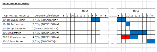

Midpoint Scheduling
If the work order is updated by invoking midpoint scheduling of work order operation 20 such that the operation 20 starts on day 2 at 11:00 am, the application performs midpoint scheduling as displayed in the following chart, such that the work order's start date is day 1 at 3:00 p.m. and completion date is day 2 at 5:00 p.m.
The following figure shows Midpoint Scheduling with six resources:
Midpoint Scheduling with six resources.
The following table presents the information that has been explained diagrammatically for Midpoint Scheduling:
Operation Sequence
Resource Sequence
Resource Name
Resource Duration
20
10
Operator
Invoking Midpoint Scheduling of work order operation 20, such that operation 20 starts on day 2 at 11:00 a.m. The Operator takes 4 hours to complete the task and is scheduled from 11:00 a.m. to 3:00 p.m. on day 2.
20
10
Conveyor Line
All downstream operations are scheduled using Forward Scheduling logic. So, the Conveyor Line resource is used in Assembly operation from 11:00 a.m. to 1:00 p.m. on day 2.
30
10
Auto Packer
The Packing operation starts on day 2 at 3:00 p.m. and ends at 5:00 p.m. With this the work order is completed.
10
20
QA Inspector
All upstream operations are scheduled using Backward Scheduling logic. So, the QA Inspector has no duration but shares the same resource sequence as the Technician, so the scheduled start and end times is 11:00 a.m. on day 2.
10
20
Technician
Invoking Backward Scheduling, the Technician performing the Machining operation is scheduled from 10:00 a.m. to 11:00 a.m. on day 2.
10
10
CNC Milling
The Technician shift time ends at 11:00 a.m. on day 2. The resource duration required is 4 hours. The CNC Milling resource shift is scheduled from 8:00 a.m. to 10:00 a.m. on day 2 and from 3:00 p.m. to 5:00 p.m. on day 1. This determines the work order start day as day 1 at 3:00 p.m.
