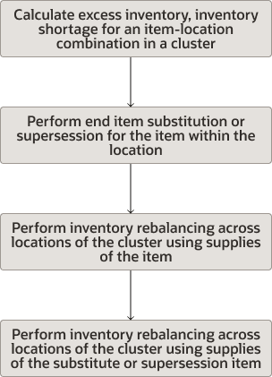

The following steps explain how end item substitution and supersession are performed along with inventory rebalancing:
  1. The excess inventory or inventory shortage is calculated for an item-location combination in a cluster. The substitution or supersession chains are ignored in this step.
    The logic for inventory rebalancing is used.
  2. End item substitution or supersession is performed within the location.
    The shortage of the item in the location is resolved through the use of the excess inventory for the substitute or supersession item at the same location. The demand for the item might be partially or fully met by the supply of the substitute or supersession item in the location.
    The logic for end item substitution and supersession is used.
  3. The remaining inventory shortages are resolved for the item through the use of the excess inventory for the same item in other locations in the cluster.
  4. Any remaining inventory shortages are resolved for the item through the use of the excess inventory for the substitute or supersession item in other locations in the cluster. The demand for the item might be partially or fully met by the supply of the substitute or supersession item in other locations in the cluster.
    The excess inventory is moved to the sweep location.
The process is summarized by the following diagram:
Figure summarizing process for performing end item substitution and supersession along with inventory rebalancing
