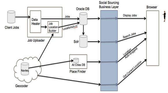

        Geocoding Principles and Architecture
        Sourcing attempts to automatically assign coordinates to all locations. This process uses several processes and databases including the following:
        The image shows the process of geocoding using several layers, databases and processes.
        PlaceFinder
        • Provides a list of locations when a user starts to type
        • Contains a database of all locations and their coordinates sourced from NavTeq and Geonames.org
        • Can be configured to show cities in specified countries
        • Displays locations in the users language
        eLocation Server
        • Provides coordinates for the locations during the geocoding process
        • Requires a city, state/region and country as input
        Solr
        • Solr is a keyword search engine. This means that you can give this engine a piece of text such as, "Father went to the grocery store" and it will be able to find this text as it searches for, "groceries." Geosearch relies on four Solr cores:
        Location Exception Core
        • Stores additional or customized locations coordinates not covered by the eLocation server
        1. Job Load
          First, jobs are loaded into Sourcing from Recruiting via the API. During this loading process, we identify new job locations and try to assign them coordinates.
        2. Geocoding
          We look for a coordinate in the Location Exception Core. This core stores all locations that are not found in our third-party vendor's database. It also contains fixes and modifications to incorrect data by our vendors. We send the triplet country, state and city to the Oracle eLocation Geocoder to get the coordinates. If a coordinate is not found, an Administrator will need to manually assign coordinates to this location.
        3. Index Jobs
          After the job locations are geocoded, the Solr Job Core pulls all the jobs from the database into itself. It then indexes all the text from the title, description, qualifications, company, category, and of course, the coordinates.
        4. Search
        5. The jobs are now ready to be searched. When a job search is performed, Sourcing constructs a Solr query and sends it to Solr using their REST API.

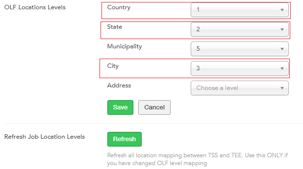

          Mapping Configuration
          Once you've verified the location tree structure and the names contained within the tree are accurate, you can configure the mapping in Sourcing to the location tree in Recruiting.
          Path: Sourcing > Configuration > Taleo > [Taleo Enterprise Edition]
          You need to indicate at which level the values for country, region/state and city can be found here. Municipality and address are not required for geolocation coding, but may be configured for other purposes. Once the mapping is configured, click the Refresh button to refresh the Job Location Levels.
          Note: When you refresh the job location levels, all job location data will be refreshed and re-geocoded based on the new values you configured in the OLF Location Levels fields. As a result, all manual updates that you made to the coordinates of particular job locations prior to the refresh will be lost.

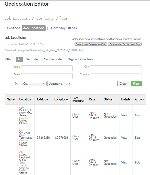

          Path: Sourcing > Configuration > Geolocation > [Geolocation Editor] > Click here to view the editor
          To create a backup file of your current geocoding, click the Click here to view the editor. The editor opens and you will select the Job Locations tab and then click the Backup Job Geolocation Data button. Now that your prior geocoding efforts are saved, you can trigger the new geolocation coding.
          Path: Sourcing > Configuration > Geolocation > [Geocoding - Job Locations] > Geocode Job Locations
          Click the Trigger button to initiate geolocation coding based on your new location mapping configuration. This action may take up to an hour depending on the number of jobs and locations you have to geocode.
          Verify the Geolocation Coding Results
          After the job location geocoding process completes, you should to back to the Geolocation Editor to verify that your locations have been geocoded properly.
          Path: Sourcing > Geolocation > [Geolocation Editor] > Click here to view the editor
          You can filter your geocoding results using the different tabs. You can see that your locations have now been assigned latitude and longitude coordinates and have been successfully geocoded. If your locations were not geocoded, you should review the location tree in Recruiting and verify the structure and names are accurate and also review the mapping configuration in Sourcing.

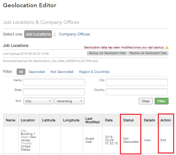

            If you identify that a location name is incorrect, you can correct it one of two ways: you can change the name of the location or provide the geocoordinates for the location.
            Changing the Name of the Location
            You can change the name in either Sourcing or Recruiting. To change the name in Sourcing, go to the Geolocation Editor and edit the Job Location.
            Click the Edit link next to a location that was not geocoded.
            When you click the link, click the Edit Location button in the modal that opens. You'll then be able to enter new values for city, region/state and country. When you click Submit, Sourcing immediately attempts to geocode the location with the new information you provided.

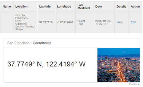

            Providing the Geocoordinates for the Location
            To provide the geocoordinates for the location, you follow the same path as above for editing the location as both editing the location and editing the coordinates are done in Sourcing using the Geolocation Editor. Instead of clicking the Edit Location button, click the Edit Coordinates button and enter the latitude and longitude for your location.
            Again, you can refer to Google Maps or Wikipedia to obtain these coordinates. They can be easily found by googling name of city coordinates, e.g., San Francisco coordinates. The first number provided is the latitude and the second is the longitude. South and West must be entered as negative and North and East as positive.

              Administrators can edit and add geolocation parameters using the Geolocation Editor.
              The Geolocation Editor displays which locations are geocoded and which are not. When data comes in that is not geocoded, the Geolocation Editor allows Administrators to geocode these locations by entering latitude and longitude parameters. Some locations do not have geolocation coordinates, such as rural areas or cities that are not incorporated. By entering the latitude and longitude manually in the Geolocation Editor, these locations can then be found using geolocator functionality. The Geolocation Editor provides the ability for Administrators to edit the geocoding of their locations to be certain those locations are properly placed. Users can search for locations, edit geocoding details of those locations, and then, re-trigger geocoding.
              Locations are easy to find using the filters and sorting capabilities in the Geolocation Editor. Administrators can filter and search job locations and company offices as well as sort the locations in either ascending or descending order. The filter criterion available differs depending on whether you are searching for job locations or company offices.
              The image shows the Geolocation Editor.
