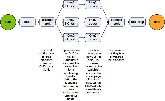

    Can OLF be used to send different notifications or tasks? No. Yes, using "branching" (routing) logic in E-Offer process.

                    The configuration of advanced electronic offers for Onboarding (Transitions) consists of the steps listed in this section. Other steps can be added depending on your requirements and process. Only one advanced E-Offer type process can be active in the zone at one time. Consequently, the process must be designed such that it is appropriate for every person in every location and for every job. It can be designed with as many different possibilities as needed.
                    Note: To configure an advanced E-Offer process designed to create a PDF document consisting of the offer letter, a cover page and candidates' decision accepting or refusing the offer, see also Viewing E-Offer Letter PDFs with the Advanced E-Offer Processand perform the additional steps described in

                                            The ability to configure branches (in a process) for multiple forms, each branch with its own "Send E-Offer response" task, and the ability to assign a different cover page to each advanced "Send E-Offer response" task can be used effectively to deliver customized cover pages to specific audiences. The following (greatly simplified) process illustrates how cover pages could target specific groups of candidates.
                                            Image showing a simple process where cover pages could target specific groups of candidates.

                                                        • In the Action field, select Display content page. In the Display Content Page field, select the content page you created that contains the personalized document list ({ContentPage.PersonalizedDocuments} variable.
                                                        • In the Action field, select Open PDF. In the Related Source field, select the cover page you created earlier.
                                                      7. Click Save.
                                                      8. Click Activate.
                                                      Incorporate this task into the advanced E-Offer process.
