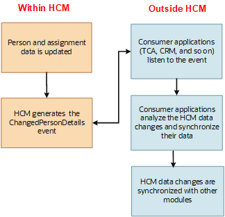

You may need to alert other Oracle Fusion applications when you make changes to person and assignment details to synchronize their information with Oracle Fusion Global Human Resources.
To share the changes made to person and assignment details with consumer applications, you need to run the Synchronize Person Records process. The process generates an HCM event, ChangedPersonDetails that consumer applications listen to.
The Synchronize Person Records process generates events and notifies about the person and assignment for Contingent Worker and Employee worker types only.
When you start the process, you can specify the start and end dates. The process generates events for the changes made between the start and end dates that you specified. If you don’t specify the dates, the process runs on the application date, and generates events for changes made on that date.
