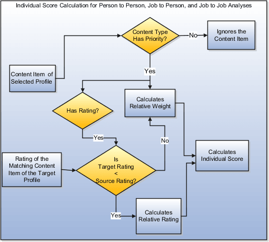

How the Individual Score for Person to Person, Job to Person, and Job to Job Analyses is Calculated
In best-fit analyses, each content item of the selected profile must match these target profiles: person to person; job to person; and job to job.
The individual score of each content item of the target profile is based on the priority set at the content type or content item level.
The following graphic shows how the individual score is calculated for each content of the selected profile that match with the target profile. The graphic is applicable for only person to person, job to person, and job to job analyses.
The individual score calculation for each content of the selected profile that match with the target profile. The graphic is applicable for person to person, job to person, and job to job analyses. The calculation is based on when the selected profile's content item has a priority and then a rating. If the content type associated with the content item has no priority, the content item is ignored in the calculation. If yes, if the rating of the matching content item of the target profile is less than the source rating. If the rating is less, the relative rating is calculated followed by the individual score. If the rating of the matching content item of the target profile is more than the source rating, the application calculates the relative weight and then the individual score.
