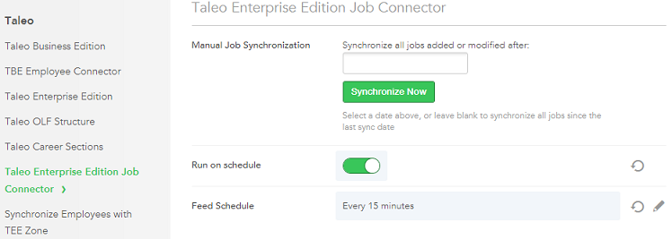

        Troubleshooting Issues Uploading Jobs
        If a job is posted in Recruiting, but is not loaded in Sourcing, there are several entities that should be verified and additional steps that can be taken to integrate the missing job.
        If it is discovered that a job that resides in Recruiting did not come over into Sourcing, consider the following:
        • Date override on Manual Job Synchronization
          Using the Manual Job Synchronization feature enables the Administrator to bring over jobs that did not come over through the feed. The scheduled Job Connector requests requisitions with a last modification time and date since the last time it ran. If there are jobs, which for some anomaly did not synchronize into Sourcing, the Manual Job Synchronization can be invoked to retrieve the missing jobs. Administrators enter a date into the Manual Job Synchronization and the synchronizer will request all jobs that are currently posted on the tethered career sections with a last modification date on or after the date selected.
          When no date is selected, clicking the Synchronize Now button will request jobs from Recruiting that were modified or posted after the last time the Job Connector ran. Selecting a specific date will request jobs from Recruiting which were modified or posted after the date entered.
        • Check the frequency set for the job feed
          For the initial loads or when adding some Career Sections to the configuration in Sourcing, it is recommended that a low synchronization frequency is used; e.g., every three hours. If there is large volume of jobs to load its best to let the synchronization complete before a new sync is performed.

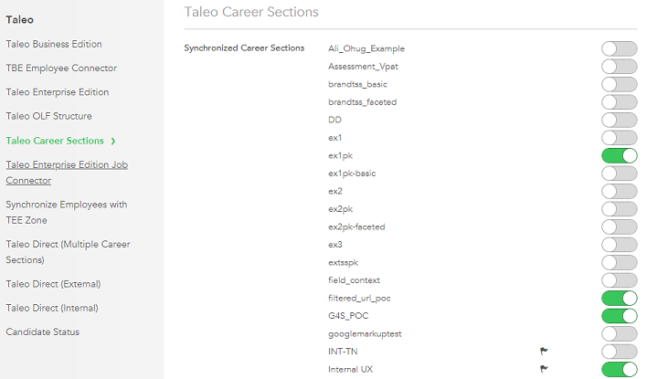

          Career Sections
          The jobs are loaded from the Career Sections that are linked with Sourcing. Administrators are easily able to select which Career Sections to sync through the Sourcing configuration.
          Path: Sourcing > Configuration > Taleo > [Taleo Career Sections]
          The image displays the different Career Sections listed and available to link from within the Sourcing configuration.
          The list displays all of the Career Sections that are active, public and on which there is at least one job posted. The jobs from each of the selected CS's will be loaded into Sourcing. The flag icon indicates that the CS is internal. When an Administrator runs the Career Section synchronization between OTAC and Sourcing, and subsequently a candidate applies to a job, Sourcing can route the candidate to the most appropriate CS application flow.

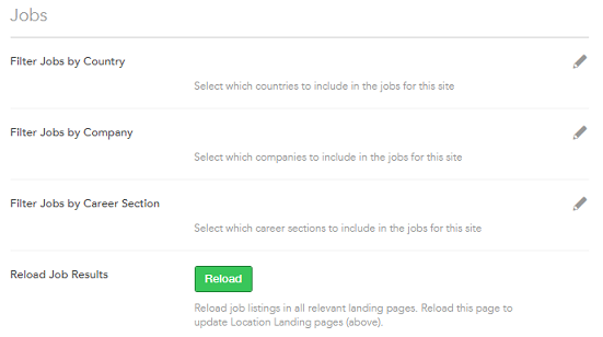

          Filtering can be applied to refine the list of jobs that are displayed at the Site level. Administrators can choose to filter jobs by country, by company (uses the Organization level) or by Career Section. It is possible to select just one CS or several CS's from which you want the jobs retrieved. This is done in the Site Builder settings. Once you change your filtering options, click Reload Job Results to apply the new filters.
          Path: Sourcing > Configuration > Site Builder > Edit Site Settings
          The image shows the filtering options for jobs in the Site Settings of the Site Builder configuration.

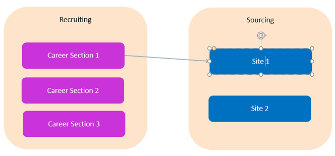

          The Relationship Between Career Sections and Sites
          In addition to having a 1:1 relationship between a Career Section and a Site, it is possible to create multiple Sites from a single instance of Sourcing. Each Site can have its own branding, job feed and vanity URL using a single Career Section or multiple Career Sections. Supporting multiple Sites allows for complex business cases and aligns with Recruiting configuration and the strategy in place when several Career Sections are being used. Supporting multiple sites is useful in that customers can choose to progressively roll out Sourcing as a solution; they can create a Site for each country, business line, job category, and so on.
          The image illustrates a 1:1 relationship with a Career Section and a Site.

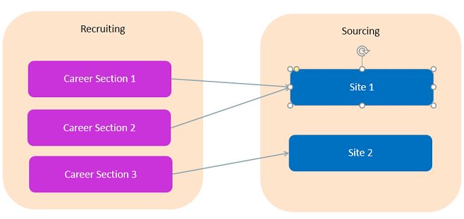

          The image illustrates multiple Career Sections being used in a single site and an additional 1:1 relationship.
          The image illustrates multiple Career Sections being used with two sites that are filtered by country.

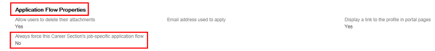

            For customers who tether multiple career sections with different application flows to a single Sourcing site, the following is recommended:
            For the career sections which are targeted by these Site Builder settings, it is best practice for customers to configure the “Always force this Career Section’s job-specific application flow” setting in Career Section to No.
            • Having this setting configured to No, ensures that candidates who edit their job submissions using the deeplink in Sourcing will be directed to the correct application flow; the flow in which the submission was originally created. A value of No here translates to saying, “Force the application flow on which this submission was originally created.” If a candidate applies to multiple jobs which are on multiple Career Sections, each with their own application flow, this allows that candidate to view or edit their submissions using the correct flow for a particular job.
            • This configuration mitigates any perceived need for multiple links to multiple career sections for accessing the My Submissions page.
            Path: Career Section Configuration > Administration > Career Sections > Select a career section > Properties (not Application Flow Properties) > Scroll down to Application Flow Properties
            The image shows the Application Flow Properties setting.

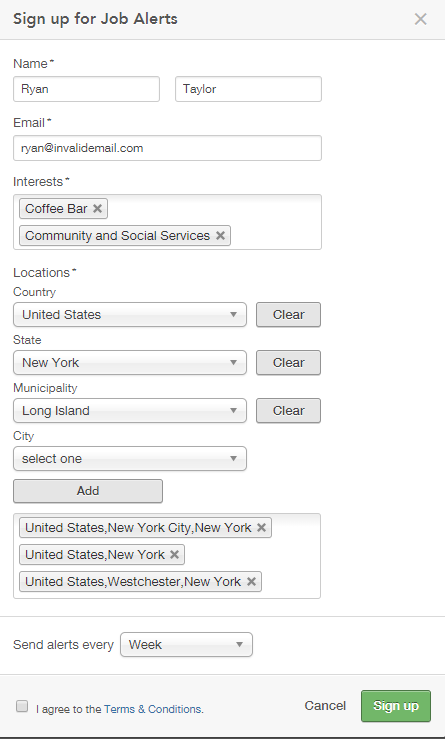

                Hierarchical Location Selector
                The Hierarchical Location Selector enhances usability by allowing the selection of locations through choosing levels such as country, state or province, city, and address.
                Administrators can choose to display the hierarchical selector to users that are:
                • Signing up for Job Alerts
                • Managing location preferences in Settings
                • Creating a user account using the Sign Up button (if displayed)
                The image shows the Hierarchical Location Selector with different location levels displayed when a user is signing up for Job Alerts.
                Users select locations by drilling into the location levels displayed. Locations can be added at any level by clicking Add. Individual levels can be cleared by clicking Clear.
                The Hierarchical Location Selector setting must be enabled for the hierarchical selector to display. This setting resides in Configuration > Users. The setting is delivered disabled; to enable the setting click on the toggle.
                Two other settings drive which levels display in the hierarchical selector and, in which order those levels display. The Location User Preferences setting (Configuration > Users > User Settings) determines which levels display in the Hierarchical Location Selector. Only the levels configured here will display in the hierarchical selector as choices for users. However, the order in which the levels are listed in this setting does not determine the order in which they will display in the hierarchical selector. Only levels that contain elements will be displayed.
                The OLF Locations Levels setting (Configuration > Taleo > Taleo Enterprise Edition) determines in which order the levels are displayed. Having the order of the levels configured with respect to this setting ensures that the Hierarchical Location Selector displays the levels in the same location hierarchy as in SmartOrg.

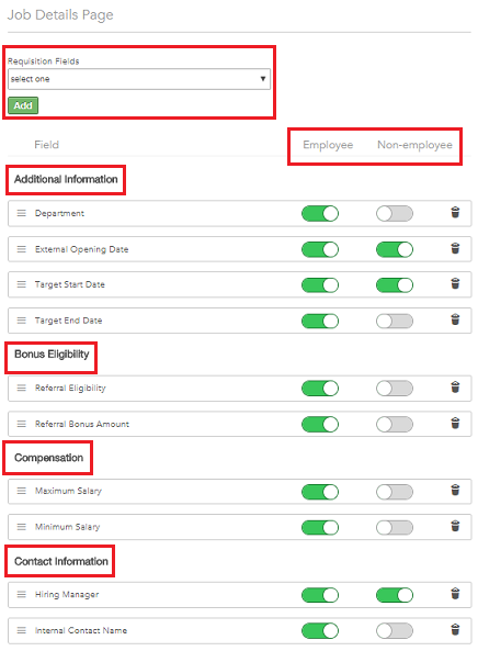

                  Requisition Data on Job Details Page
                  There are four sections on which to display up to twenty standard and user-defined fields total for each requisition. Customers can choose which fields to display on job requisitions at the site level and can further specify whether to show those fields to internal, external or both types of job seekers. This functionality allows job seekers to better evaluate if a job is right for them by learning more details about the job using this additional job-specific information.
                  An editor, the Field Display and Layout Editor, is available in Site Builder which provides the interface for Administrators to configure which fields and various sections display on the Job Details page for each site.
                  The four section titles can be relabeled in the dictionary if desired. Any field can reside in any section. The default sections are:
                  • Additional Information
                  • Bonus Eligibility
                  • Compensation
                  • Contact Information
                  The image shows the Field Display and Layout Editor.
                  New fields that are added appear in the Additional Information section and inherit the existing styling, colors and fonts used to show requisition data. Drag-and-drop allows Administrators to easily move the newly added fields to different sections and to reorder the fields within sections. Fields are easily removed by clicking the Trash icon. Fields which are not populated do not appear as blank to job seekers; the label is suppressed. When a section has zero displayed fields for a user the section title is suppressed.
                  Fields can be activated for display to employees, non-employees, or both by using the toggle next to each field. Note that non-employees are defined as users with a relationship of Other, Alumni or Referral.

                          Sign Up for Job Alerts Widget
                          To create a Job Alerts widget:
                          1. Use the settings in the Configuration area, under Widgets > Email Sign Up Widgets.
                          2. Click Create New Email Widget button.
                          3. Create and style the widget by editing the Title, internal only Notes, Description, and Button Text.
                          4. Set style features: Width (pixels), Height (pixels), Include Header toggle, Include Button toggle, Button Color.
                          5. Set the Location and/or Category and/or Company information for the alert.
                          6. Preview and save the widget information. Or you can Cancel.
                          7. In preview mode the first few job search results display in the widget.
                          8. Upon Save, code for the widget displays in the text field. It is read only and not editable.
                          9. Widget code can be copied and pasted (embedded) into HTML code on other web pages.
                          10. Users see the widget advertising your company and the Job Alerts.
                          11. Users can initiate signing up for alerts, and are redirected to a Sourcing modal to register.
