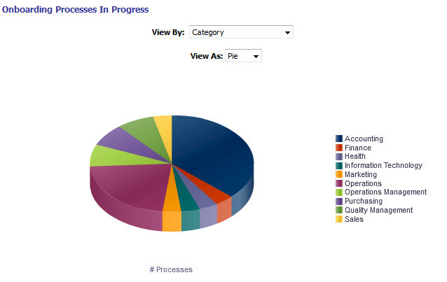

Onboarding - Process In Progress Summary
Displays the number of submission transition processes that are in progress, by a variety of dimensions.
Onboarding Process In Progress
Report Columns
Name | Syntax |
Dimensions | See View By: Dimensions |
# Processes | "Submission Transitions Process Counts"."# Submission Transitions Processes" |
View By: Dimensions
Name | Syntax |
Organization | "Requisition Organization"."Organization Level1 Name" |
Country | "Requisition Primary Location"."Location Level1 Name" |
Category | "Requisition Job Field"."Job Field Level1 Name" |
Department | "Requisition Department"."Department Name" |
Hiring Manager | "Requisition Hiring Manager"."Hiring Manager Name" |
Process Name | "Submission Transitions Process"."Submission Transitions Process Name (BL)" || Replace("Requisition Identification"."Req. Identifier","Requisition Identification"."Req. Identifier",'') |
Process Owner | "Submission Transitions Process"."Submission Transitions Process Owner Full Name" || Replace("Requisition Identification"."Req. Identifier","Requisition Identification"."Req. Identifier",'') |
Process Completion | CASE WHEN "Submission Transitions Process"."Submission Transitions Process Percent Complete" < 25 Then '0-25%' WHEN "Submission Transitions Process"."Submission Transitions Process Percent Complete" < 50 THEN '25-50%' WHEN "Submission Transitions Process"."Submission Transitions Process Percent Complete" < 75 Then '50-75%' WHEN "Submission Transitions Process"."Submission Transitions Process Percent Complete" < 100 Then '75-100%' END || Replace("Requisition Identification"."Req. Identifier","Requisition Identification"."Req. Identifier",'') |
Process Days In Progress | "Submission Transitions Process"."Submission Transitions Process Days In Progress" + "Requisition Identification"."# Openings" - "Requisition Identification"."# Openings" |
View Configurations
Name | Additional Information |
Pie | Slice Size: # Processes Slices: Dimension |
Table | Columns and Measures: Dimension, # Processes |
Report Filters
Name |
Submission Transitions Process Name (BL) is not null |
Submission Transitions Process Type is equal to / is in New Hire |
Submission Transitions Process Current Status is equal to / is in In Progress |
Onboarding - Dashboard Prompt Listener |

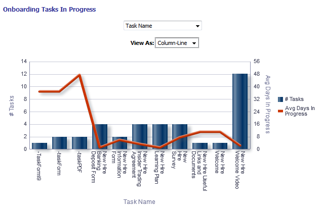

Onboarding - Tasks In Progress Summary
Displays the number of submission transition process tasks that are in progress, by a variety of dimensions.
Onboarding Tasks In Progress
Report Columns
Name | Syntax |
Dimensions | See View By: Dimension |
Avg Days In Progress | AVG(TIMESTAMPDIFF(SQL_TSI_DAY, "Submission Transitions Process"."Submission Transitions Task Assignment Date" , CURRENT_TIMESTAMP)) |
# Tasks | "Submission Transitions Process Counts"."# Submission Transitions Tasks" |
View By: Dimensions
Name | Syntax |
Process Health Is Red | "Submission Transitions Process"."Submission Transitions Process Progression Health Is Red" || Replace("Requisition Identification"."Req. Identifier","Requisition Identification"."Req. Identifier",'') |
Task Name | "Submission Transitions Process"."Submission Transitions Task Name (BL)" || REPLACE("Requisition Identification"."Req. Identifier","Requisition Identification"."Req. Identifier",'') |
Task Assignee | "Submission Transitions Process"."Submission Transitions Task Assignee Name" || Replace("Requisition Identification"."Req. Identifier","Requisition Identification"."Req. Identifier",'') |
Task Type | "Submission Transitions Process"."Submission Transitions Task Type" || Replace("Requisition Identification"."Req. Identifier","Requisition Identification"."Req. Identifier",'') |
Task Is Overdue | "Submission Transitions Process"."Submission Transitions Task Is Overdue" || Replace("Requisition Identification"."Req. Identifier","Requisition Identification"."Req. Identifier",'') |
Task Days In Progress | TIMESTAMPDIFF(SQL_TSI_DAY, "Submission Transitions Process"."Submission Transitions Task Assignment Date", CURRENT_TIMESTAMP) + "Requisition Identification"."# Openings" - "Requisition Identification"."# Openings" |
View Configurations
Pie | Slice Size: # Tasks Pies: Dimension |
Column-Line | Bars: # Tasks Lines: Avg Days In Progress Group By: Dimension |
Report Filters
Name |
Submission Transitions Task Current Status is equal to / is in In progress |

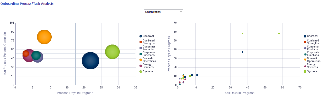

Onboarding - Processes In Progress Analysis
Onboarding Process/Task Analysis
The analysis consists of two charts.
The chart on the left displays # of processes, average percent complete and days in progress by a variety of dimensions,
The chart on the right chart displays # tasks, task days in progress and process days in progress by a variety of dimensions.
The column selector allows you to toggle the dimension for both charts at once.
Report Columns
Name | Syntax |
Process Days In Progress | "Submission Transitions Process Time"."Average Submission Transitions Process Days In Progress" |
Task Days In Progress | AVG(TIMESTAMPDIFF(SQL_TSI_DAY, "Submission Transitions Process"."Submission Transitions Task Assignment Date" , CURRENT_TIMESTAMP)) |
Avg Process Percent Complete | avg("Submission Transitions Process"."Submission Transitions Process Percent Complete") |
Task ID | "Submission Transitions Process"."Submission Transitions Task Name (BL)" || ' - ' || CAST("Submission General Info"."Submission Identifier" AS CHARACTER) || ' - ' || CAST("Submission Transitions Process"."Submission Transitions Task Creation Date" AS CHARACTER) |
View By: Dimensions
Name | Syntax |
View Configurations
Bubble | Horizontal Axis: Process Days In Progress XY (Vertical Axis): Avg Process Percent Complete XY (Bubble Size): # Processes Vary Color By: Dimension |
Scatter | Horizontal Axis: Task Days In Progress XY (Vertical Axis): Process Days In Progress Vary Color By: Dimension |
Report Filters
Name |

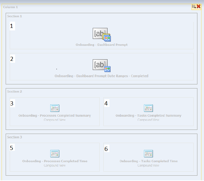

Onboarding - Completed
The dashboard page shows metrics on completed processes and tasks such as the number of processes completed compared to the number of processes canceled and counts on how many tasks in a process were overdue. The metrics can help you identify areas for improvement in your onboarding processes.
Component

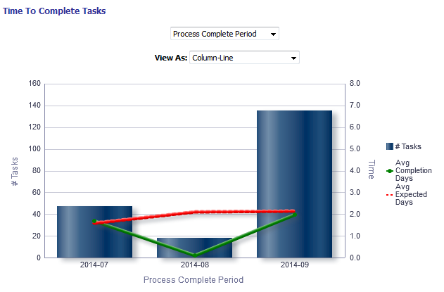

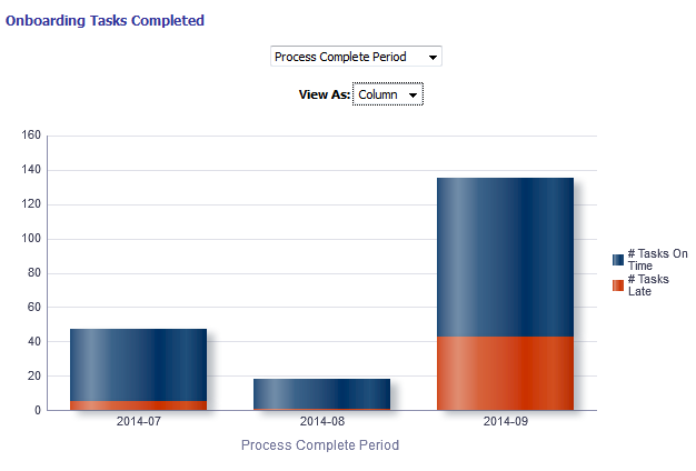

Onboarding - Tasks Completed Summary
This chart shows the number of tasks completed on time compared to the number of tasks that were completed late.
Onboarding Tasks Completed
Report Columns
Name | Syntax |
# Tasks On Time | FILTER("Submission Transitions Process Counts"."# Submission Transitions Tasks" USING ("Submission Transitions Process"."Submission Transitions Step End Date" <= "Submission Transitions Process"."Submission Transitions Task Due Date")) |
# Tasks Late | FILTER("Submission Transitions Process Counts"."# Submission Transitions Tasks" USING ("Submission Transitions Process"."Submission Transitions Step End Date" > "Submission Transitions Process"."Submission Transitions Task Due Date")) |
View By: Dimensions
Name | Syntax |
Task Assignee Department | "Submission Transitions Process"."Submission Transitions Task Assignee Department" || Replace("Requisition Identification"."Req. Identifier","Requisition Identification"."Req. Identifier",'') |
Process Complete Period | EVALUATE('TO_CHAR(%1,%2)' AS CHARACTER,"Submission Transitions Process"."Submission Transitions Process End Date",'YYYY-MM') || Replace("Requisition Identification"."Req. Identifier","Requisition Identification"."Req. Identifier",'') |
View Configurations
Column | Bars: # Tasks On Time, # Tasks Late Group By: Dimension |
Table | Columns and Measures: Dimension, # Tasks On Time, # Tasks Late |

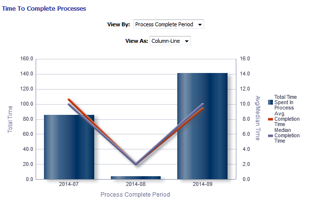

Onboarding - Process Completed Time
This chart shows total time to complete the process for all users who completed it, and also shows the average and median time it took users to complete the processes.
Time To Complete Processes
Report Columns
Name | Syntax |
Median Completion Time | MEDIAN("Submission Transitions Process"."Submission Transitions Process Days To Complete") |
Total Time Spent In Process | SUM("Submission Transitions Process"."Submission Transitions Process Days To Complete") |
# Submission Transition Processes | "Submission Transitions Process Counts"."# Submission Transitions Processes" |
Avg. Completion Time | "Submission Transitions Process Time"."Average Submission Transitions Process Days To Complete" |
View By: Dimensions
Name | Syntax |
View Configurations
Table | Columns and Measures: Dimension, # Processes, Total Time Spent In Process, Avg. Completion Time, Median Completion Time |
Column-Line | Bars: Total Time Spent In Process Lines: Avg. Completion Time, Median Completion Time Group By: Dimension |

Onboarding - Tasks Completed Time
This chart shows the number of tasks that have been completed, as well as the expected completion time and the average completion time in days.
Time To Complete Tasks
Report Columns
Name | Syntax |
Submission Transitions Task Name (BL) | "Submission Transitions Process"."Submission Transitions Task Name (BL)" |
Avg Completion Days | AVG(TIMESTAMPDIFF(SQL_TSI_DAY, "Submission Transitions Process"."Submission Transitions Task Assignment Date" , "Submission Transitions Process"."Submission Transitions Step End Date")) |
Avg Expected Days | AVG(TIMESTAMPDIFF(SQL_TSI_DAY, "Submission Transitions Process"."Submission Transitions Task Assignment Date" , "Submission Transitions Process"."Submission Transitions Task Due Date")) |
Total Time Spent | SUM(TIMESTAMPDIFF(SQL_TSI_DAY, "Submission Transitions Process"."Submission Transitions Task Assignment Date" , "Submission Transitions Process"."Submission Transitions Step End Date")) |
View By: Dimensions
Name | Syntax |
View Configurations
Table | Columns and Measures: Dimension, # Tasks, Avg Completion Days, Avg Expected Days, Total Time Spent |
Column-Line | Bars: # Tasks Lines: Avg Completion Days, Avg Expected Days Group By: Dimension |
Stacked Total Time By Task | Bars: Total Time Spent Vary Color By: Submission Transitions Task Name (BL) Group By: Dimension |
