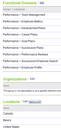

In addition to the user permissions a North American user group will be created and Kelly and Sam will be added to it.
  • The coverage area that is added to their North American user group will include all of the Performance functional domains, as well as the locations Canada, Mexico, and United States.
  • The location constraint means that they can only view items, such as performance reviews and development plans, for employees that are based in one of those three regions.
  • The Succession Employee Search domain is only available in this context. It is used to control which employees can be found when running a search from within a Succession Plan or Talent Pool. The employees Kelly and Sam can search for are limited to those in the North American user group.
Image showing an example of coverage area. The coverage area includes all the Performance functional domains, as well as the locations Canada, Mexico, and United States.
