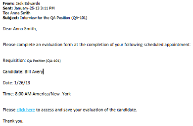

Displaying the Feedback Request URL as Text in Message Templates
When configuring Evaluation Management message templates, system administrators can put a URL token in the body of the message and to have the URL displayed as text instead of the entire URL string.
When evaluators receive a feedback request, the URL in the message appears as an hyperlink. When evaluators click the link, they are redirected to the appropriate questionnaire form.
Image showing a feedback request message containing a hyperlink redirecting the user to the appropriate questionnaire form.
Configuration > [Evaluation Management] Message Templates
  1. Click on a message template.
  2. In the Text field, add the wording where the URL will appear. For example, you could type "Please click here to access the evaluation form."
  3. Select the text you want to display as a hyperlink. For example, you could select the words "click here" in the above example.
  4. Click the Insert/Edit Link link icon.
  5. In the Link Info tab:
    1. Select URL in the Link Type drop-down.
    2. Select <other> in the Protocol drop-down.
    3. Select Evaluation URL in the Merge Field drop-down (which only appears after selecting <other>). The URL field will then display the following value: {#EvaluationURL#}.
    Image showing the Link Info tab in the Link window.
  6. Click OK.
  7. Click Save.
