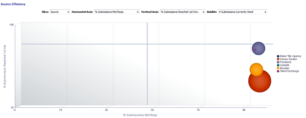

Recruiting - Source Efficiency Analysis
The chart enables comparing of sources across various measures.
Source Efficiency
Image showing a bubble chart
Selected Columns
Short sentence or paragraph to describe the configuration table.
The table shows graph data and syntax if any

Horizontal Axis
Vertical Axis
Bubble
Filters

Slice
The table shows the fields used to slice the data in the graph
Name Syntax
Source "Submission Source"."Submission Source (BL)"
Source Type "Submission Source"."Submission Source Type (Display As)"
Filled Period EVALUATE('to_char(%1,%2)' as char,"Requisition Dates"."Latest Filled Date" ,'YYYY-MM')
Horizontal/Vertical Axis
Type Permission
Name Syntax
% Submissions Met Reqs.
cast(
        FILTER("Candidate Counts"."# Submissions Min. Requirements Met"
        USING ("Submission General Info"."Submission Is Completed"='Yes'))
    / "Candidate Counts"."# Submissions Complete"
as float)*100
% Submissions Complete cast("Candidate Counts"."# Submissions Complete"/"Candidate Counts"."# Submissions" as float)*100
% Submissions Ace
cast(
        FILTER("Candidate Counts"."# Submissions Ace"
as float)*100
% Submissions Reached Reviewed cast("Candidate Counts"."# Submissions Reached Reviewed"/"Candidate Counts"."# Submissions Complete" as float)*100
% Submissions Reached 1st Intv. cast("Candidate Counts"."# Submissions Reached 1st Intv."/"Candidate Counts"."# Submissions Complete" as float)*100
% Submissions Reached Offer cast("Candidate Counts"."# Submissions Reached Offer"/"Candidate Counts"."# Submissions Complete" as float)*100
% Submissions Reached Hired cast("Candidate Counts"."# Submissions Currently Hired"/"Candidate Counts"."# Submissions Complete" as float)*100
Bubble
This table shows graph data and syntax if any
Name Syntax
# Submissions Currently Hired "Candidate Counts"."# Submissions Currently Hired"
# Submissions Reached 1st Intv. "Candidate Counts"."# Submissions Reached 1st Intv."
# Submissions Reached Offer "Candidate Counts"."# Submissions Reached Offer"
# Submissions Ace "Candidate Counts"."# Submissions Ace"
# Submissions Min. Requirements Met "Candidate Counts"."# Submissions Min. Requirements Met"
# Submissions Complete "Candidate Counts"."# Submissions Complete"
# Submissions Reached Reviewed "Candidate Counts".""
Bubble Graph Configuration
This table shows graph configuration
Name Location
Horizontal Axis Horizontal Axis
Vertical Axis Vertical Axis
Bubble Size Bubble
Vary Color By Slice
