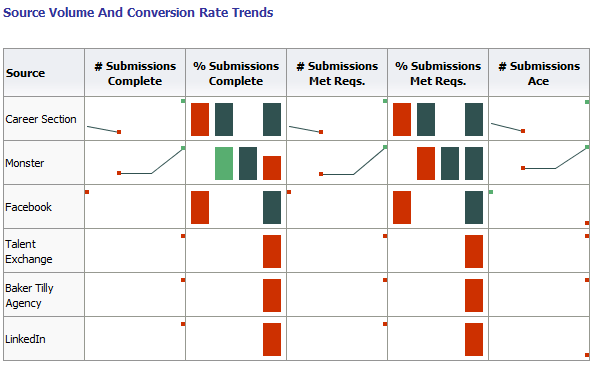

Recruiting - Source Yield Stats (Line Trellis)
The trellis provides a table view of trends for sources across a variety of measures.
Source Volume and Conversion Rate Trends
Image showing a mixed column and line charts in a table

Filters
This table shows report filters
Name
Submission Source Type (Display As) is not null
Submission Source Type (Display As) is prompted
Submission Source (BL) is prompted
Recruiting - Summary Dashboard Prompt Listener
Trellis Configuration
This table shows graph configuration
Name Location
Rows Source
Measures
# Submissions Complete
% Submissions Complete
# Submissions Met Min Reqs.
% Submissions Met Min Reqs.
# Submissions Ace
% Submissions Ace
# Submissions Reached 1st Intv.
% Submissions Reached 1st Intv.
# Submissions Hired
% Submissions Hired
# Ace Hires
% Ace Hires
Visualization
View As: Spark Line
Lines: Filled Period
# Submissions Ace
# Submissions Hired
# Ace Hires
Visualization
View As: Spark Bar
Bars: Filled Period
% Submissions Ace
% Submissions Hired
% Ace Hires
