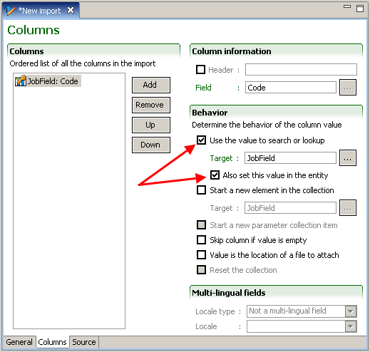

Entity Key Column
An entity must have a search key. A key can be composed of one or more fields. This key is used to retrieve corresponding information in the Net Change database.
In the Behavior section, check “Use the value to search or lookup” and “Also set this value in the entity” to create a new entity or to update an existing entity. If “Also set this value in the entity” is not checked for a create operation, certain entity types will create records without a known key value, and it will then be impossible to search for these records to update them afterwards. For other entity types, the records are not created and an error message is returned.
Image showing the New Import Columns window.

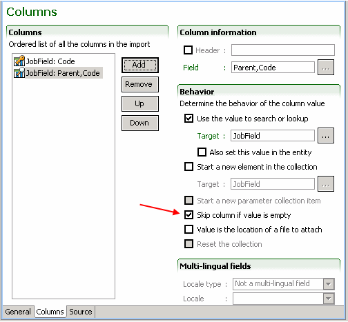

Skip column if value is empty
To prevent the processing of fields where no value is provided, select Skip column if value is empty in the Behavior section.
Hierarchical entities such as Organization, Location, JobField, and Department, where root elements do not have a value in the parent column will be processed anyway.
Image showing the Columns window.

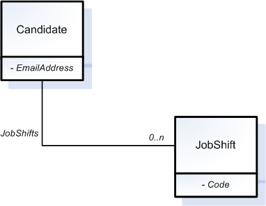

Simple collection
A Candidate who has a collection of JobShifts.
Image showing a candidate who has a collection of job shifts.

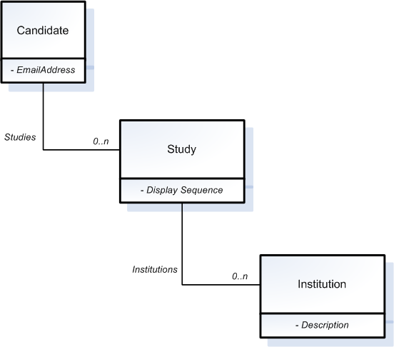

Complex collection
Image showing a complex collection.
Let say that in the CSV file we support two Studies:

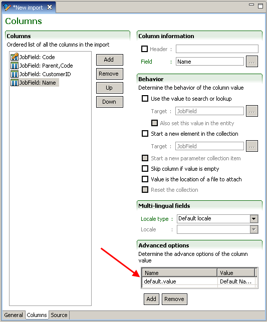

Default Column Value
A default value can be specified for columns that have no value set in the customer CSV file. For example, to use English as default value for field User.CorrespondenceLanguage, set the default value to “en” in the column advanced options:
Note that “Default Column Value” processing is not done when “Skip column if value empty” is checked.

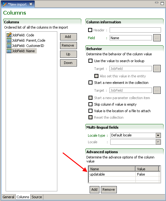

Non-Updatable Column
Some field values only need to be sent to the target application once, usually during the create operation. Once the column is defined as Non-Updatable, the field values contained in that column are not sent to the target application in an update operation.
This advanced option is Net Change specific. No other TCC functionality uses it. Set updatable value to false in the column advanced options:
