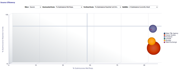

Recruiting - Source Efficiency Analysis
The chart enables comparing of sources across various measures.
Source Efficiency
Image showing a bubble chart

Horizontal Axis
Vertical Axis
Bubble

Bubble Graph Configuration
Name Location
Horizontal Axis Horizontal Axis
Vertical Axis Vertical Axis
Bubble Size Bubble
Vary Color By Slice
