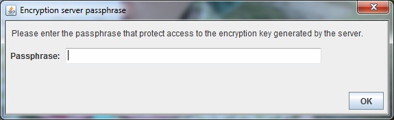

Step 3. The encryption server can now be started, call your_java_location –jar encryptionkey-server.jar.
a. On Windows platform - the following screen prompts is displayed to the user. The user should enter a passphrase value. This value is masked with *.
b. On platform - command line will prompt user for passphrase entry.
On starting the EKS for the first time, an AES symmetric encryption key is generated. This will be automatically saved into the conf/ClientKey.key file. The user entered passphrase is used to protect access to the encryption key value stored in this file. Each new installation of the EKS will generate a different & unique encryption key. Due to this, it is strongly recommended that a backup of the key file is made and saved in a secured location. In doing so, it is possible to recover encrypted data if there is a failure with the original implementation. Using the same passphrase would unlock the encryption key needed to decrypt the data. At all subsequent EKS startups, the entered passphrase will be used to unlock the encryption key needed to decrypt any encrypted data.
