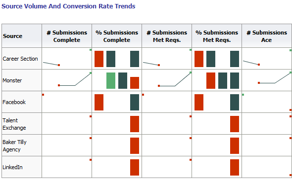

Recruiting - Source Yield Stats (Line Trellis)
The trellis provides a table view of trends for sources across a variety of measures.
Source Volume and Conversion Rate Trends
Image showing a mixed column and line charts in a table
Selected Columns
Name Syntax
Filled Period EVALUATE('to_char(%1,%2)' as char,"Requisition Dates"."Latest Filled Date",'YYYY-MM')
Source Type "Submission Source"."Submission Source Type (Display As)"
Source "Submission Source"."Submission Source (BL)"
# Submissions Complete "Candidate Counts"."# Submissions Complete"
# Submissions Met Reqs. "Candidate Counts"."# Submissions Min. Requirements Met"
# Submissions Ace "Candidate Counts"."# Submissions Ace"
# Submissions Reached 1st Intv. "Candidate Counts"."# Submissions Reached 1st Intv."
# Submissions Hired "Candidate Counts"."# Submissions Currently Hired"
# Ace Hires FILTER("Candidate Counts"."# Submissions Currently Hired" USING ("Submission Prescreening Results"."Is Ace" = 'Yes'))
% Submissions Complete cast("Candidate Counts"."# Submissions Complete"/"Candidate Counts"."# Submissions" as float) * 100
% Submissions Met Reqs. cast(FILTER("Candidate Counts"."# Submissions Min. Requirements Met" USING ("Submission General Info"."Submission Is Completed"='Yes'))/ "Candidate Counts"."# Submissions Complete" as float)*100
% Submissions Ace cast(FILTER("Candidate Counts"."# Submissions Ace" USING ("Submission General Info"."Submission Is Completed" = 'Yes'))/ "Candidate Counts"."# Submissions Complete" as float)*100
% Submissions Reached 1st Intv cast("Candidate Counts"."# Submissions Reached 1st Intv."/"Candidate Counts"."# Submissions Complete" as float) * 100
% Submissions Hired cast("Candidate Counts"."# Submissions Currently Hired"/"Candidate Counts"."# Submissions Complete" as float) * 100
% Ace Hires
cast(
        USING ("Submission Prescreening Results"."Is Ace"='Yes'))
    /"Candidate Counts"."# Submissions Ace"
as float) * 100
Filters
Name
Submission Source Type (Display As) is not null
Submission Source Type (Display As) is prompted
Submission Source (BL) is prompted
Recruiting - Summary Dashboard Prompt Listener
Trellis Configuration
Name Location
Rows Source
Measures
# Submissions Met Min Reqs.
% Submissions Met Min Reqs.
# Submissions Ace
% Submissions Ace
% Submissions Reached 1st Intv.
# Submissions Hired
% Submissions Hired
# Ace Hires
% Ace Hires
Visualization
View As: Spark Line
Lines: Filled Period
# Submissions Ace
# Submissions Hired
# Ace Hires
Visualization
View As: Spark Bar
Bars: Filled Period
% Submissions Ace
% Submissions Hired
% Ace Hires
