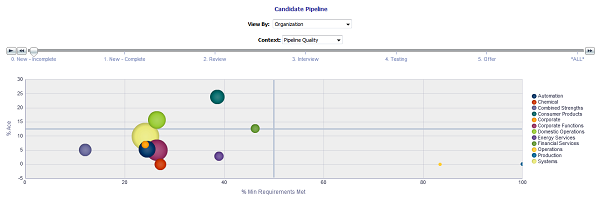

Recruiting - Pipeline Summary
The chart provides a quantitative and qualitative summary of the candidate pipeline on requisitions across various dimensions.
Image showing a bubblechart

View Configurations
Name Additional Information
Pipeline Quality
Horizonal Axis: % Min Requirements Met
XY(Vertical Axis): % Ace
XY(Bubble Size): # Submissions
Vary Color By: Dimension
