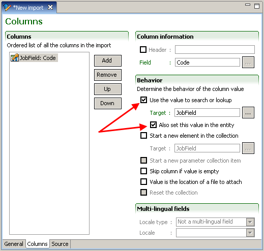

Entity Key Column
An entity must have a search key. A key can be composed of one or more fields. This key is used to retrieve corresponding information in the Net Change database.
In the Behavior section, check “Use the value to search or lookup” and “Also set this value in the entity” to create a new entity or to update an existing entity. If “Also set this value in the entity” is not checked for a create operation, certain entity types will create records without a known key value, and it will then be impossible to search for these records to update them afterwards. For other entity types, the records are not created and an error message is returned.

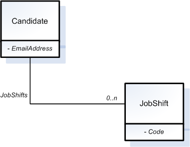

Simple collection
A Candidate
who has a collection of JobShifts
Let say that in the CSV file
we support up to three JobShifts

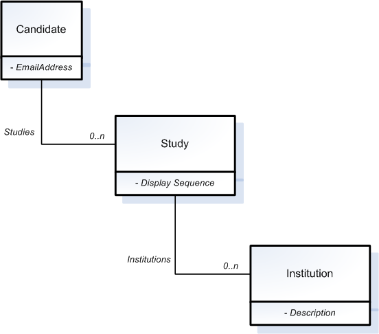

Complex collection
Let say that in the CSV file we support
two Studies

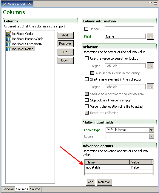

Non-Updatable Column
Some field values only need to be sent to the target application once, usually during the create operation. Once the column is defined as Non-Updatable, the field values contained in that column are not sent to the target application in an update operation.
This advanced option is Net Change specific. No other TCC functionality uses it. Set updatable value to false in the column advanced options:
When all columns are defined, save the input file and generate the CSV file.
