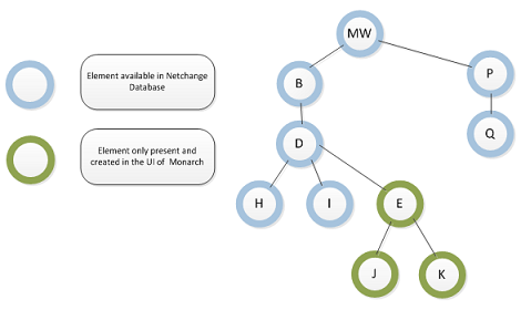

  3. Transactions done directly in the Monarch application.
    1. We can generate an invalid structure in “Net Change database ” and destroy the “Net Change process” when we are doing modification in the UI of Monarch (Element in Green) while doing Net Change with TCC.
      If we do a “Net Change Setup” action using an existing element ( in Monarch, Element J) that is not directly linked to an element of the partial “tree” (used in “Net Change”), the “tree” is not valid anymore.
    2. If we do a “Net Change Setup” action using an existing element (in Monarch, Element E) that is directly link to an element of the partial “tree” (used in the “Net Change”), the “tree” is valid and it's possible to do Net Change if we do a “Setup” first and then a “Computation”.
Image showing a hierarchical entity.
Examples:
  • Case-1: Do Net Change Computation only (Move “Element J” under “Element B”).
    Monarch Functional Error: …You cannot update the following field: BaseComposite.Parent.
    Note that the field value and the supplied value don't match (as described in 3-a).
  • Case-2: Do Net Change Setup & Computation (Move “Element J” under “Element B”).
    • Setup runs with success.
    • Computation TCC WorkFlow Error: The parent node associated to this key has not been found …. (as described in 3-a).
  • Case-3: Do Net Change Computation only (Move “Element E” under “Element B”).
    Note that the field value and the supplied value don't match (as described on 3-b).
  • Case-4: Do Net Change Setup & Computation (Move “Element E” under “Element B”).
    • Computation runs with success (as described on 3-b).
