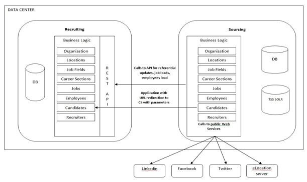

Uploading Jobs
Sourcing directly integrates with OTAC Recruiting providing full autonomy to the Sourcing Administrator and multilingual support with no integration to maintain.
Select which of the Career Sections will feed Sourcing.
Filter jobs by country or company.
Group several Career Sections for each site.
Use different Career Sections for each site.

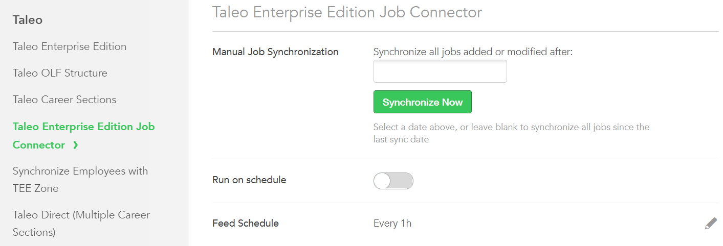

Path: Sourcing > Configuration > Taleo > [Taleo Enterprise Edition Job Connector]
