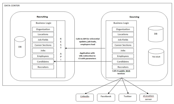

The image is an illustration of the integration points between Recruiting and Sourcing.

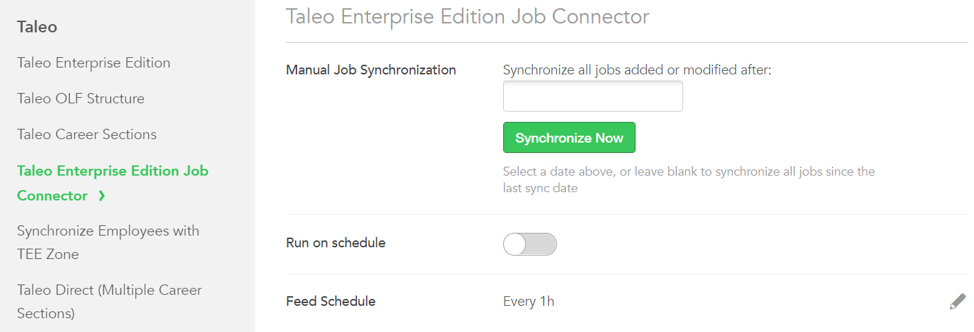

Path: Sourcing > Configuration > Taleo > [Taleo Enterprise Edition Job Connector]
This image shows the Job Connector in the Sourcing Configuration.
