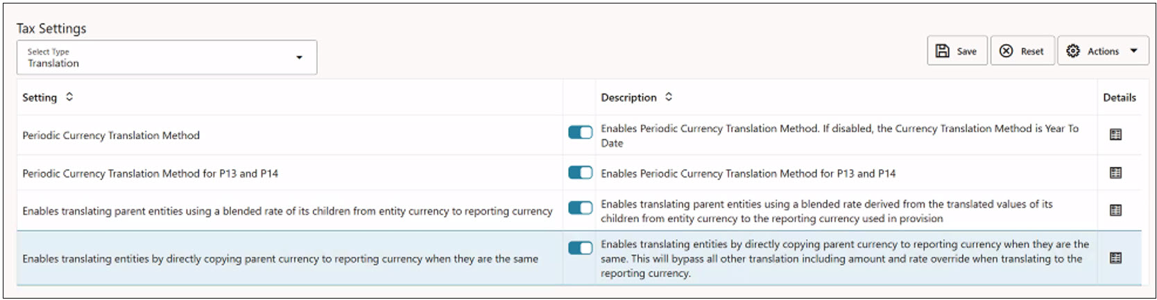

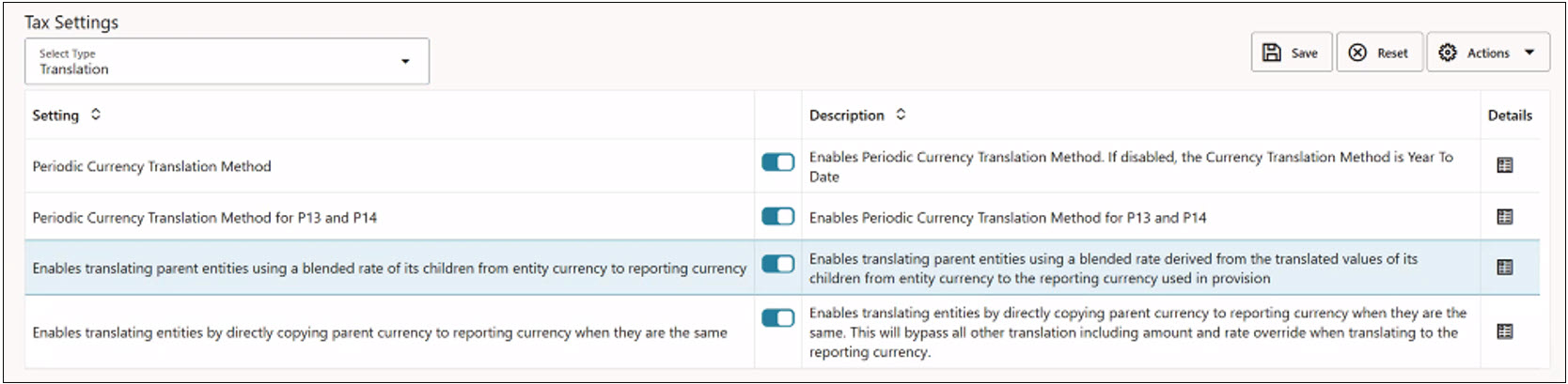

To use parent entities using blended FX rate children, the following tax settings can enabled:
  • Translation
    • Enables translating parent entities using a blended rate of its children from entity currency to reporting currency
      Tax Settings - Translation: Translating parent entities using a blended rate of its children from entity currency to reporting currency
      • Uses Blended rate for Provision (Entity Currency → Reporting Currency)
      • Enables translating parent entities using a blended/effective rate derived from children.
    • Enables translating entities by directly copying parent currency to reporting currency when they are same
      Tax Settings - Translation: Translating entities by directly copying parent currency to reporting currency
      • Bypasses translation and directly copies Parent Currency to Reporting currency when they are the same
      • If parent currency equals reporting currency, the system copies values directly (no translation).
      • If disabled, the reporting currency may not equal the parent currency even if they are both the same actual currency as amount/rate overrides may have been applied to reporting currency translation of children entities that have not been applied to the parent entity.

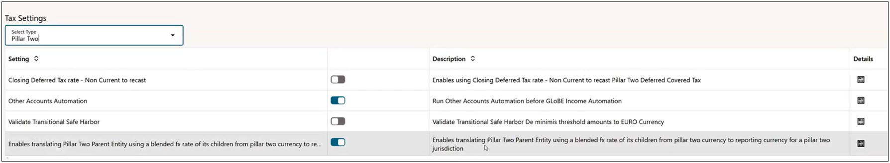

  • Pillar Two
    Enables translating Pillar Two Parent Entity using a blended fx rate of its children from pillar currency to reporting currency
    Tax Settings - Pillar Two: Translating Pillar Two Parent Entity using a blended fx rate of its children from pillar currency to reporting currency
    • Uses Blended rate for Pillar Two (Pillar Two Currency → Reporting Currency)
    • Enables translating Pillar Two parent totals using a blended/effective rate derived from children.
    • If enabled, this applies to the translation of the pillar two currency for each pillar two jurisdiction for all entities assigned to that jurisdiction in that Scenario/Year/Period.
