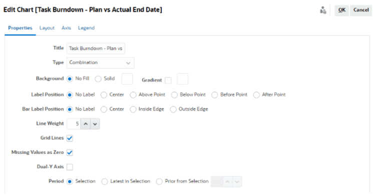

- Click the Edit icon at the top-right to display the Edit Chart dialog.
- In the Properties tab, specify the following:
                      - In Type, select Combination.
- In Background, select No Fill.
- In Label Position, select No Label.
- In Bar Label Position, select No Label.
- Select Line Weight as 5.
- Select Grid Lines.
- Deselect Dual Y Axis.
- In Period, select Selection.

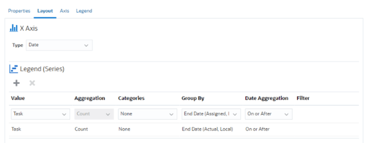

                     In the Layout tab, specify the following:  - In the X-Axis section, for Type, select Date.
- In the Legend (Series) section, enter 2 values:
                           For the first entry: - In Value, select Task.
- In Categories, select None.
- In Group By, select End Date (Assigned)
- In Date Aggregation, select On or After.
 For the second entry: - In Value, select Task.
- In Group By, select End Date (Actual, Local)
