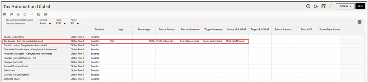

If you have configured a Tax Automation Rule, then the value from the Tax Automation Rule is aggregated with the value of Other Balance Sheet Adjustments from Tax Losses to Equity Automated in Temporary Differences form.
- Set up the Tax Automation Global Rule (see: Working with National Tax Automation in Administering Tax Reporting).

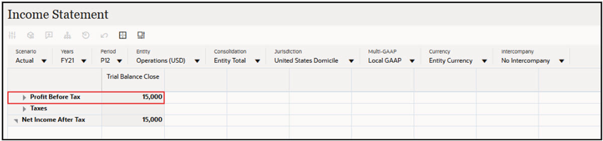

- Enter values for the POV used above in the Income Statement form, for example 15,000
as mentioned in the screenshot below.

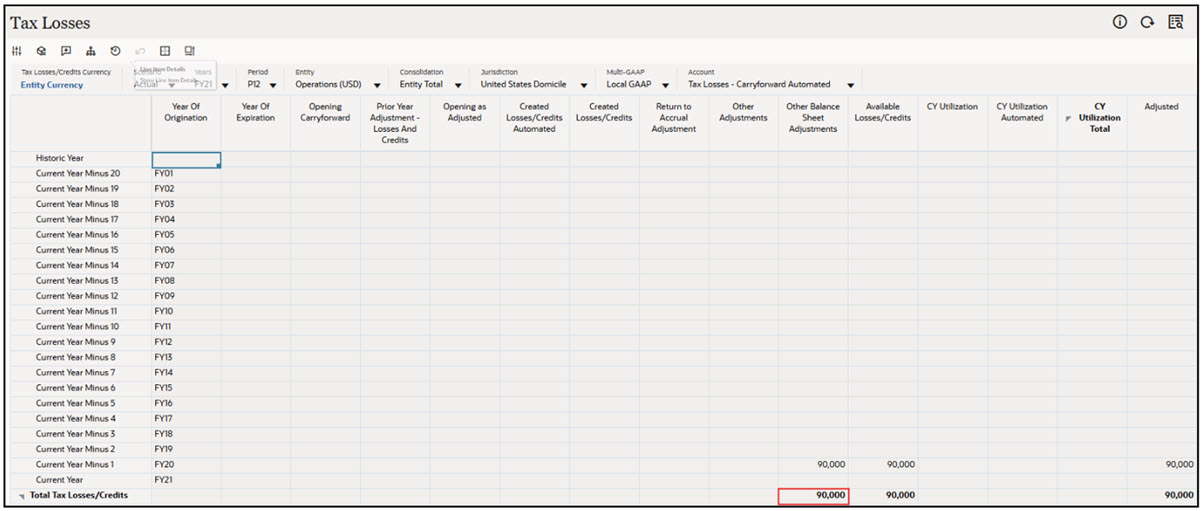

- Add values in Other Balance Sheet Adjustments in the Tax Losses form, for example
90,000 as mentioned in the example screenshot below.

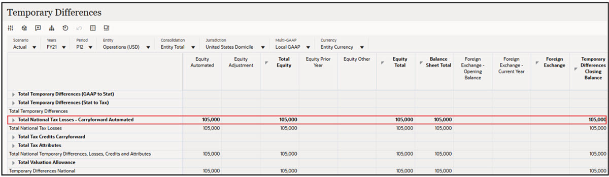

- Run Consolidation. Note that post consolidation, the Equity Automated of the
Temporary Differences form has the aggregated value of Tax Automation rule and Other
Balance Sheet Adjustments. For example: Equity Automated (105,000) = Other Balance
Sheet Adjustments (90,000) + Tax Automation Rule value (15,000)
