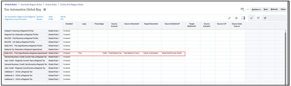

- Set up the Tax Automation Global Reg Rule (see: Working with Regional Tax Automation in Administering Tax Reporting).

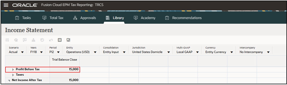

- Enter values for the POV used above in the Income Statement form, for example 15,000
as mentioned in the screenshot below.

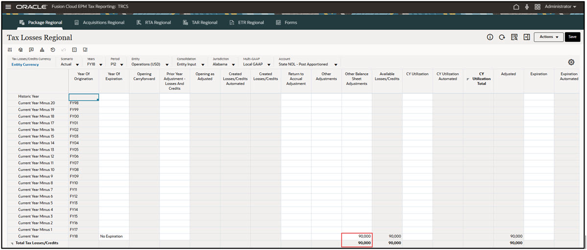

- Add values in Other Balance Sheet Adjustments in the Tax Losses Regional form, for
example 90,000 as mentioned in the example screenshot below.

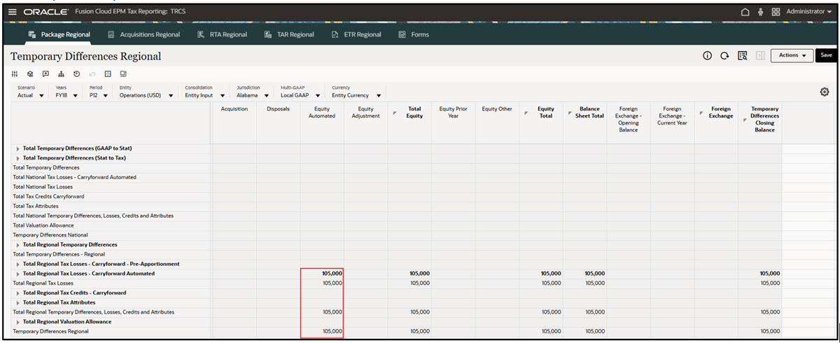

- Run Consolidation. Note that post consolidation, the Equity Automated of the
Temporary Differences Regional form has the aggregated value of Tax Automation rule
and Other Balance Sheet Adjustments. For example: Equity Automated (105,000) = Other
Balance Sheet Adjustments (90,000) + Tax Automation Rule value (15,000)
