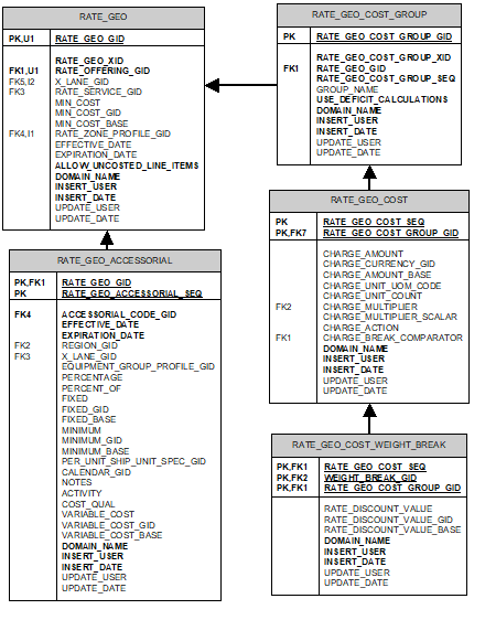

Simplified ERD for Truckload Rates
Simplified Entity Relationship Diagram (ERD) for Truckload Rate Data
RATE_GEO Table
  • Allow_uncosted_line_items in Y/N (defaults to “N”)
RATE_GEO_ACCESSORIAL
  • Left_Operand1 – Basis options define what variable you want to base your conditional charge on.
  • Oper1_gid – The operand you compare with.
  • Low_value1 – Depending on the operand you use, you might need only the low_value1 or additionally the high_value1.
RATE_GEO_COST_GROUP Table
  • Use_deficit_calculations in Y/N (defaults to “N”)
RATE_GEO_COST Table
  • Oper1_gid – field value “BETWEEN” is a shortcut for X > low and X <= high. Other possible values include “<”, “<=”, “>”, “>=”, “=”, and “<>”.
  • charge_unit_uom_code - unit of measure (e.g. “LB” for pounds, or “MI” for miles)
  • charge_unit_count - hundredweight, etc.
  • charge_action – add (A), setmin (M), setmax (X), multiply (D)
  • charge_break_comparator -identifies data element used to access the break
