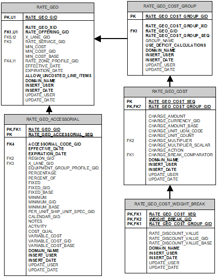

Simplified ERD for LTL Rates
Simplified Entity Relationship Diagram (ERD) for LTL Rate Data
Table Notes:
  • RATE_GEO Table
    Allow_uncosted_line_items in Y/N (defaults to “N”)
  • RATE_GEO_ACCESSORIAL
    • Left_Operand1 – Basis options define what variable you want to base your conditional charge on.
    • Oper1_gid – The operand you compare with.
    • Low_value1 – Depending on the operand you use, you might need only the low_value1 or additionally the high_value1.
  • RATE_GEO_COST_GROUP Table
    Use_deficit_calculations in Y/N (defaults to “N”)
  • RATE_GEO_COST Table
    • charge_unit_uom_code - unit of measure (e.g. “LB” for pounds, or “MI” for miles)
    • charge_unit_count - hundredweight, etc.
    • charge_action – add (A), setmin (M), setmax (X), multiply/discount (D)
    • charge_break_comparator -identifies data element used to access the break
