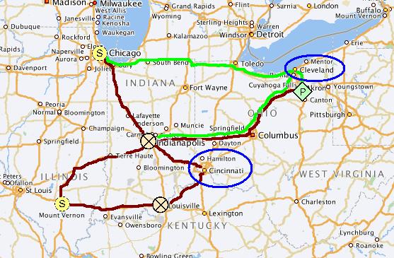

Network routing is a way to model transportation networks. Following is a simple example of a transportation network to illustrate network routing.
Note: This is a very simple transportation network for explanation purposes. Much more complicated scenarios are supported.
A map of the American midwest with routes tracked from Chicago, Indianapolis, mount Vernon, Louisville, Cincinnati, and Cleveland. Cleveland and Cincinnati are circled.
In this scenario, orders are to be shipped from distribution centers in Illinois to stores in Ohio. The scenario consists of:
  • Two source locations: Chicago and Mount Vernon.
  • Two cross docks: Indianapolis and Louisville.
  • One deconsolidation pool: Cuyahoga Falls.
  • Two destination regions, each with several destination locations: Northeast Ohio (around Cleveland) and Southwest Ohio (around Cincinnati). These are represented by the blue ovals.
The destination regions are served as follows:
  • Deliveries into the Northeast Ohio destination region are only via LTL (shown in green).
  • Deliveries into the Southeast Ohio destination region are only via TL (shown in dark red).
  • Shipments into either cross dock or the deconsolidation pool are via TL (shown in dark red).
Routing Choices
This example looks at an order from either source location to any destination location.
For example, an order from Chicago to a destination in Cleveland will have the following possible routes:
  • One shipment: LTL from Chicago into Cleveland.
  • Two shipments: TL from Chicago to Indianapolis cross dock; LTL from Indianapolis cross dock into Cleveland.
  • Three shipments: TL from Chicago to Indianapolis cross dock; TL from Indianapolis cross dock to Cuyahoga Falls pool; and LTL from Cuyahoga Falls pool into Cleveland.
Likewise, an order from Mount Vernon to a destination in Cincinnati will have the following possible routes:
  • Two shipments: TL from Chicago to Indianapolis cross dock; TL from Indianapolis cross dock into Cincinnati.
  • Two shipments: TL from Chicago to Louisville cross dock; TL from Louisville cross dock into Cincinnati.
Basically, TL shipments are rated by distance, and LTL shipments are rated by simple weight classes. Consolidating orders onto the same TL shipment generally will reduce costs, while consolidating orders onto the same LTL shipments generally will not.
