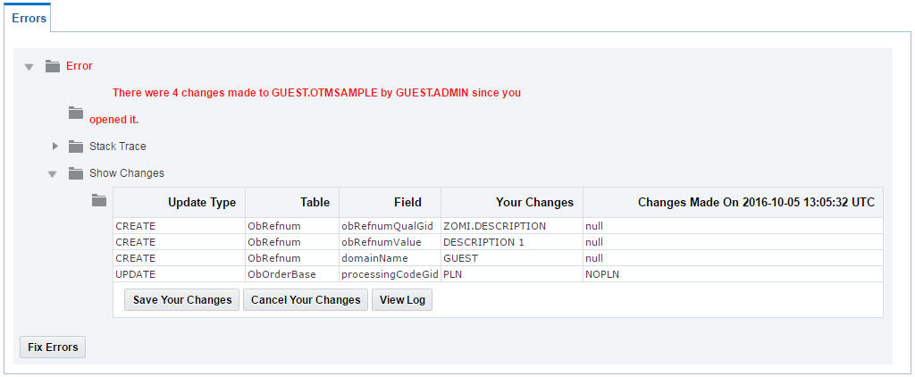

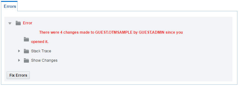

Data Reconciliation
For example, if two users open the same order base, make changes, and save the order, the user that saves the order last will see the following data conflict page. This page shows you that another person saved changes to the object since you opened it.
A screen shot of an error caused by data conflict.
Use the following options to view and resolve the data conflict:
  • Show Changes displays a summary of the data that has changed. In the example below, you can see that someone added a new reference number (the other user in this case) and the processing code (the change I made when I tried to save the change). You can override the change with yours or cancel to accept the change that was made by another user and not your own. The maximum number of changes that can be shown on this page is 1,000. If you think that you need more changes shown than that, please contact Oracle Support.
    Note: The list may not necessarily list just the data that a user changed. In some cases, other calculated data can also appear. For example, if you add a ship unit to an order base, there are calculated values for weight, volume, etc that get populated in the database. Data changes of this nature also appear in this list.
sample of error
  • Update Type displays one of the following values to identify the action that the current user performed to the data: CREATE, UPDATE, DELETE. UNKNOWN appears when someone else has changed a record in the database at the same time.
  • Table displays the name of the database table in which the data was changed.
  • Field displays the name of the column in the database table.
  • Your Changes displays the column value that you are submitting to the database.
  • Change Made On displays the date/time when changes were made by another user and the column value that was saved to the database.
  • Save Your Changes overrides previously made changes appearing in the Changes Made On column with the values in the Your Changes column.
  • Cancel Your Changes cancels your data changes and displays the business object with the previously saved changes (appearing in the Changes Made On column).
  • View Log displays the current log entries for the transaction.
