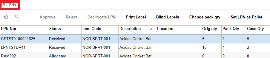

Setting up the "LPN is Pallet" flag to true for LPNs
As stated above, using option one requires extra configuration. You can only set the LPN’s “LPN is Pallet” flag to “TRUE” during receiving via a receiving RF module with special parameters configured. To configure this:
- Go to the “Screens Configuration” screen.
- Create a new “Receiving LPN Shipment” or “Receiving LPN Load” RF module.
- Select this record and click on its details.
- Modify the “pallet-handling” flag and set it to “LPN as Physical Pallet”.
- Now, every LPN that is received with this special RF module will have the “LPN is Pallet” flag enabled.

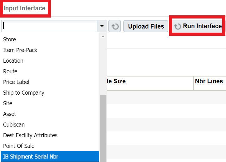

Step 2: Uploading the Interface File into WMS
- Go to the “Input Interface” screen.
- Use the drop-down to select the appropriate interface to process:
- Click on “Upload Files” and navigate to the file you wish to upload.
- When the file is displayed in the screen, click “Run Interface”.
- The system will return a message dialog notifying you that the file has been successfully processed.

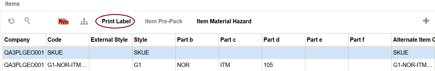

Item UI
Item labels can also be printed using the Print Label button from the Item UI:
When an item is selected on the Items UI, Print Label button is enabled. This button is not enabled when multiple items are selected. When you click the Print Label button, the following dialog pops up:
You can enter the number of labels required for this item and hit submit. Item labels will be printed to the default label printer configured for the logged in user. Since there is no option to change or enter a printer using this option, it is necessary that the default label printer is configured for the logged in user.

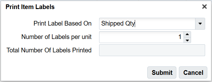

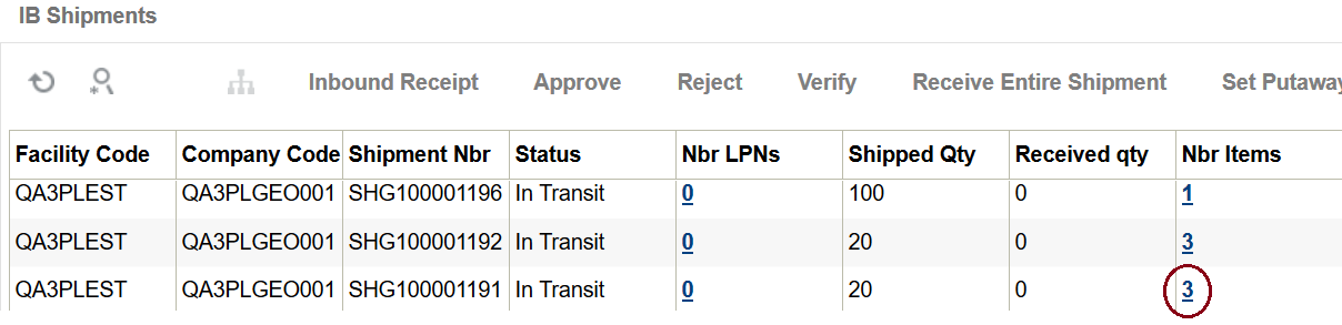

IB Shipment UI
There is also an option to print item labels from the IB Shipment UI. In the IB Shipments view, click on the Nbr Items hyperlink for the desired IB Shipment.
This brings up a view that lists all items on the shipment. There are two buttons available from this view:
- Print Item Labels – This button is only enabled when a single item is selected on this view. Item labels will be printed only for the selected item.
- Print All Item Labels – This button is always enabled and can be used to print labels for all items on the shipment
When you click either button, the following pop-up is displayed. You have the option to print labels based on Shipped Qty OR Received Qty. After choosing that, you need to enter the number of item labels that need to be printed for each unit.
For example, if Shipped Qty is selected (which is 10 in this example) and the number of labels per unit is 5, then 50 item labels will be printed for this item.
Similar to the item UI, since this option does not prompt for printer, you must configure the default label printer for the logged in user.

Step 3: Uploading the Interface file into WMS
- When the file displays, click “Run Interface”.

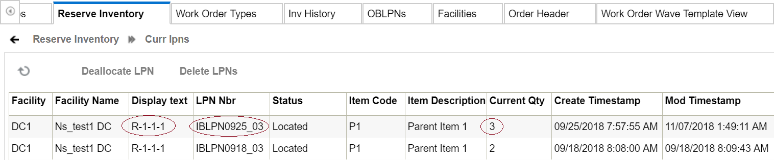

Reserve Inventory
The ReserveInventory screen provides detailed inventory information filtered by Location Area and Item Code. You can click on the linked LPN number in the “Curr lpns” column and see more information regarding the items in each LPN such as the Shipped Quantity, Current Quantity (by LPN), and Pallet Number.
IBLPNs
The IBLPNs screen contains detailed information about all the IBLPNs currently stored in the warehouse. This includes individual LPN information broken down by SKU such as its Status, Quantity, Current Location, Expiry Date, Pack, and Case quantity.
| Action Button | Description |
| Accept | If the LPN is Marked for quality control, you can accept it here. |
| Reject | If the LPN is Marked for quality control, you can reject it here. |
| Deallocate LPN | If the LPN is allocated, you can deallocate here. |
| Print Label | This button prints the LPN label according to the label template set up in Label Template View (label type IB Container) |
| Blind Labels | Allows you to print blind labels by selecting the number of labels, Label type (either IBLPN, OBLPN or Pallet), Destination company, and Destination facility. |
| Change Pack QTY | Allows you to change the pack quantity of the selected IBLPN. |
| Set LPN as Pallet | Allows you to Set LPN as Pallet. |
| Unset LPN as Pallet | Allows you to unset LPN as pallet. |
| Modify Qty | Allows you to modify the LPN quantity, and you must provide a reason code. |
| Locate LPN | Locates the LPN. If the flag capacity check is enable, the system will make sure that the LPN fits the location according to max volume, max units, and max weight. |
| Generate MHE Distribution Msg | It generates the TO_MHE_DISTRIBUTION_INFO message. |
| Generate MHE IB LPN Info Msg | It generates the TO_MHE_IBLPN_INFO message. |
| Mass Update Attributes | Allows you to do a mass update for Inventory attributes A-O and Putaway Type. Updates all the records shown in the page, so it’s a good idea to limit your search. It will first tell you the number of records that will be updated. |
| Print UOM Label | Allows you to print a UOM Casel label or UOM Pack label fo the LPN selected. |
| Update LPN Type | Allows you to update the LPN type of the selected LPN. |

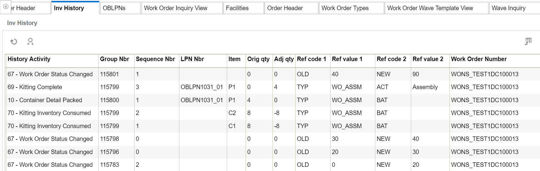

Inventory History
Inventory history records various WMS transactions taking place in the facility for purposes of informing the
ERP or any other external system that may be interested.
For more information about the Iventory History UI fields, see the Interface Specifications document.

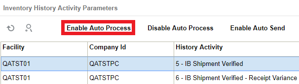

Enable/Disable Auto Process
To help customize your view of inventory history records, from the Inventory History Activity Parameters UI you can click the Enable Auto Process or Disable Auto Process buttons.
Once you click the Enable or Disable Auto Process buttons, a dialogue box appears asking for your password. Enter your password and click Submit.

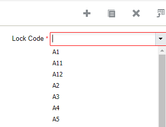

Configuring Lock Codes
Lock Codes must be added at the Parent company level.
- Make sure your current company view is at the Parent company.
- Go to the “Lock Codes” screen.
- Click the Create button.
- Populate the applicable fields/flags.
- Allocatable: If checked, LPNs with this lock code are still eligible for order allocation.
- Unlock on locate to Reserve: If checked, LPNs with this lock code will have this lock code removed whenever it is located to a Reserve location (a location that does not have a lock code).
- Click “Save”.

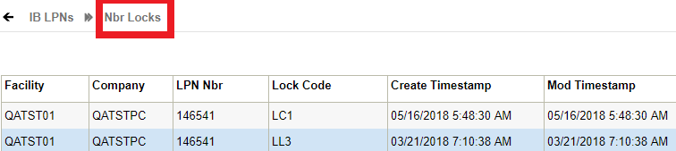

Adding Lock Codes to LPNs
You can add specific Lock Codes to an IBLPN by clicking the blue number value in the “Nbr Locks” column:
This will prompt a new window, where you can add multiple lock codes to the container:
The above figure shows all the Lock Codes currently added to the container. Click Create () and select one of the configured Lock Codes from the drop-down to add lock codes.

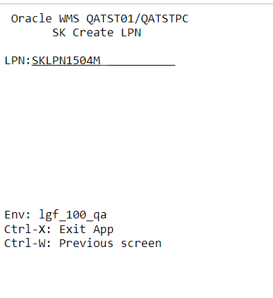

RF Create IBLPN
Before you begin to assign an inbound load to an outbound, create an LPN as shown in the following steps:
Steps:
- Login to the WMS RF through your credentials.
- Create an LPN for the order. To do that, select the Create LPN transaction. After invoking, create a new LPN and enter the LPN number. For example: LPN: SKLPN1504M.
- The RF screen takes you to the next screen where you need to enter following information:
- LPN: Enter the LPN Number.
- Items: Enter the items that you created through the items UI.
- Qty: Enter the quantity.
- You can also check the LPN status in the IBLPN UI. Go to the IBLPN UI > Search for the LPN number > the status displays as “Received” when items are successfully consumed.
- After consuming all the items, press Ctrl-X to exit from the current page.

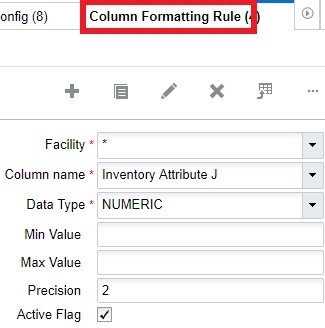

Configuring Formatting Rules
From the Column Formatting Rule UI, you can create formatting rules for inventory attributes:
From the Column Formatting Rule UI, you can define numeric data types and set minimum to maximum values to associate with inventory attributes a to o. You can also define the decimal precision for numeric inventory attribute values.
Note: you can’t enter decimal values for Min/Max fields above the defined precision. Also, you can’t save multiple formatting rules for the same inventory attribute column. The system will throw an error message in this case.
To create a formatting rule:
- From the Column Formatting Rule UI, click create.
- Select the Facility or * to apply the rule to all Facilities.
- Set the min/max value and precision.
- Select the Active Flag to enable the rule and click Save.
The following table provides descriptions for each of the configurable fields in the Column Formatting Rule UI:

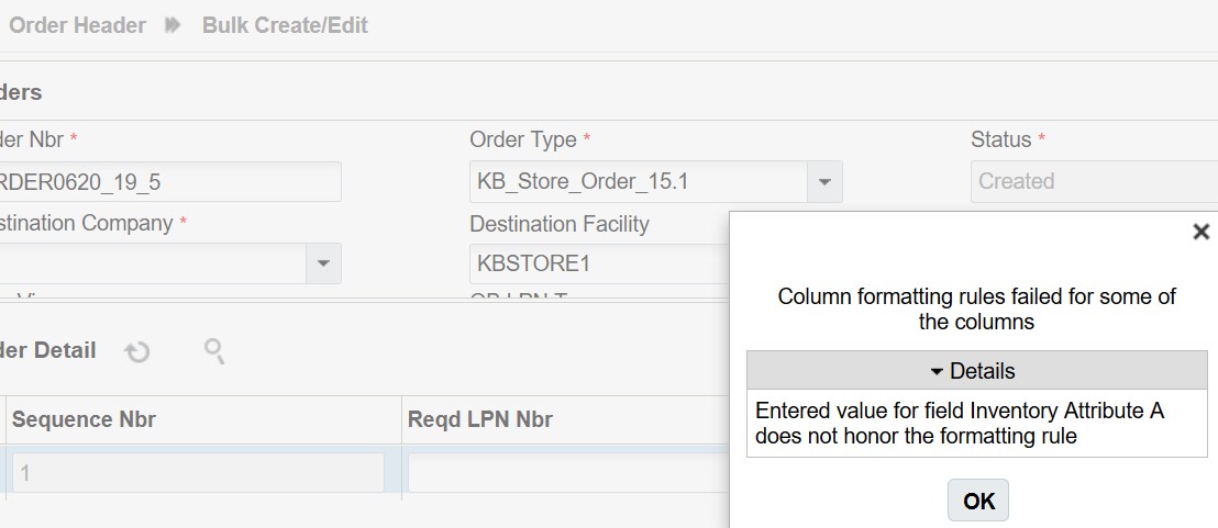

Inventory attribute formatting rules are triggered when you click Save after creating/editing the record.

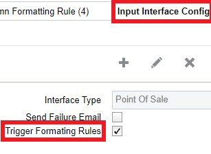

In the Input interface Configuration UI, you can enable trigger formatting rules for Input Interface screens via the Trigger Formatting Rules flag. This flag defaults to no. Input Interface validation will be triggered only if the corresponding interface being run has the trigger_formatting_rules flag enabled.
To enable trigger formatting rules for Input Interface screens:
- From the Input interface Configuration UI, select the interface type for which you want to enable trigger formatting rules.
- Click Edit.
- Select the Trigger Formatting Rules checkbox and click Save.

- When the user performs one of the above operations, if any of the attributes fail the validations, the system will send a response that includes the attribute which failed the validation.

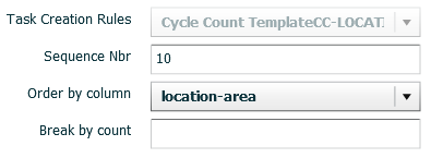

Ordering Criteria in CC Task Templates are used to configure the order in which CC Tasks are displayed in the RF task list.
- Go to the Task Creation Template screen, select the template and click on ‘Details’.
- Select the Task Type record and click “Ordering Criteria”.
- This takes you to a new window with all the ‘ordering’ rules for the task type. Click Create to add a new record.
- Input the necessary info for the ordering criteria record:
Sequence Nbr: The sequence number for the ordering criteria record.
Order by column: The criteria used for ordering the tasks.
Break by count: Leave this field blank (only applicable for non-CC Tasks).
- Press “Save” to create the record.

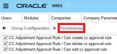

Permissions
From the Group Configuration UI, click Permissions to view the available permissions for Cycle Count Adjustment Rule and to set group permissions.

LPN is in "Consumed or "Shipped Status
- When you scan an LPN in “Consumed” or “Shipped” status in the Cycle Count operation, the system gives you an error message that the LPN is in invalid status.
- Finding “Consumed” and “Shipped” status LPNs in the reserve reflects poor inventory management.
- For the “Consumed” and “Shipped” LPN inventory, you must create a new LPN, using Create LPN RF option for the physical inventory in the location. DO NOT FORGET TO PUTAWAY.

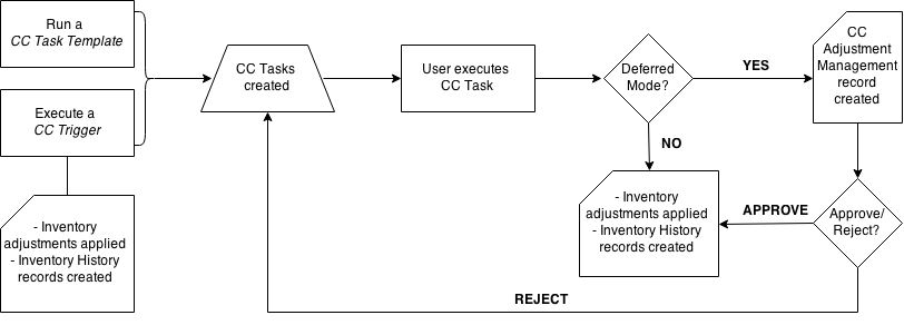

Cycle Count Inventory Updates
Deferred vs Immediate Mode
Oracle WMS Cloud allows you to approve/reject inventory adjustments before any real changes are made to warehouse inventory. This process, called the “Deferred Mode”, is enabled at both the Facility and Company levels.
Refer to the following diagram for a high-level process flow of the Deferred Mode:
To enable Deferred Mode for your facility, set the Facility and Company parameters “INVN_ADJUSTMENT_APPROVAL_REQUIRED” to “YES”. If this parameter is set to “NO” at either the facility or company level, the “Immediate Mode” (default) will be enabled – in this mode, Cycle Count inventory adjustments are applied immediately. Note that in 3PL environments, this parameter must be set to “YES” at the child company level. Below are the possible configurations:
| PARAMETER CONFIGURATION | RESULTING BEHAVIOR | ||
| Facility Parameter ‘INVN_ADJUSTMENT_APPROVAL_REQUIRED’ | Company Parameter‘INVN_ADJUSTMENT_APPROVAL_REQUIRED’ | Write record in ‘Inventory Adjustments Management’ screen? | Inventory Adjustments Mode |
| NO | NO | NO | Immediate |
| NO | YES | NO | Immediate |
| YES | NO | NO | Immediate |
| YES | YES | YES | Deferred |
In the Deferred Mode, WMS keeps track of all Cycle Counts in the Cycle Count Adjustment screen.

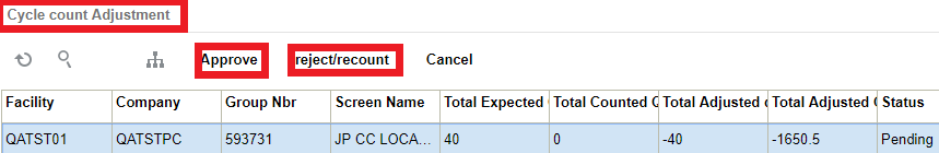

Approving and Rejecting Adjustments in Deferred Mode
The Deferred Mode allows supervisors to approve/reject inventory adjustments made by users who have previously Cycle Counted locations.
To approve/reject records, make sure it is in “Pending” status and click the “Approve” or “Reject/Recount” buttons.
Approving a record applies the inventory adjustments by adding/subtracting inventory from the locations as well as posting records in the Inventory History screen (referenced by the Group Number).
Rejecting a record will cancel the inventory adjustment and trigger a new CC task so that the location is re-counted.

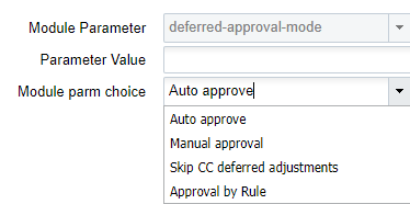

Deferred Approval Mode set up in RF Cycle Count Transactions
Previously, when performing a Cycle Count with RF Cycle Count Location or RF Cycle Count IBLPN, you would use the screen parameter “auto-approve-mode (update 18C).” This screen parameter is now called “deferred-approval-mode.”
The deferred_approval_mode parameter makes it easy for you to distinguish the approval modes available while you are performing cycle counting operations.
From Modules, select Cycle Count Location or Cycle Count IBLPN, then Screens, and Screen Parameters to view and select your module parameter choice.
The available settings for the Deferred-Approval-Mode screen parameter are defined in the following table:
| Mode | Definition |
| Manual Approve | When "deferred-approval-mode" is set with Manual Approve, "RF Cycle Count Locn/IBLPN" writes the count information in the CC Deferred Adjustment UI and will leave the information for the supervisor to approve or cancel the count if supervisor is logged in with company and facility combination and mode is configured with deferred mode. |
| Auto Approve | When "deferred-approval-mode" is set with Auto Approve, RF Cycle Count Locn/IBLPN" writes the count information in the CC Deferred Adjustment UI and will get Auto Approved after passing through all the validations if user is logged in with a company and facility combination and mode is configured with deferred mode. |
| Skip CC Deferred Adjustment |
| Approval by Rule |

View Lot (batch) Numbers
Lot (batch) numbers are maintained at the LPN level therefore, LPN screens are used to view the lot (batch) number.
- To view lot (batch) number associated with IB LPNs navigate to the ‘IB LPN’ UI screen.
- Using the 'Search' button, you can filter by a specific lot (batch) number in order to find all IB LPNs that are associated to the lot (batch) number.
- To view the lot (batch) number associated with the OB LPNs navigate to the ‘OB LPN’ UI screen.
- Using the ‘Search’ button, you can filter by a specific lot (batch) number in order to find all OB LPNs that are associated to the lot (batch) number.

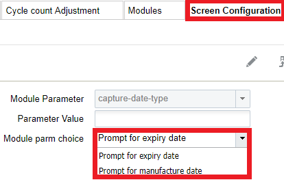

In order to receive items with expiry dates, the receiving RF module must have the Expiry Date validation enabled.
- Go to the “Screen Configurations” screen.
- Select the receiving RF module that will have expiry date tracking enabled.
- Click on Details to access its parameters.
- Modify the “capture-date-type” parameter to “Prompt for expiry date.”

WMS supports the ability to lock a lot (batch) number in the event that a recall has been initiated.
- To apply a lock to a lot (batch) number, go to the ‘Batch Management’ screen.
- Using the search button, filter for the lot (batch) that requires a lock.
- Select the applicable record, and click the ‘Edit’ button.
- Select the applicable lock code from the drop-down menu, and click the ‘Save’ button.

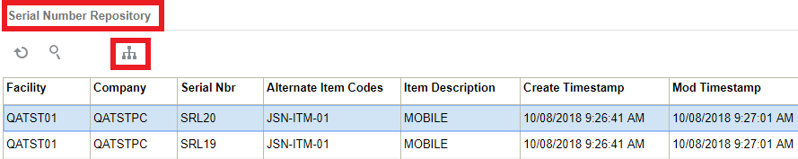

Serial Number Repository View
This screen displays all Serial Numbers for all items in the current facility.
You can also drill down to the serial number record’s details () to view the inventory associated to it:
If the serial number is associated to inventory, the detailed view indicates the LPN’s status (Located, Allocated, Packed, and so on).

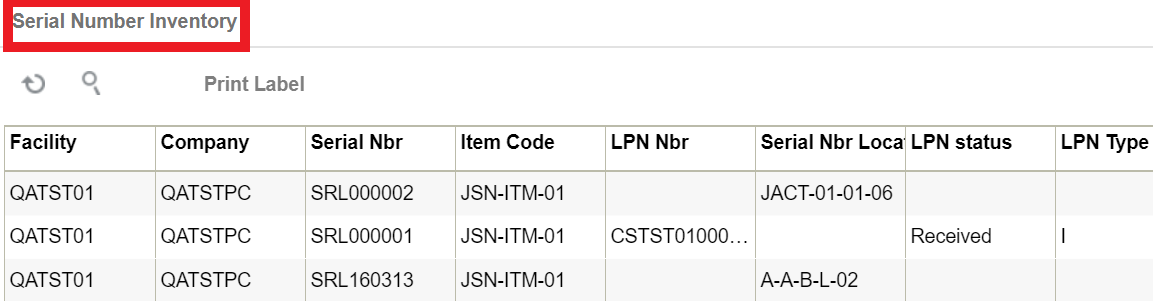

Serial Number Inventory View
This screen displays a ‘flattened’ view of Serial Numbers and their associated inventory records (ex. LPNs) in a single record.

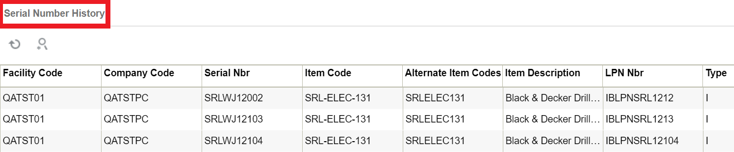

Serial Number History View
This screen displays all the “serial number – inventory” association changes in the system. For example, there can be a serial number record for an LPN of type “I” (Inbound) and another for LPN of type “O” (Outbound).

- Go to the Input Interfaces screen.
- Select IB Shipment Serial Nbr from the drop-down, upload the interface file, and click “Run Interface”.
- If everything was done correctly, the system prompts the message “Status: Interface Completed”. From the the Serial Number Repository screen, click OK and verify that the serial numbers were successfully uploaded.

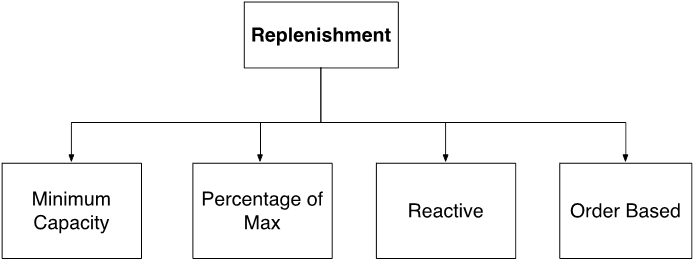

Oracle WMS Cloud supports four replenishment modes:
Each replenishment type has different criteria for when the replenishment wave is triggered:
- Minimum Capacity: Triggered when a location’s current quantity goes below the required minimum quantity.
- Percentage of Max: Triggered when the volume of items in the location goes below the location’s pre-configured percentage of maximum volume.
- Reactive: Triggered when you manually scan a location to be replenished.
- Order Based: Triggered when an order’s SKU needs to be replenished in the picking locations.

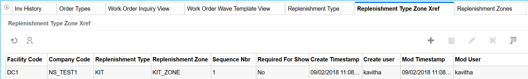

- Go to the “Replenishment Zone” screen.
- Define the different replenishment zones for the warehouse using the Create button.
- Once the replenishment zones are created, go to the “Locations” screen.
- Choose a location to replenish to by assigning it a replenishment zone. To do this, select the location and click Edit.
- Scroll down to the “Replenishment Zone” field and select the appropriate zone from the drop-down.

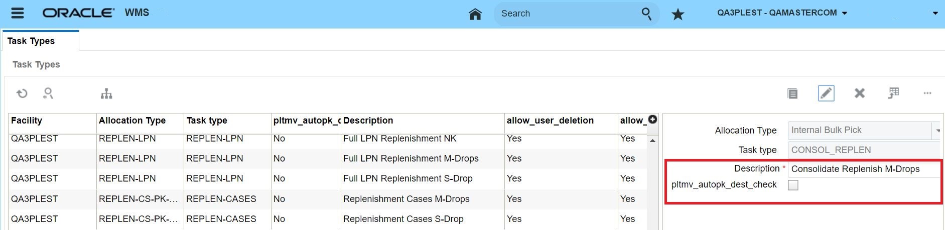

Step 3: Setting up Task Templates
- Go to the “Task Creation Template” screen.
- Click “Create” () to create a new Task Template.
- Select this template and click on Details () to view its details.
- Click “Create” () to create the appropriate task types and their ordering/selection criteria.

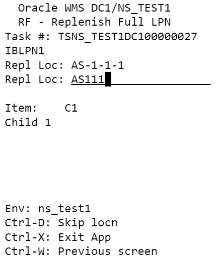

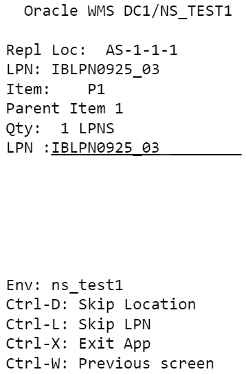

- For LPN replenishment, select “Full LPN Replenishment”.
- For Cases replenishment, select “Cases Replenishment”.
- For Units replenishment, select “Consolidate Replenish”.
- Click Save

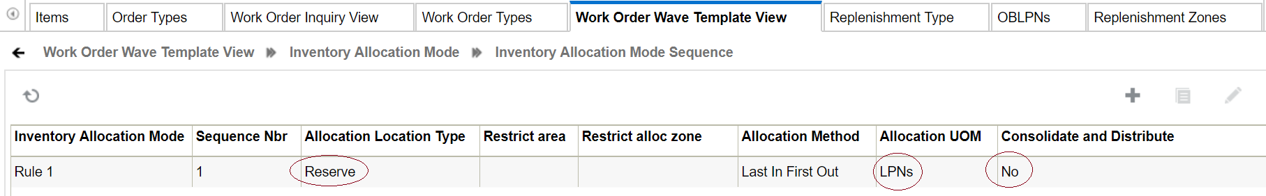

- Replenishment Rule: allows you to select which rule to use for the current template.
- Sequence Nbr: Sequence for creating task types, if there are more than one within the template.
- Location Type: Locations in WMS represent storage locations in the warehouse. Locations have different types depending on how they are used within the warehouse.
- Restrict area: populating this field tells WMS to exclusively look at the populated area to replenish from.
- Restrict alloc zone: populating this field tells WMS to exclusively look at the populated allocation zone (which was defined earlier) to replenish from.
- Allocation Method: defines the order in which LPNs are selected for replenishment.
- Replenishment UOM: defines the UOM that is allocated for replenishment.
Note: Units replenishment only works for Active locations.
- Consolidate and Distribute Replen: if this flag is checked, WMS allocates replenishment from multiple locations. This flag only works with Unit and Cases replenishment.
- Round Up One Uom: The Round Up One UOM flag allows you to replenish beyond the need by one extra UOM (LPNs/cases/packs) for all of the eligible locations. When the Round Up One UOM flag is configured in the Replenishment Rule Header, the system replenishes by one extra UOM compared to the outstanding need of the location (see example below). When the Round Up one UOM flag is combined with the Ignore Capacity for Last Permanent Location Flag, the required need is replenished to the destination location when the replenishment UOM is LPNs/cases/packs. If the Ignore Capacity for Last Permanent Location Flag is set to no and the Round Up one UOM flag is enabled, then the destination location is replenished by one extra UOM when the need is not an integral multiple of the LPN/case/pack quantity.

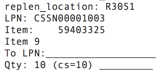

Once you enter the task, the RF prompts you for pallet and LPN numbers. This pallet is the intermediate pallet that transports the merchandise into the final replenishment location.
If there is no more room for more LPNs in the pallet, you can “End” the pallet by pressing Ctrl-E. Ending a pallet with pending picks causes the system to create a new replenishment Task for the remaining picks.
- Once all the LPNs from the picking location are moved to the pallet, the RF prompts the destination location (the location to replenish to). You must scan the location barcode when they arrive to the location:
- Once the location barcode is scanned, the RF will ask you to scan the “To LPN” (the destination pallet). This is the LPN that is replenished. In the “Qty:” field, you must enter the amount of cases being moved.
Note: for the “Qty: 10 (cs=10)”, the first 10 represents the number of cases to move, while the second “10” value (“cs=10”) represents the standard case quantity of the item. - Once the contents are moved, the remaining contents in the LPN must be returned to a reserve location. The following is an example of the reserve location field.

Scenario 2: Full LPN Replenishment, No Distribution
For this scenario, the you must make sure that both the Task Template and the Replenishment Rule have cases configured.
- Once you enter the task, the RF prompts for pallet and LPN numbers. This pallet is the intermediate pallet that transports the merchandise into the final replenishment location.
Note: If there are multiple LPNs to be picked, the RF prompts for another LPN. If there is no more room for more LPNs in the pallet, you can “End” the pallet by pressing Ctrl-E. Ending a pallet with pending picks will cause the system to create a new replenishment Task for the remaining picks.
- Once all the LPNs from the picking location are moved to the pallet, the RF prompts the destination location (the location to replenish to). You must scan the location barcode when the pallet arrives to the location.
- Once the location barcode is scanned, the RF will ask you to scan the LPNs in the pallet to replenish with. The “Qty:” field denotes how many LPNs there are to replenish.
- If there are no LPNs remaining, the RF displays a message saying “No more tasks”. Press Ctrl-A to proceed.

- Configure the relevant Task Type for replenishment
- Configure the Task Zone Movement and define the movement of inventory from one location to another. Define the Task Zone Movement Rule.

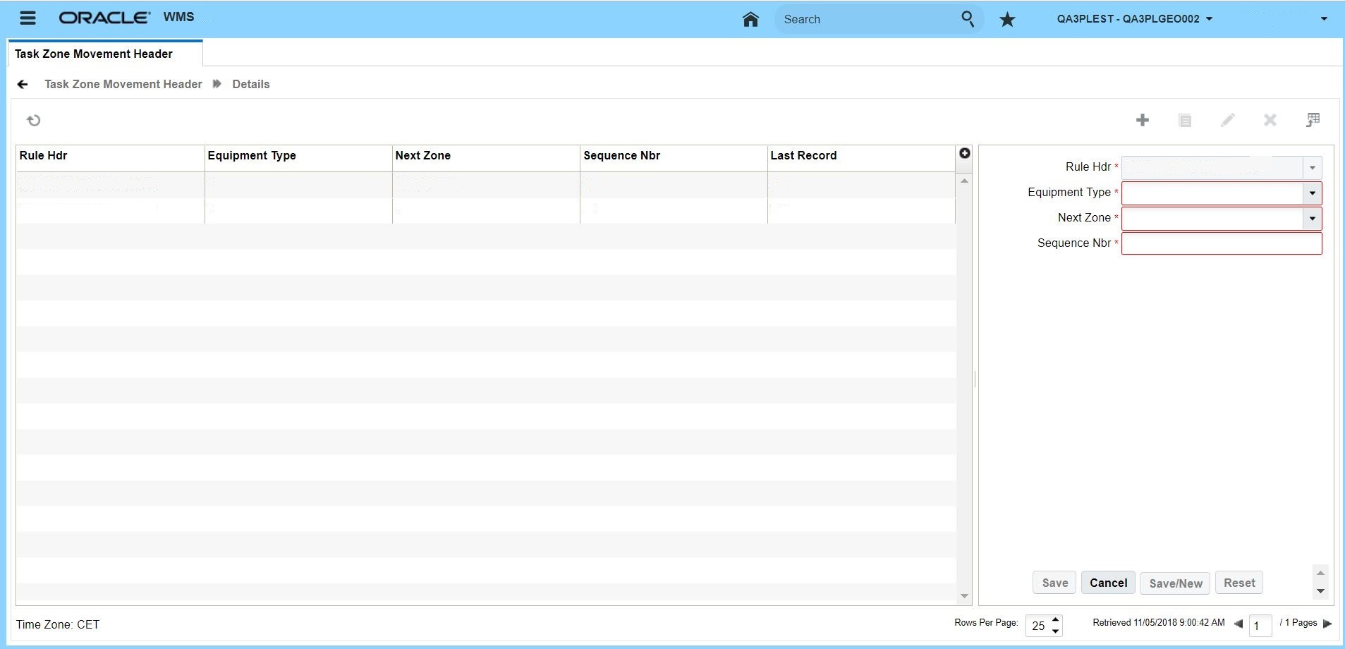

Task Zone Movement
- Source to Final Destination – one task zone movement is created with * baring the end zone.
- Drop zones to Final Destination – Distinct task zone movement should be created with the relevant path.
Define the task zone rule for every task zone movement by entering the mandatory information in the field as shown in the screen below:
Task Creation Template is a set of instructions given to the user to perform tasks to satisfy the need. The task creation template is defined by configuring the following parameter:
- Create a Task Creation template. Define template. For example, Type > Select Regular.
- Define the Sequence Number.
- Define the Task Type in the Task Creation template.
Task Type

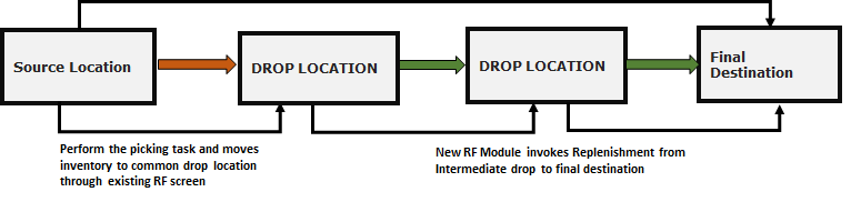

A new RF module, "rf.inbound.cwrfmultistepreplen" allows you to move inventory from one drop location to another and then to a final destination location.
The following diagram describes how this new RF module is used:
The following are some of the characteristics of the new RF Module:
- Scan the inventory from the source location and the system inferred the task zone.
- Determine the final destination zone of the inventory by scanning the task type that defines the unique task zone.
Note: Task type can be inferred from screen parameter or user can manually enter into the system.
- On obtaining the source and destination zone, the system determines the following:
- If the source location has inventory to satisfy the need/demand of supply in destination location.
- Once inventory is available in the source destination location, the system prioritizes which location to replenish first based on the following filter:
- If the filter criteria is set to current quantity <= minimum, then system considers inventory from the source location which are destined to pick locations having current inventory less than or equal to locations configured minimum. If multiple locations are found, the system will order the locations in ascending order of putaway sequence.
- After determining the source and destination, the system prompts you to pick the relevant quantity of inventory in the temporary tote and deliver to intermediate drop locations and then to final destinations.

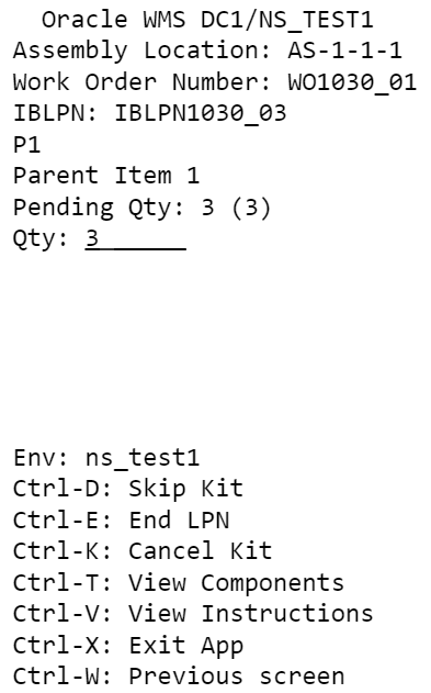

Kitting
Kitting is the process of assembling child items to create a parent item or a kit. The ratio of child items required to create a parent item is called pre-pack ratio and pre-defined in WMS. De-Kitting is the process of dis-assembling parent items or kits into child items. In order to assemble or dis-assemble parent items, Work Orders are required. The assembly or dis-assembly of parent items takes place in assembly locations.
There are two types of kitting flows in WMS - Make To Stock and Make To Order.
Make to Stock – The main objective of Make to Stock flow is that, the parent items or kits are assembled beforehand and putaway to stock in anticipation of future Outbound Order for the parent items. In this flow, a Work Order is either interfaced into WMS or created from Work Order view. After parent items are assembled using this Work Order, WMS prompts you to pack the parent items into Inbound LPNs. The Inbound LPNs are then putaway to stock (reserve locations). These parent items can be picked later against outbound orders, packed, loaded and shipped out like any regular item.
Make to Order – The main objective of Make to Order flow is for the parent items or kits to be shipped out based on the Outbound Order sent to the facility. In this flow, a Work Order is automatically created in WMS when an Outbound Order with a specific Order Type is interfaced into WMS. The Work Order has a reference to the Outbound Order. So when the parent items are assembled using this Work Order, Oracle WMS Cloud prompts you to pack the assembled parent items directly into Outbound LPNs against the Outbound Order. The OBLPNs can then be loaded and shipped out like any other OBLPN.
- Parent Items are also called Kit Items
- Child Items are also called Component Items

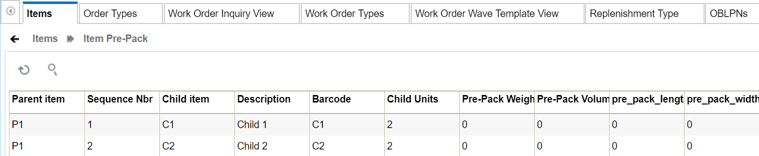

- Ratio of child items required to create a parent item is called pre-pack ratio
Configure Kitting Process
- From the Replenishment Type UI, create a Replenishment Type for kitting.
- Create a Replenishment Zone for kitting.
- Tie the Replenishment Type with the Replenishment Zone.
- Parent and child items need to be pre-defined along with the pre-pack ratio.
- Parent items need to have a Replenishment Type defined in the item facility. On the Item UI, select the parent item that needs to be assembled and hit the facility button.
In Item Facility view for the parent item, add a new record and select the Replenishment Type that was created in step 1.
- Create an assembly location where the parent items will be assembled. This location needs to be a dynamic active location with the assembly flag checked and with the Replenishment Zone the same as the one created in step 2.
Note: Since this replenishment zone ( KIT_ZONE) has been tied to the replenishment type ( KIT) and the replenishment type is configured on parent item P1, this would mean that whenever parent item P1 needs to be built, the child items for P1 will always be replenished to assembly location AS111. Similarly, different parent items can be configured to be assembled in different assembly locations.

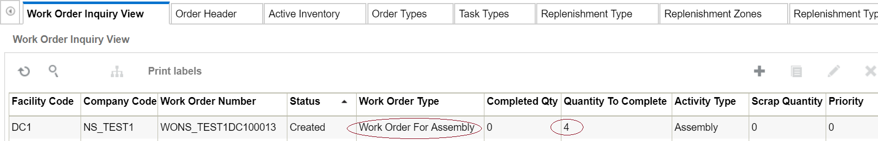

The Work Order Type described in Configure Kitting Process is used on the Work Order. This automatically sets the Activity Type to Assembly on the Work Order. The Work Order is initially in a Created status.

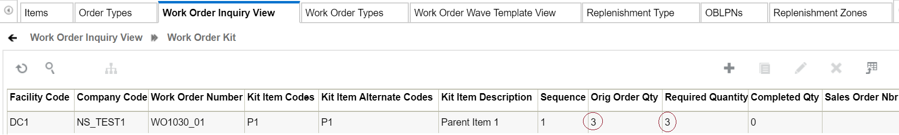

This Work Order has been interfaced (or created) to assemble three units for parent item P1.

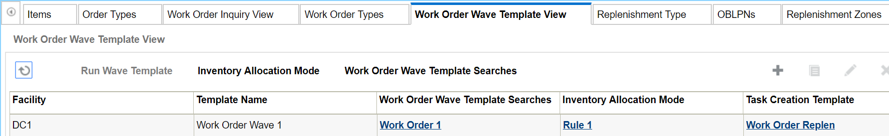

Work Order Wave Template
Create a Work Order Wave Template. This template will define rules to pull child items from reserve/active locations and replenish to an assembly location.
The Work Order Template Search needs to have the right criteria to select the required Work Order.
WMS offers multiple replenishment options. In this example, the rule is defined to pull full LPNs (with child items) from reserve locations.
…and a corresponding Task Template to create Full LPN Replenishment tasks.

Task Execution
Execute the tasks in order to replenish the assembly location with child units from reserve locations.
- Pick IBLPNs containing child items from reserve locations and place on a pallet.
- Move and Replenish contents of the LPNs to the assembly location

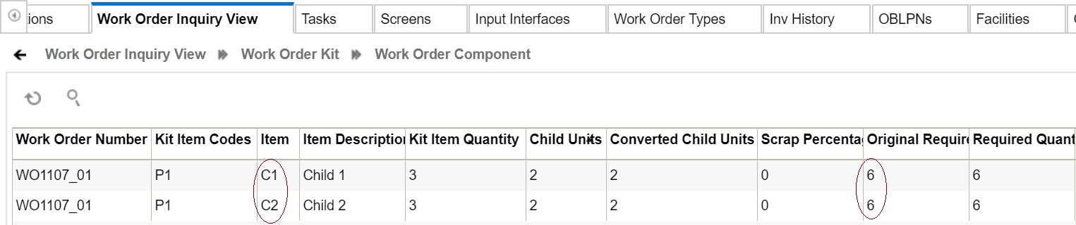

The assembly location now has enough units of child items (C1 and C2) to build 3 units of parent item (P1). From the Work Order Inquiry View UI, the Work Order is now in Picked status:

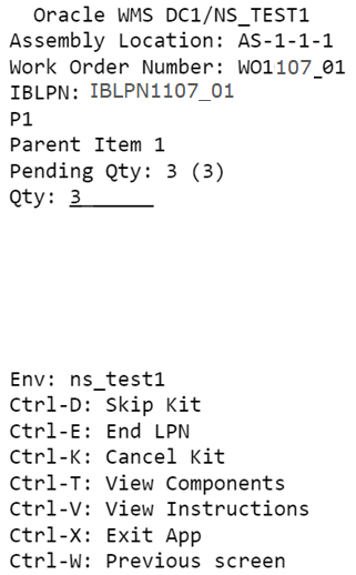

Kit Assembly
Now that the child items are in the assembly location, assembly of parent items can start using RF Work Order Kit Processing. All units of the assembled parent items can be placed in one IBLPN or multiple IBLPNs. In this example, all three units have been placed in one IBLPN.
RF Work Order Kit Process offers other Ctrl options for processing Work Orders. For example you can use Ctrl-V to view extra instructions if there are any available for the kit being handled. You can use Ctrl-T to view the ratio of the child items that are required to assemble the parent items.
From the IBLPN screen, the Inbound LPN with the assembled parent items displays in Received status, and can be putaway to a reserve location. You will see in the Work Order Inquiry View, that the work order is completed.
From the Inventory History screen, you can see the Inventory History for the work order.

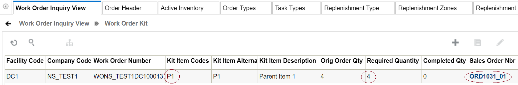

In the Make to Order Flow, a Work Order is automatically created in WMS when an Outbound Order with a specific Order Type is interfaced into WMS.
Work Order Creation
Create an Order Type for the Outbound Order. This Order Type needs to have the Work Order Type populated which is described in step 7 in the Configure Kitting Process section.
When an Outbound Order with such an Order Type is interfaced into WMS, a Work Order is automatically created behind the scenes.
Interfaced Order Header and Detail
Interfaced Work Order Detail
The Work Order Type on the Work Order is set based on the Work Order Type which is on the Order Type of the Outbound Order.
The Work Order Kit has a reference to the original Outbound Order Nbr.

The following screen shows you the inventory history for the Work Order:

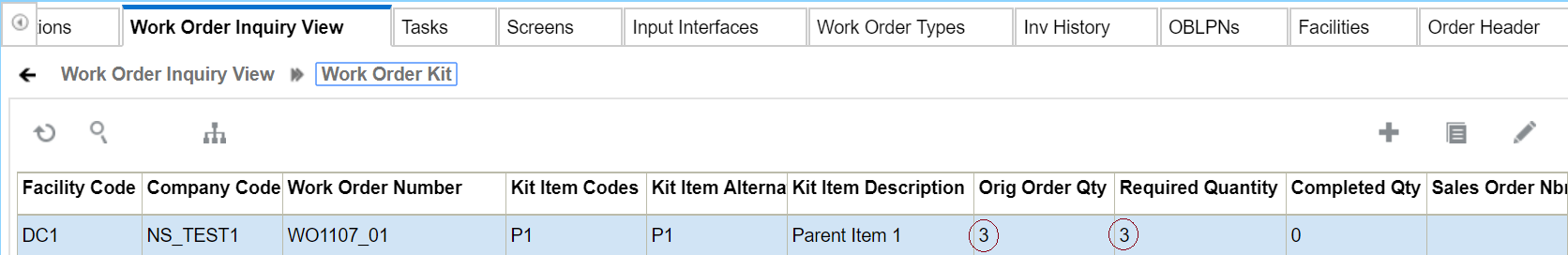

This Work Order has been interfaced to dis-assemble three units of parent item P1.
Since the pre-pack ratio for P1 is defined as two units of C1 and two units of C2 for one unit of P1, dis-assembling three units of P1 will result in six units of child item C1 and six units of child item C2.

Ensure that there is enough inventory for parent P1 in the facility. In this example, there is one LPN in a reserve location with three units of P1.
The same Wave Template that was described under Make to Stock flow can be used, ensuring that the Wave Search criteria is modified to pull the new Work Order. When the wave is run, it allocates one LPN from reserve which has three units of P1.
A task is created to move the LPN from a reserve location to an assembly location.
Task Execution
Execute the task to replenish the assembly location with parent units from the reserve location.
- Pick IBLPN containing parent items from reserve location and place on a pallet.
- Move and Replenish contents of the IBLPN to the assembly location.
The assembly location now has three units of parent item P1.

Dis-Assembling the Kit
Now that the parent items are in the assembly location, dis-assembly of parent items can start using RF Work Order Kit Processing. After dis-assembling, child units for all parent items can be placed in a single IBLPN or placed separately in different IBLPNs. In this example, all three units of C1 and all three units of C2 have been placed in a single IBLPN.
The Inbound LPNs with child items C1 and C2 are in Received status and can later be putaway to a reserve location or items replenished to an active location.
