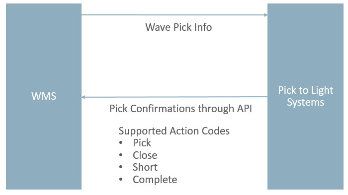

This flow diagram illustrates the Wave Pick Information being sent to the Pick to Light System and the Pick to Light System generating and API call to WMS as picks are confirmed. WMS then performs the pick and pack updates:
Pick to Light Wave Pick Info
Send Picking and Packing information to MHE

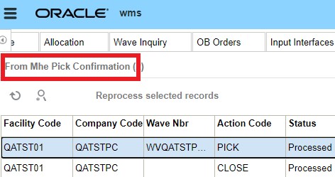

Pick Confirmation Messages
From the From MHE Pick Confirmation UI, you can see the pick confirmation messages flowing in to WMS and track MHE picking:

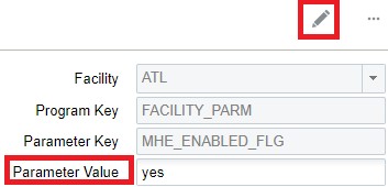

You need to complete the following configuration steps in Oracle WMS Cloud for MHE to work:

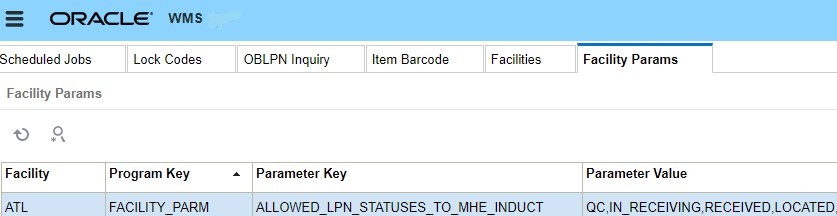

Facility Parameters
  1. Search for the parameter key MHE_ENABLED_FLG.
  2. Click Edit, and set the Parameter Value to Yes.
MHE Enabled Flag
  • For the facility parameter ALLOWED_LPN_STATUSES_TO_MHE_INDUCT set up the value with all of the LPN statuses that are used in MHE.
Allowed statuses include the following:
QC,IN_RECEIVING,RECEIVED,LOCATED,RESERVED,PARTLY_ALLOCATED,ALLOCATED,OUTBOUND_READY,IN_PICKING,PICKED,IN_PACKING,PACKED,LOADED,CONSUMED,SHIPPED,DELIVERED,LOST,CANCELLED
Facility Parameters

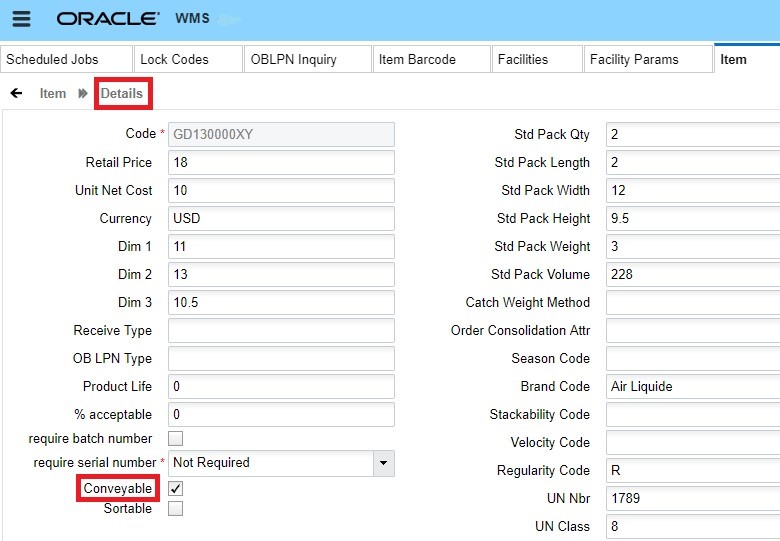

Items
Certain items must be configured in order to be accepted in MHE.
  1. From the Item Details UI, click Edit to set the Conveyable flag:
Conveyable Flag

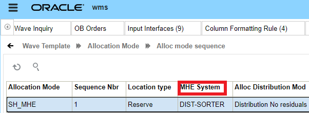

MHE in Wave’s Allocation Mode Sequence
When you are creating an allocation mode in the Wave Template, you need to input the MHE system needed for the allocation. If picking is happening from MHE, then the MHE system has to be populated on the allocation mode sequence.

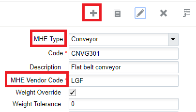

MHE System Configuration
  • From the MHE System screen, create a record with the MHE Type = Conveyor and MHE Vendor Code = LGF:
MHE Type
The MHE Logs action button will allow you to look at the logs for this system.

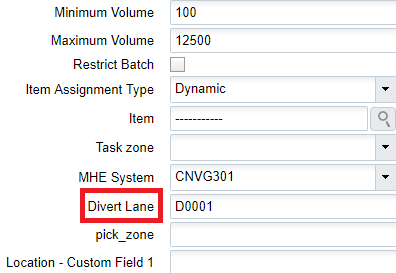

Location for Induction
From the Locations UI, configure a Divert lane with Reserve/Active (Putaway) and a Drop location:
Location UI - Divert Lane

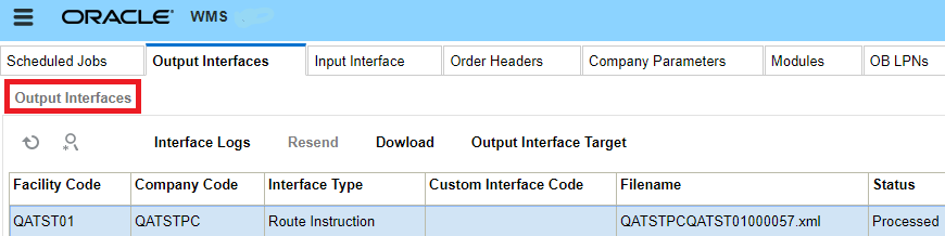

Route Instruction Configuration
You can manage and configure conveyor routing in Oracle WMS Cloud. You can configure routing for either LPNs that are received and are going to be put away or for picked LPNs that will go to staging lanes.
Inbound LPNs can invoke WMS’s robust putaway logic and divert the appropriate zone for putaway. If the MHE system determines the putaway location, the divert confirmation can inform Oracle WMS Cloud with the final location where the MHE located the LPN.
For outbound LPNs, the flow is similar. Based on the destination, Oracle WMS Cloud can instruct the sorter which lane to divert the container to. If the logic is in the MHE, then upon divert, a confirmation can be sent informing Oracle WMS Cloud of the lane and staging location that was used for the container.
MHE Routing Flow
The following steps outline the flow of MHE from Induction of the LPN (RF or API) to the Route Confirmation Message:
  1. Induction of LPN (RF or API)
  2. Route Instruction for Rule firing (pre-configured rules)
  3. Genration of Route Instruction Message (sent to MHE’s control system)
  4. Generation of triggered output files (if configured in the rule)
  5. LPN Inventory Info/OBLPN Shipping Info is sent to specified targets
  6. Route Confirmation Message (from MHE’s control system)

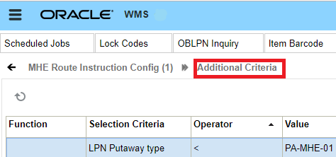

Filter LPN Selection Criteria
Click Additional Criteria to mention criteria in the details (not mandatory). This allows you to filter the IBLPNs:
Additional Criteria

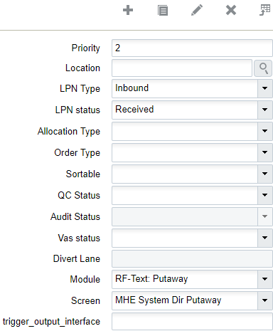

Configure calling Directed Putaway
  1. To configure Directed Putaway with MHE:From the MHE Route Instruction Configuration UI, create a new Route Instruction rule or select an existing Route Instruction rule.
  2. Once you have selected LPN Type and LPN Status, from the Module drop-down, select RF Text: Putaway.
  3. From the Screen drop-down, select the applicable Putaway screen.
  4. Click Save.

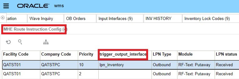

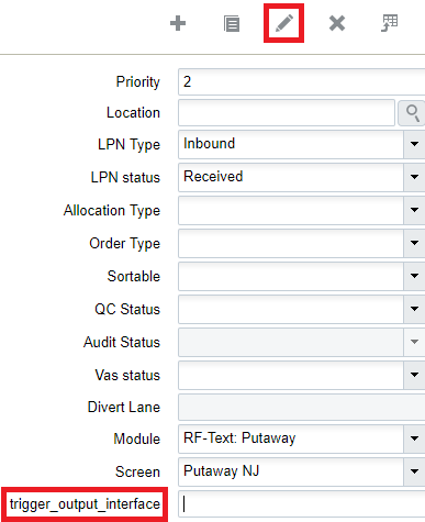

Generate LPN Inventory or OBLPN Shipping Information Message
You can generate LPN Inventory and OBLPN Shipping information from the MHE Route Instruction Configuration UI. This feature allows customers to send information to the MHE system.
For example, the MHE system can take this information and use it to print a shipping label. If the Outbound LPN is subject to Route Instruction check, after user perform induction via RF or API, the system will check the configuration and generate the LPN_INVENTORY message or the OBLPN_SHIPPING_INFO.
From the MHE Route Instruction Configuration screen – update the trigger_output_interface field with either LPN_INVENTORY message or the OBLPN_SHIPPING_INFO

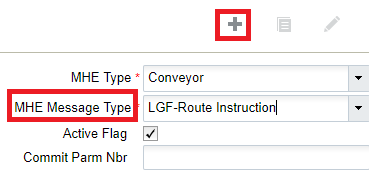

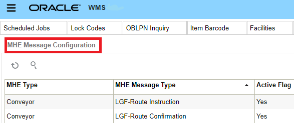

Message Configuration
There are various types of MHE Message types you can configure from the MHE Message Confirmation UI.
  1. In order to setup MHE message configuration for Route Instruction, go to the MHE Message Configuration UI.
  2. From the MHE Message Type drop-down, select “LGF-Route Instruction”.
  3. Click Save.
    MHE Message Type
  1. Next, to setup MHE message configuration for Route Confirmation, go to the MHE Message Configuration UI.
  2. Set up MHE message configuration with the MHE message type “LGF-Route Confirmation” for Route Instruction output file generation:

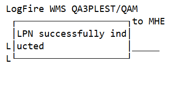

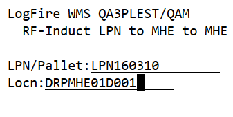

Example of How to Invoke RF Induct LPN
In Oracle WMS Cloud, users can implement several levels of MHE sophistication. In some cases, the automation is a hybrid of man power and machine power, with operators manually initiating the induction instead of initiating with sensors. Oracle WMS Cloud allows these processes to be mobile through the RF, indicating the induction into an MHE system.
The following is an example of how to invoke the RF Induct LPN and scan the received LPN and Drop location to divert. Alternatively, you can use the Induct REST API:
First, scan the LPN:
Scan the LPN
The drop location “LPN successfully inducted” message displays:

The Route Instruction output file is generated in the Output Interfaces screen:
Output File Generated
File content:
CNVG301|QA3PLEST|QA3PLGEO002|LPN160310|D001|RES-01-MHE-001|RES01MHE001
