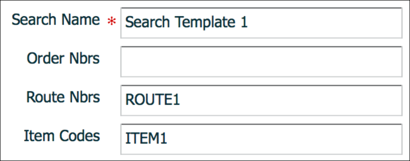

Examples:
In example 1, “Search Template 1” will filter all orders with route number “ROUTE1” and that only contain SKU “ITEM1”.

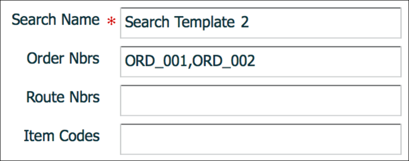

In example 2, “Search Template 2” will filter orders that have order numbers “ORD_001” and “ORD_002”. In other words, Wave Templates with this search template selected will only attempt to allocate these two orders.

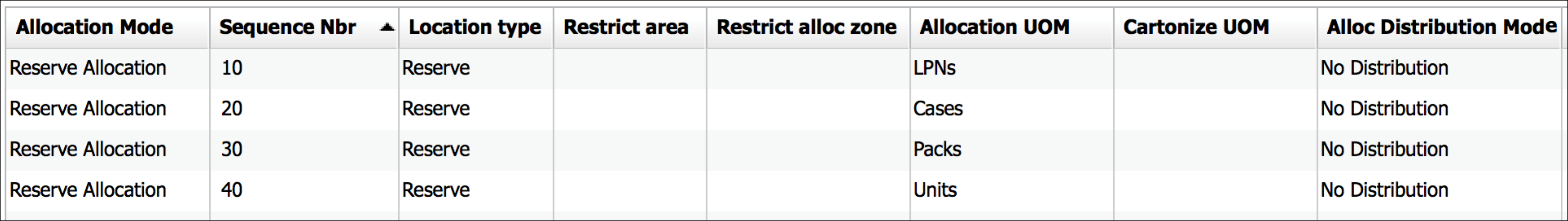

- Create a new Allocation Mode with the Create button.
- Enter its details with the Details button.
- Create the sequence of allocation UOMs desired for the Wave Template. See example below.

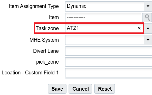

To add a Task Zone to a location:
- Go to the Task Zone screen and create a new Task Zone.
- Go to the Locations screen, select the desired location and click edit.
- In the “Task Zone” field, select the Task Zone that you added in step 1.
For example, if there is a Drop Zone location “DZ1” with Destination Zone “ATZ1”, there will be the following Task Template configuration:
This means that at the end of every “Reserve Units” Task, you are prompted to move the picked LPNs into a “DOOR_DROP” location – which in this case is location “DZ1”.

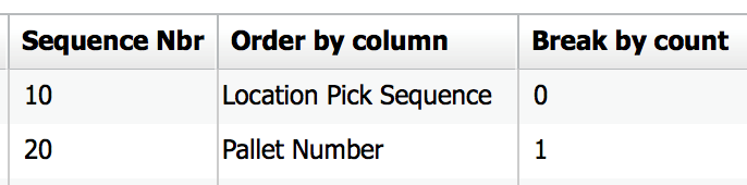

Example:
screen
- Location Pick Sequence, Break by count = 0
This will sort the creation of Tasks in order of the allocation’s Location Pick Sequence.
- Pallet Number, Break by count = 1
This will create a new Task for every Pallet that is allocated. This may be used in cases where the picking equipment does not allow users to pick multiple pallets at a time.
