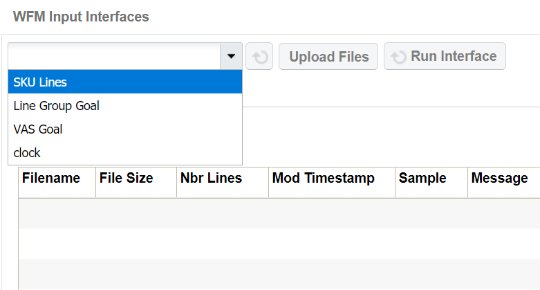

SKU Lines, user clock information, goals for system and VAS activities can also be interfaced in bulk using the input interfaces view in WFM.
The drop-down in input interfaces view supports the following options:
SKU Lines: To upload SKU Lines
Line Group Goal: To upload goals for system activities
VAS Goal: To upload goals for VAS activities
Clock: To upload user clock information generated from an external system

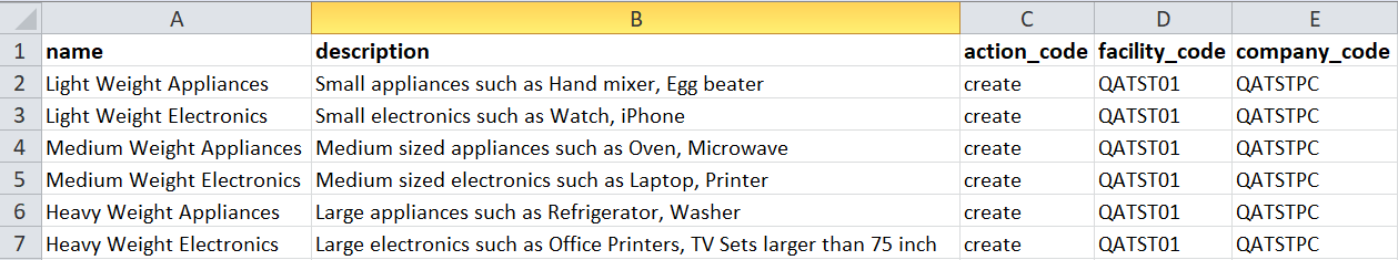

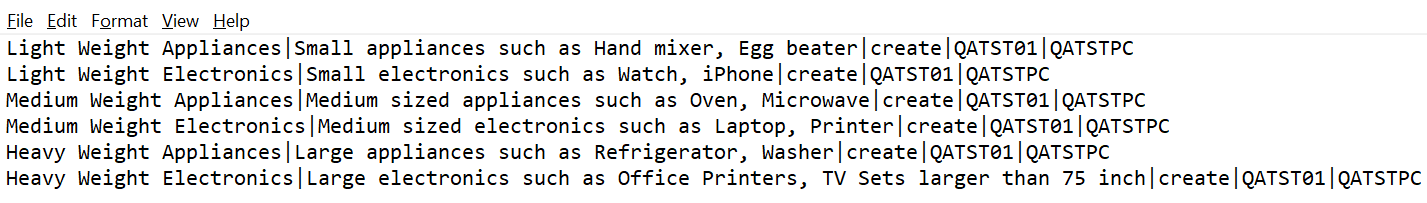

WFM supports XLS, CSV, and flat file formats. For more details about the fields and data types in each interface, refer to the WFM Interface File Formats document.
Example of a sku_line File in all Three Formats
XLS/CSV format
Flat File format (pipe delimited)

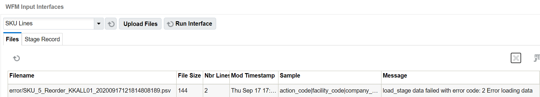

As a first step, the interface checks for the format of the data in the file. If there are errors in the file structure, the filename is prefixed with error and the relevant error message appears in the “Message” field.

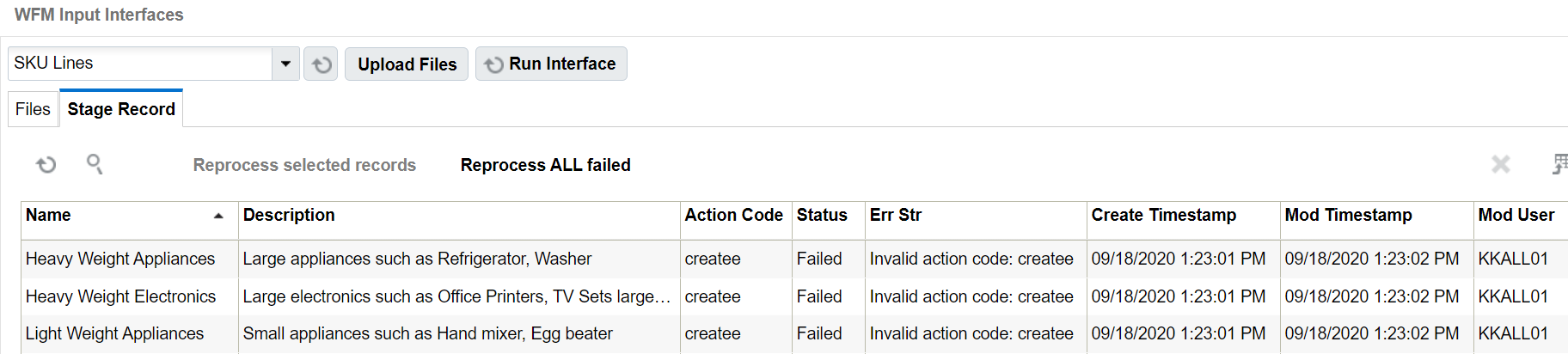

However if data format is fine, data in the file goes through next step of validations. At this point, data is moved from Files tab to Stage Record tab. Individual fields are now checked to see if they are valid. For example, in a sku_line record if action_code is something other than create or delete, the record is marked as “Failed” and remains in Stage Record tab. The Err Str column displays relevant error message.
Reprocessing Failed Records
If the error is configuration related, for example, if a clock record fails because of invalid work area, then such a work area can be configured in WFM. After configuring the work area, the failed record is selected in Stage Record tab and “Reprocess selected records” button is selected. If configurations related to all failed records are taken care of, then you could select the button “Reprocess ALL failed” without selecting any record.
