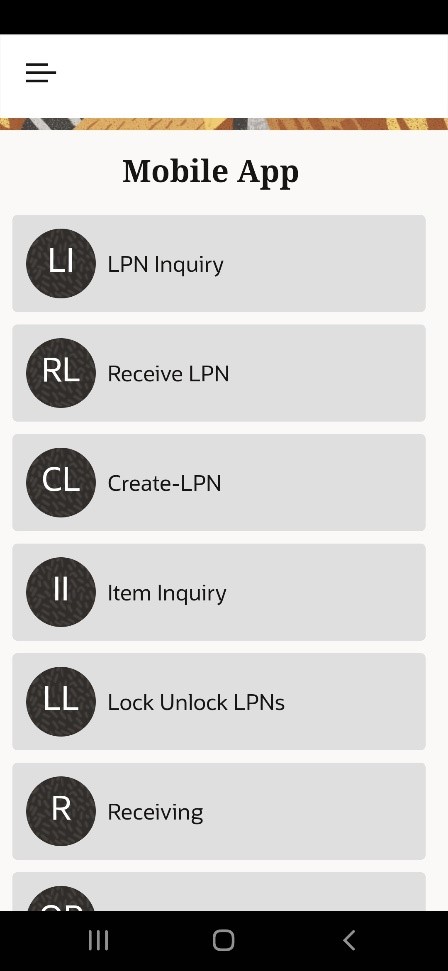

After successful login, the mobile application will display list of screens added to the user's default group.
Menu Screen
The application displays following module in the order you add the screens from the UI:
  • Create IBLPN
  • Lock Unclock LPNs
  • Item Inquiry
  • LPN Inquiry
  • Order Picking
  • Receive LPN
  • Ship OBLPN

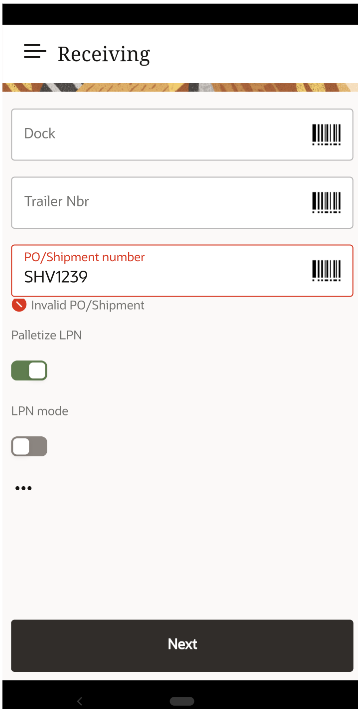

  2. Enter the PO/Shipment number.
    In order to find if the entered number is a PO or Shipment Number, the system will first look at the PO table and serach for a matching number whose status is < than Received. Else, it will look into the Shipment table and search for a matching number whose status is < than Receiving Complete.
    1. If an invalid PO or Shipment number is entered, the system displays an Invalid PO/Shipment error message. For example,
      Invalid PO Number

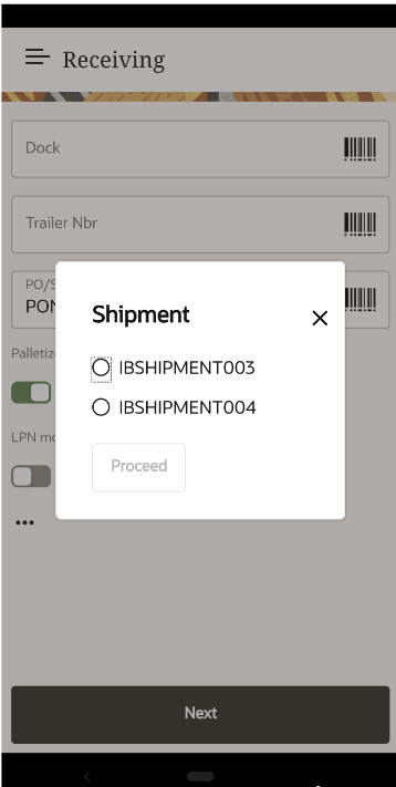

    2. If a value is available in the PO table, and the PO is related to multiple shipments, then a pop-up is displayed for you to provid with the Shipments linked to the PO. It will only show Shipments that are in status less than receiving completed. On selecting the shipment value, the system will start the receiving process for this IB Shipment.
      Inbound Shipment

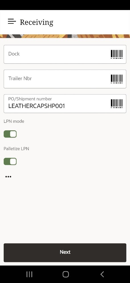

LPN Mode Receiving

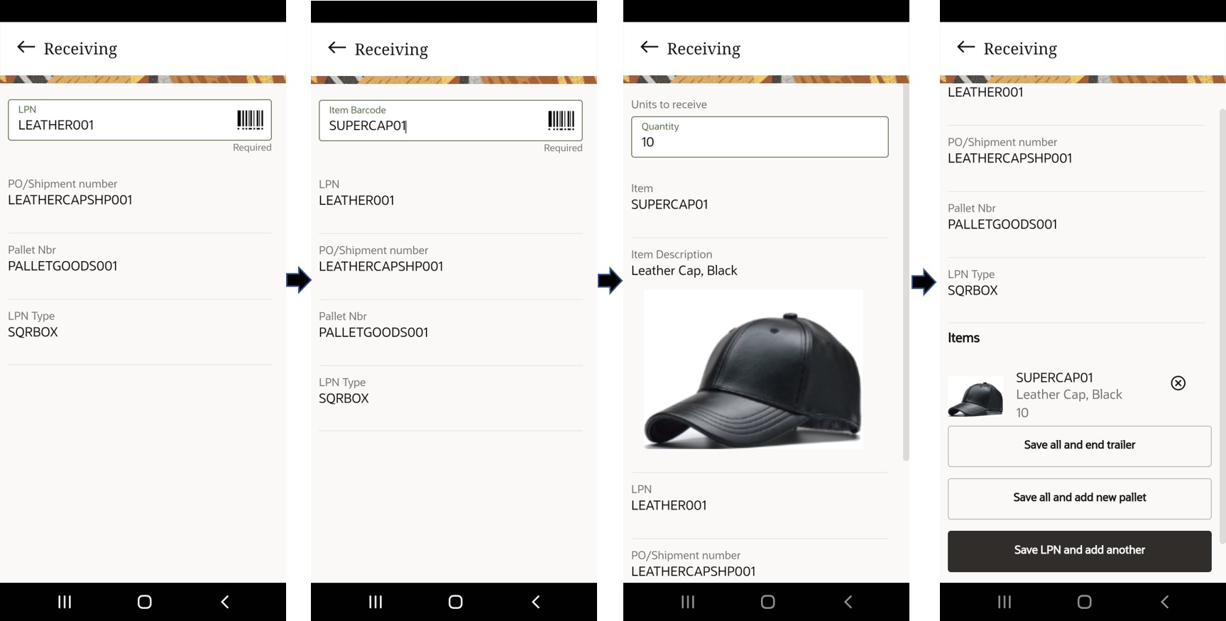

  1. If Palletize LPN toggle and LPN Mode toggle is enabled. The system prompts for the pallet number in the next screen.
    Receiving in LPN Mode
  2. Click Next.

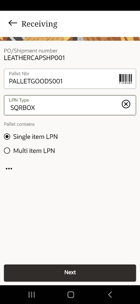

  3. Enter the Pallet number in the Pallet Nbr field.
  4. Select the type from the list of values in the LPN type drop-down field.
  5. Choose the Pallet contains type:
    1. Single item LPN: Supports receiving of single item LPNs.
      Single Item LPN
      1. Click Next.

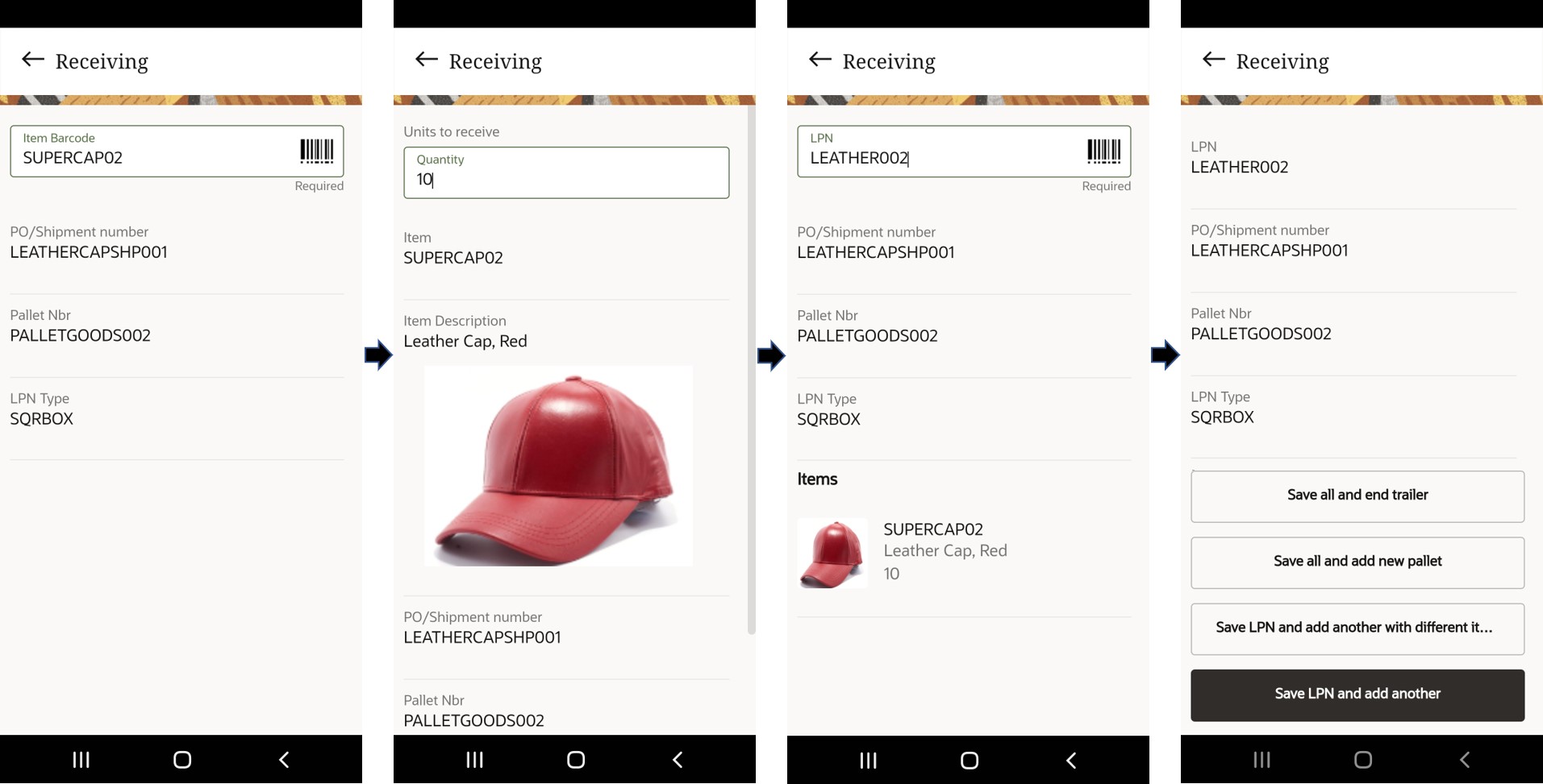

      2. Enter the LPN number in the LPN field > Enter the item Barcode in the Item Barcode field > Enter the quantity in the Units to receive > Quantity field.
        After successful receiving, the summary screen is displayed with the following options:
        Table Summary Screen
        Options Description
        Save all and end trailer Saves all the records, ends the trailer, and the app routes you back to the main Receiving screen to scan a new shipment.
        Save all and add new pallet
        Saves all the LPN records and ends the current pallet. You can use this option to add the remaining SKU from the same shipment but on a new Pallet. The screen flow returns back to Pallet screen where you scan a new pallet number.
        Note: Enter a different LPN number for the new pallet.
        Save LPN and add another Save the current LPN and add the same or different SKU from the same pallet but on a different LPN. The screen flow returns back to the LPN screen where you can scan a new LPN for the same pallet.

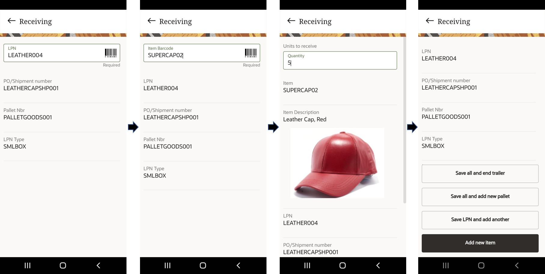

      2. Enter the LPN number in the LPN field > Enter the item Barcode in the Item Barcode field > Enter the quantity in the Units to receive > Quantity field.Multi-item transaction
      Options Description
      Add new item This option is visible only if you receive multiple items by selecting Multi-item LPNs radio button Pallet screen. On tapping this option, the application takes you back to scanning the item barcode screen.

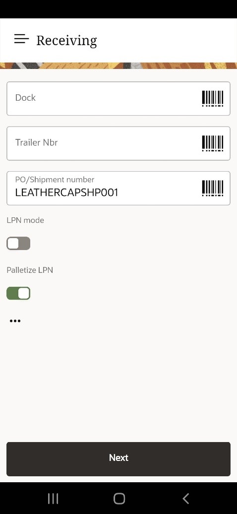

SKU Mode Receiving
This is a great mode if you receive LPNs that contain the same inventory multiple times. In this mode, you are prompted to first scan the SKU, quantity, and then the LPN number. You can continue to scan the LPN at once, unless you need to change another set of inventory or LPN containing different SKU.
The following shows the flow for receive a shipment in SKU mode:
  1. From the Receiving screen, enter the PO/Shipment number.
  2. If Palletize LPN toggle = enabled and LPN Mode = disabled. The system prompts for the pallet number in the next screen.
    SKU Mode
  3. Click Next.
  4. Enter the pallet number in the Pallet Nbr field > choose the pallet contains > Click Next.
  5. Enter the item Barcode in the Item Barcode field > Enter the quantity in Units to receive > Quantity field > Enter the LPN number in the LPN field.
    SKU mode transaction

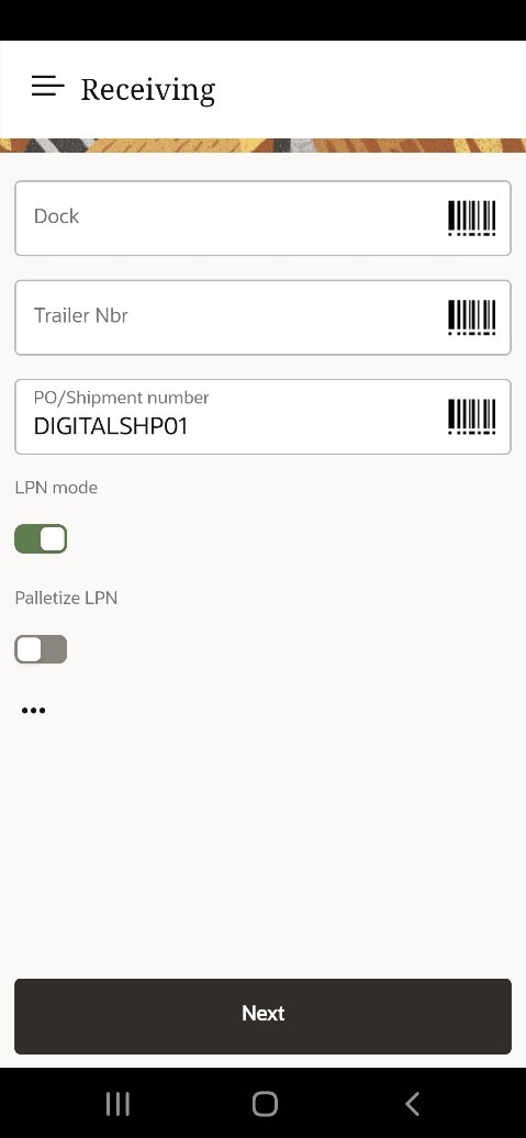

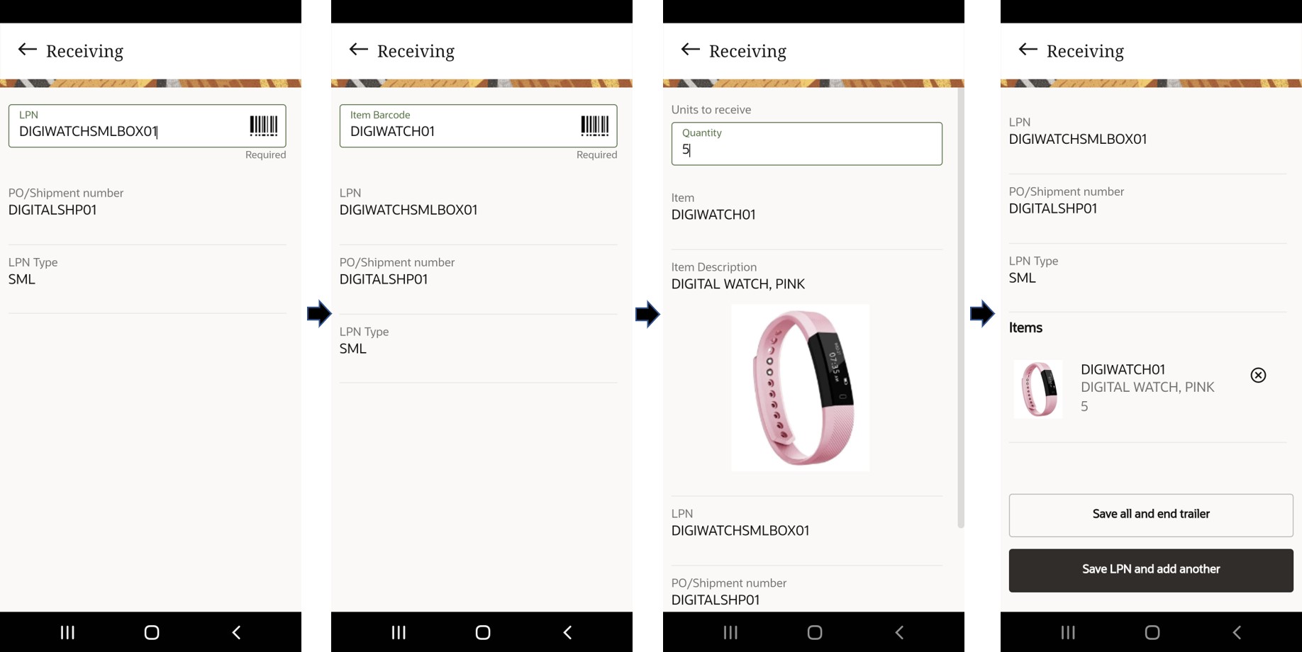

Receiving LPN or SKU without Palletize mode
The following depicts the flow of receiving for a non-palletized shipment:
  1. From the Receiving screen, enter the PO/Shipment number. If Palletize LPN = disabled and LPN Mode = disabled/enabled, the application prompts you to LPN type screen.
    Non-Palletize mode
  2. Click Next.
  3. Choose the LPN type from the list of available LPN type description > Click Save.
  4. Enter the LPN number in the LPN field > Enter the item barcode from the Item Barcode field > Enter the quantity in the Units to receive > Quantity field.
    Non-Palletize transaction
    After successful receiving, the summary screen is displayed with following options:
    Table Non-Palletize Mode Summary Options
    Options Description
