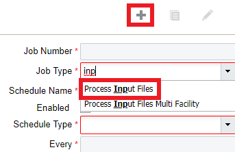

- To run the Process Input File:- Go to the Scheduled Jobs screen, click Create (+).
- Select Process Input Files from the Job Type drop-down and populate all remaining Mandatory fields. Refer to Mandatory Field section for description.
