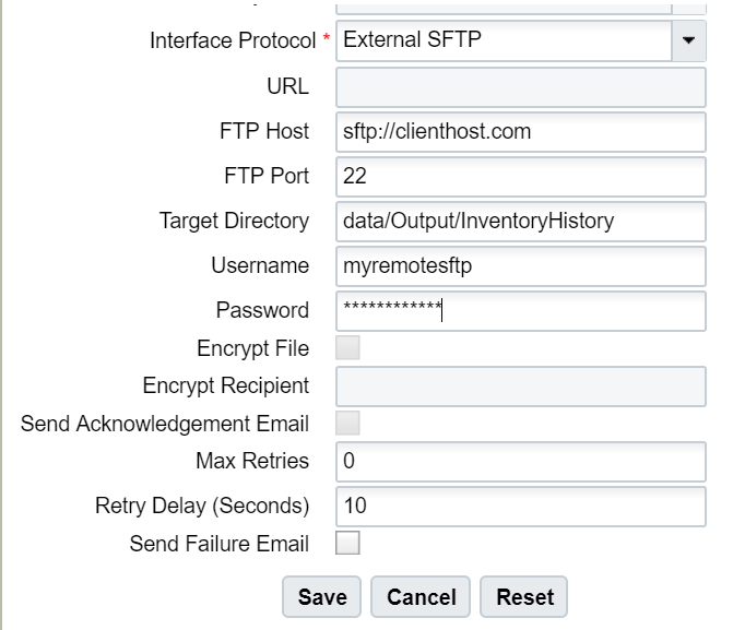

RECOMMENDED CHANGE: As of 9.0.0, Output Interface Configuration allows these files to be sent directly to external SFTP sites (instead of the internal LogFire SFTP) and that is the recommended way over using “SFTP PUT files” as it will skip the internal file transfer step and improve the overall processing speed. For example, if you currently have output interface configuration setup with “Logfire internal sftp” or “Logfire internal file location” as the target, these files get created in that location which is accessible via your LogFire SFTP username and password. You have the option to leave it that way and use the SFTP PUT files job to transfer the file to your external site, but you can skip this step and instead configure the output interface to use “External SFTP” and directly send the file out.
If you use SFTP to extract Web reports, then you will need to use SFTP PUT files.
Local Directory
External SFTP

Example: You have configured your Inventory History file to be drop in a specific target directory using Output Interface Configuration.
As you will not be able to get direct access to the Local SFTP folder, you will have to configure this SFTP Get Schedule Job, so Oracle WMS Cloud can drop the file to your assigned folder.
