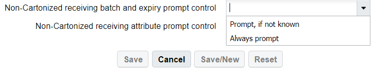

- Go to IbShipmentTypeView screen and Create button.
- Enter the shipment details and populate the desired prompt control:
- Non-Cartonized receiving batch & expiry prompt control: Blank (Default behavior)/ Prompt, if not known/Always prompt.
- Non-Cartonized receiving attribute prompt control: Blank (Default
behavior)/ Prompt, if not known/Always prompt.Note:
- Click Save.Note: When Non-Cartonized Receiving for Batch number & Expiry Number /Attribute prompt control is set to Prompt, if known or Always prompt, the system does not honor any of the item property configurations for batch/expiry dates/ inventory attribute.

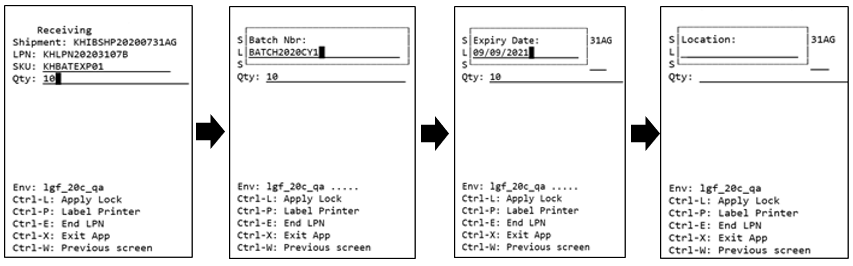

Example: Prompt for batch/expiry date for single SKU for non-cartonized shipment at Item level configuration

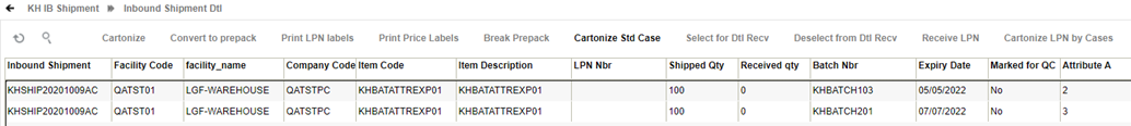

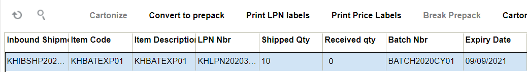

Let’s say, you have the following ASN to be received:
When Non-Cartonized receiving batch/expiry date prompt control = Prompt, if not know:
When Non-Cartonized receiving batch/expiry date prompt control= Always prompt

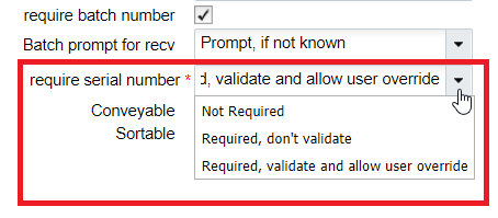

- Go to Item UI > Details. Click Edit.
- Enable the “required serial number” drop-down at item’s level configuration with values:

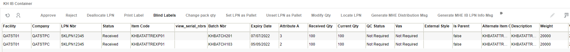

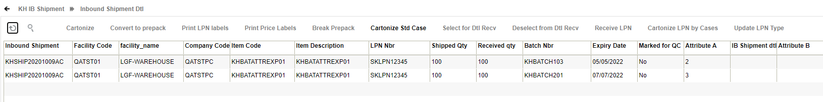

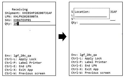

Let’s say you have the following ASN configured:

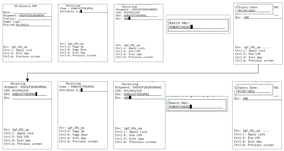

The system scans through the SKU 1 (attribute, batch and expiry) and without ending the LPN, the system loops through remaining SKUs with the same hierarchy.
Upon scanning all the SKUs in the LPN and performing CTRL+E, the system receives the SKUS
and updates the shipments details in the following manner:
