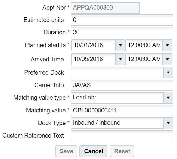

- Go to the “Appointment” screen.
- Click the Create button and populate the necessary fields. Description of fields: Description of fields:- Appt Nbr: Appointment Number
- Estimated units: The estimated units in the ASN.
- Duration: Estimated time taken to receive. There is no time measurement here, so it is up to the user to decide whether to use it in minutes or hours.
- Planned start ts: The Planned start date (and time, if specified).
- Arrived Time: The date and time in which the trailer actually arrived to the warehouse.
- Preferred Dock: The preferred Dock for receiving (not functional).
- Carrier Info: The trailer’s carrier information.
- Matching value type: The preferred field used for matching the ASN with the Appointment.
- Matching value: The value for field specified in the previous field.Dock Type: The dock type that will be used for receiving.
- Click “Save”.

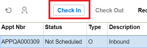

- Once the Appointment is created, you can check-in the Appointment by selecting the
                record, choosing a Dock Door from the drop-down and clicking “Check In”.

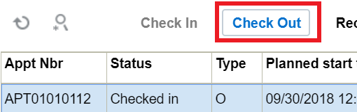

- When all the ASNs have been fully received, do not forget to check the Appointment
                out of the Dock Door from step 4. Go to the “Appointment” screen and click “Check
                        Out”.
