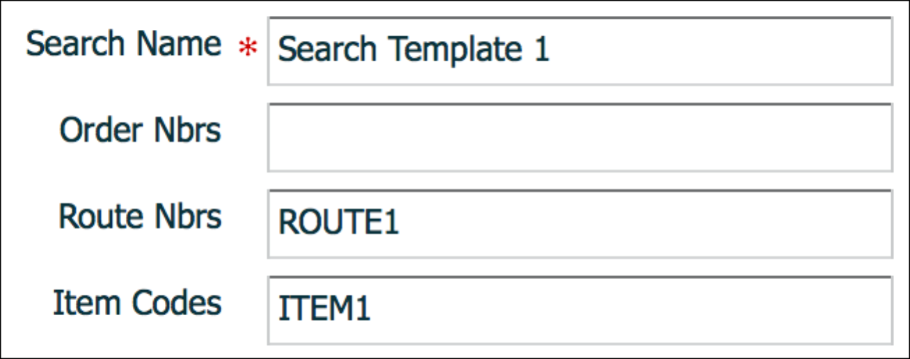

creating wave templates example 1
In example 1, “Search Template 1” will filter all orders with route number “ROUTE1” and that only contain SKU “ITEM1”.

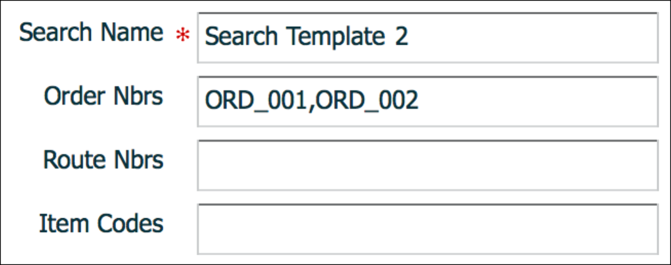

creating wave templates example 2
In example 2, “Search Template 2” will filter orders that have order numbers “ORD_001” and “ORD_002”. In other words, Wave Templates with this search template selected will only attempt to allocate these two orders.

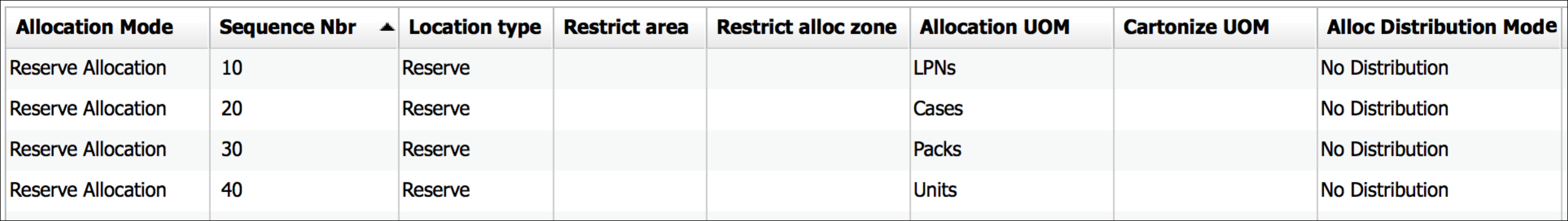

Step 2: Create an Allocation Mode
Allocation Modes are used to define how the inventory should be allocated in terms of the different allocation UOMs.
In the Wave Template screen, click on the “Allocation Mode” button – this will take you to the list of Allocation Modes available for the current company.
Note: Make sure you are at the correct company view before proceeding).
  1. Create a new Allocation Mode with the Create button.
  2. Enter its details with the Details button.
  3. Create the sequence of allocation UOMs desired for the Wave Template. See example below.
Sample Allocation Mode Configuration
Note: Allocation modes are only editable in the company view in which they were created. For example, if an allocation mode was created at the PARENT company view, the user must activate to the PARENT company to be able to edit it.
Extra Configuration Parameters
  • Sequence Nbr: The order in which the system will look for allocations.
  • Location Type: The locations that will be used for allocation – Reserve or Active.
  • Restrict Area: If populated, the WMS will search for allocations in this area only.
  • Restrict Alloc Zone: If populated, the WMS will search for allocations in this allocation zone only.
  • Cartonize UOM: If populated, the WMS will automatically create a new carton per UOM defined.
    • Example: If Cartonize UOM = Units, the system will create a new carton number for every unit allocated in the wave.
  • Alloc Distribution Mode: This field is used to enable/disable the distribution (Put to Store) functionality. If using distribution, you must choose one of the following parameters:
    • Distribution Residuals OK: This is the first distribution option that is used in distribute to store. The “Residuals OK” implies that when allocating orders to available LPNs in the inventory, the system allows LPNs to be partially allocated and have unallocated units left over (ie. ‘residuals’). Depending on the order quantity and the available inventory, this allocation type can allocate both LPNs and units. Distribution Residuals OK only allows you to select units, packs, or cases from the Allocation UOM drop-down.
      Note: If you plan on allocating less than full LPNs from reserve, you must make sure the location flag "Allow reserve partial pick" is enabled. For more details, see Allow Reserve Partial Pick in the Location Master section.
      Note: The system is not currently handling the Allow reserve partial pick flag during replenishments.
    • Distribution No Residuals: This distribution mode will only allocate LPNs with no residuals. In other words, every time an LPN is allocated for distribution, all of its contents must be allocated to one or more orders (ie. LPNs cannot be “Partly Allocated”). Distribution No Residuals only allows you to pick units, packs, or cases from the Allocation UOM drop-down.
    • Consolidate and Distribute: This distribution mod allows you to pick allocation from Reserve or Active. Consolidate and Distribute only allows you to pick units, packs, or cases from the Allocation UOM drop-down.Note: This option allows you to pick inventories for multiple stores to a temporary LPN, place it in a consolidated location, and distribute inventories based on the stores.
      Note: The partial allocation flag (on the Order Type UI) is not honored and it will always have a default of yes.
    • No Distribution: No Distribution turns the distribution off, and it will create non-cubed picks based on the allocation UOM. This mod allows you to pick units, packs, cases, or LPNs from the allocation UOM drop-down.
      Note: Distribution Residuals OK, Distribution No Residuals, and Consolidate and Distribute do not allow the user to set the Allocation UOM as LPNs. If you try to save this setting, you will see the following error: “Alloc UOM LPN invalid for distribution modes”
    • mhe_sytem: Input the MHE system needed for this allocation, if configured. If picking is happening from MHE, then the MHE system has to be populated on the allocation mode sequence.
  • Ignore Attribute A, B, C to O: You can select one or multi-select relevant inventory attribute to ignore the inventory attributes in the Order Header. Even if the order has corresponding inventory attribute populated, ignoring the inventory attribute on allocation mode sequence will prevent the wave from honoring the order’s attribute.

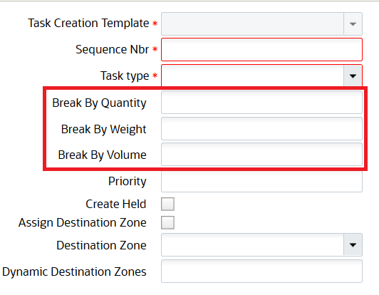

Task Creation Template Details
This section details the list of parameters you can define for your task creation template:
Fields Description
Task Creation Template Displays the task creation template
Sequence Nbr* Determines the sequence of each Task Type
Task Type* Select the task type from the drop-down
Break By Quantity Specify the break by value in Quantity. The user configured break by value will be considered for grouping the tasks based on the allocation mode and task template configured for the wave. Users can now break the tasks by configuring break by quantity value in task creation template.
Break By Weight Specify the break by value in Weights. Users can now break the tasks by configuring the break by weight value in the task creation template.
Break By Volume Specify the break by value in Volume. Users can now break the tasks by configuring the break by volume value in the task creation template.
Priority Determines the priority of the Task Type. The priority can override the record’s sequence number.
Create Held This flag determines whether the Task will be ‘held’ when created. When a Task is held, it will not be visible to the picking operator in the RF gun. The operator will only be able to view this task once the superuser ‘releases’ this task in the “Tasks” screen, via the “Release Task” button.
Assign Destination Zone
Enable this flag to configure the Dynamic Destination Zone.
Note: On enabling, the Destination Zone field will be disabled.
Destination Zone
When you reach the end of a Task, this configuration determines whether or not the RF will prompt you to move the picked boxes into a Destination Zone. Destination Zones are essentially locations that have Task Zones configured.
Additionally, the system checks if there is a matching Task zone movement configured with the Start and End zone (Start zone is based on pick location and end zone is based on the zone configured in "Destination Zone"). If a match is found, the picker can execute task zone movement after reaching end of their task.
You can specify multiple destination zones separated by comma.
This field checks the destination zone for pending tasks or uncancelled inventory. If the destination zone doesn't have any incomplete/uncancelled tasks nor uncancelled inventory, tasks for that task creation sequence will take the specified Destination Zone. Else, it will evaluate the next destination zone in the list.
For example, if Dynamic destination zones are configured with Dest01,Dest02,Dest03. Dest01 will be evaluated first, then Dest02, and finally Dest03 will be evaluated.
Note: If all the destination zones configured have pending tasks or inventory not in cancelled status, the tasks will not be created but allocations will be generated for the wave.
Break the Task via Break By Parameter
The allocations in a wave are added to a task until one of the value - quantity, weight, and volume mentioned in break by parameter has reached the value. Once the condition is satisfied, the system creates a new task for the next allocation in sequence and continues to verify the tasks are created for all allocations in a wave.
For example, If break by quantity is configured as 80, and there are three allocations in sequence with Qty: 50, 60 and 40, the first two allocations with Qty 50 and 60 are added to the first task and then the third allocation with Qty 40 is created as a second task.
Note: To configure the break by value, do the following:
  1. From the Task Creation template UI. Select the template and click details icon.
  2. The Details page opens > Click Create (+) icon.
    Break By Value
  3. Enter the break by values in the respective field. By default, these fields are set with value 0 or blank, and supports decimal values greater than or equal to zero”.
    Note: For Template Type = Regular, you can save the record by populating numeric values in the new fields. While creating, the entered "Break By Weight" & "Break By Volume" rounds-off based on the max weight, volume and dimension decimal precision value configured in Decimal settings for the user logged in company.
  4. Click Save.

Break by Quantity
Use Case - 1: If you have a allocation with allocated quantity 20 in task creation template. The Break By Quantity =10, and Break By Weight/Break By Volume = null/empty, the task is created as follows:
LPN Item Location Order Allocated Qty Task
LPN10 Item10 Loc10 Ord2 20 Task0005
Even though the allocated Qquantity is twice as that of Break by Quantity, the system creates only one task as the allocation cannot be broken further into multiple tasks.
Use Case - 2: If you have three allocations with allocated Qquantity as 4,4, and 3 and in task creation template, the Break By Quantity = 5, and Break By Weight/ Break By Volume = null/empty, the tasks is created as follows:
LPN11 Item11 Loc1 Ord3 4 Task0010
LPN21 Item11 Loc2 Ord3 4 Task0010
LPN31 Item11 Loc3 Ord3 3 Task0011
The Task0010 can accommodate only 5 units (break by Qty =5), but the first allocation does not exceed the break by value and on including the second allocation, the total quantity for task exceeds break by quantity. Because, the system does not split the allocation further, the second allocation is included in Task0010 and the total quantity in Task0010 = 8 (4+4).
Break by Weight and Volume
Example
LPN Item Quantity Weight Volume
LPN1 Item1 10 1000 10000
LPN2 Item1 10 1000 10000
When order (Order1) is for Item1, the Quantity = 20, and the above LPNs are available in the system. When you run the wave and the Break by Quantity is 20, both the allocations will be grouped into a single task because the break by condition is not satisfied:
Example
LPN Order Allocated Quantity Task
LPN1 Order1 10 Task00001
LPN2 Order1 10 Task00001
When the Break by Quantity is 20 and the Break by Weight is 1000, two separate tasks will be created for allocations because the Break by Weight is satisfied for both allocations:
Example
LPN Order Allocated Quantity Weight Task
LPN1 Order1 10 1000 Task00002
LPN2 Order2 10 1000 Task00003
Note: The grouping of tasks happens at the allocation level (meaning a single allocation will not be broken into two tasks even if the break by quantity/weight/volume is satisfied within the allocation).
Note: There are cases where any one among break by quantity/break by weight/break by volume fields need not be considered as criteria for breaking tasks, in that case, you can configure values for the respective fields as zero while defining task template details, and the break by criteria won't be considered while creating tasks.

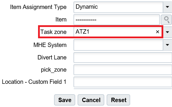

To add a Task Zone to a location:
  1. Go to the Task Zone screen and create a new Task Zone.
  2. Go to the Locations screen, select the desired location and click edit.
  3. In the “Task Zone” field, select the Task Zone that you added in step 1.
For example, if there is a Drop Zone location “DZ1” with Destination Zone “ATZ1”, there will be the following Task Template configuration:
Adding a Task Zone from Location UI
This means that at the end of every “Reserve Units” Task, you are prompted to move the picked LPNs into a “DOOR_DROP” location – which in this case is location “DZ1”.

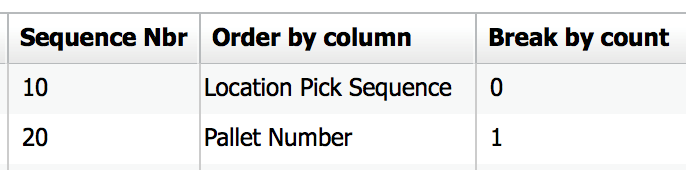

Ordering Criteria
The Ordering Criteria allows you to determine the break logic for each Task. For example, if there is a criteria for “Break by Order Nbr = 1”, WMS will create a new Task for every unique Order number in this Task Type.
  1. Select the Task Type record and click “Ordering Criteria”.
  2. Create a new breaking rule for this Task Type by clicking the Create () button.
  3. Enter the sequence number, select the logic criteria and the ‘break by’ value.
  4. Click Save.
Example:
creating wave templates break by countscreen
  1. Location Pick Sequence, Break by count = 0
    This will sort the creation of Tasks in order of the allocation’s Location Pick Sequence.
  2. Pallet Number, Break by count = 1
    This will create a new Task for every Pallet that is allocated. This may be used in cases where the picking equipment does not allow users to pick multiple pallets at a time.
