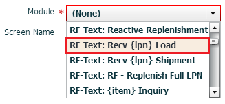

The alternative method is receiving through Loads. You can use this option for scenarios where a Load has multiple ASNs. To add this RF option, go to the “Screen Configurations” screen, click the Create button () and select “RF-Text: Recv {lpn} Load”:
