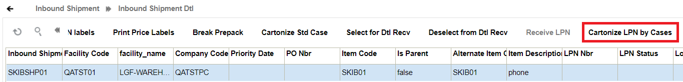

  1. From the “Inbound Shipment” screen, select the IB Shipment from which you want to cartonize the LPN.
  2. Click Details. The Inbound Shipment Detail page opens.
    IB Shipment Details
  3. Select the shipment details and click the “Cartonize LPN by Cases” button.

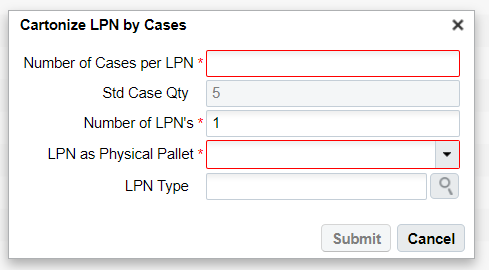

  4. A pop-up window “Cartonize LPN by Cases” is displayed for you to specify the quantity for the items to be cartonized by cases in each LPN.
    Cartonizing LPN by Cases

    Field Parameter Description
    Number of Cases per LPN Enter the number of cases you want to be cartonized per LPN.
    Std Case Qty Displays the Standard Case Quantity defined at the master level for an item.
    Number of LPNs Enter the number of LPNs.
    LPN as Physical Pallet
    Click the drop-down box to select either one of the following options:
    • Yes: Consider an LPN as a Physical Pallet
    • No: Do Not consider an LPN as a Physical Pallet
    LPN Type Select an appropriate LPN Type.

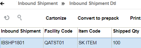

    Inbound Shipment Dtl

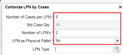

    Suppose an IB Shipment Detail contains a shipment for Item SK ITEM, quantity 100. In the Item Master, SK ITEM has the “Standard Case Quantity” defined as 10.
    Click the “Cartonize LPN by Cases” button and the system prompts you to define cases per LPN as shown in the figure below:
    The system calculates the number of cases to be cartonized per LPN against the Standard Case Quantity and displays the following:

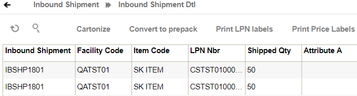

    The system creates two LPNs that have a Shipped Quantity of 50 for SK ITEM.
