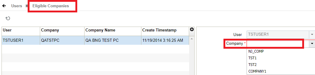

Step 3: Assign Facilities to Users
Once you have created the Companies and Facilities, the next step is to assign them to users. This step defines the list of companies and facilities that you will have access to.
  1. Go to the “Users” screen.
  2. Select the user to modify.
  3. Click on “Eligible Facilities”.
  4. Using the Create (Create) button, add the Facilities that this user will have access to.
  5. Repeat steps three and four for adding Companies (using the “Eligible Companies” button). Assigning Users to Facilities and Companies

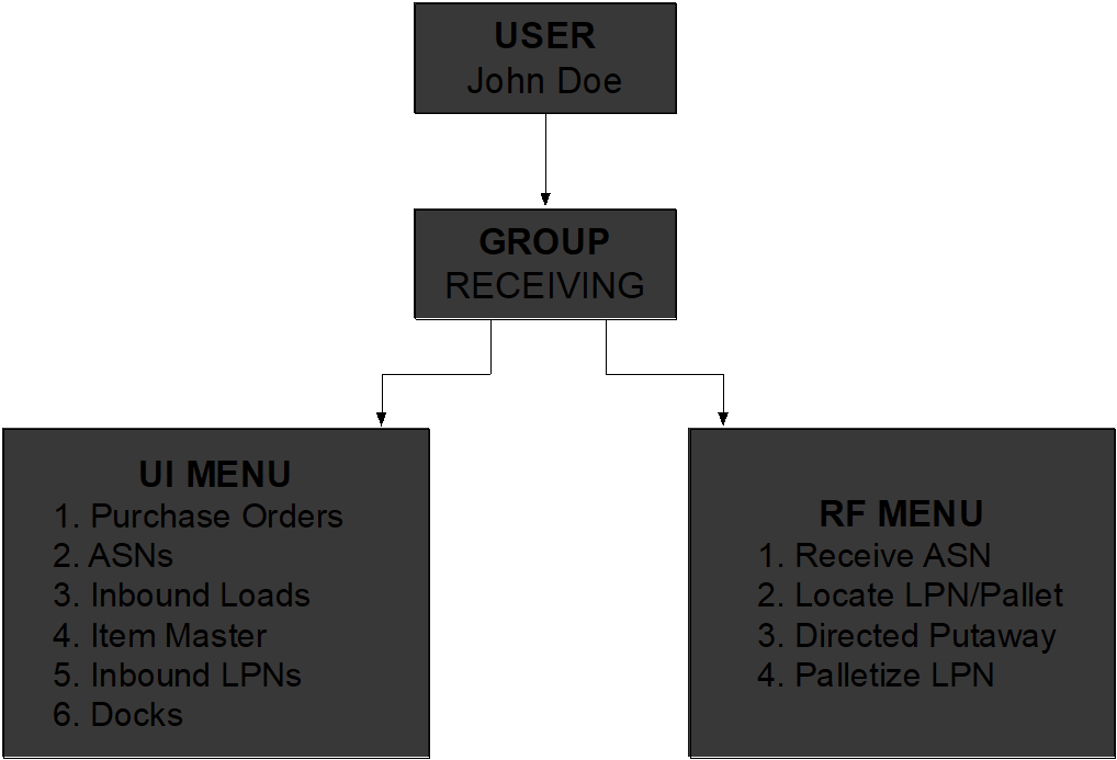

The following is an example of a User/Group set up:
Sample User/Group set up in WMS
