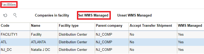

In the Facility UI, the destination facility must be set as WMS Managed:

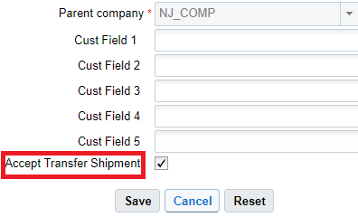

The destination facility must also have the Accept Transfer Shipment flag checked. Select your facility and click Edit to check the Accept Transfer Shipment flag and add any other details:

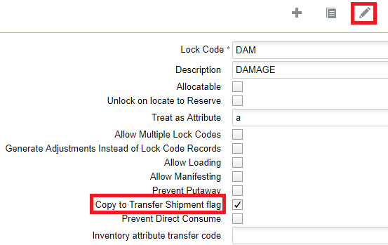

To set up lock codes for transfer shipments, first go to the Lock Code UI, and check the “Copy to Transfer Shipment flag”.

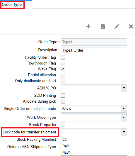

From the Order Type UI, the “Lock code for transfer shipment” drop-down allows you to set up lock codes for transfer shipments.

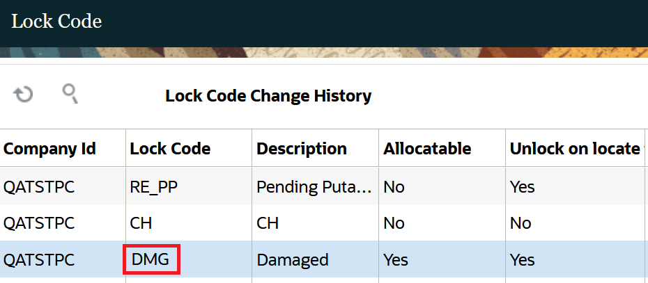

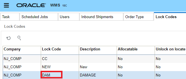

Once you select a Lock code for a transfer shipment, (for example, DAM Lock Code for damaged items) you can view this from the Lock Codes UI:
