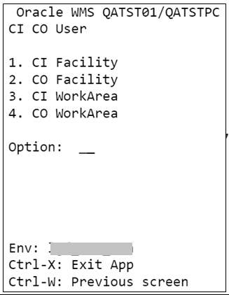

On selecting this RF screen, user is presented with the following options:

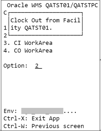

Selecting option 1 sends a “clock into current facility” request to WFM. Selecting option 2 sends a “clock out of current facility” request to WFM. The requests are validated and accepted/rejected in WFM.
Selecting option 3 prompts the user to key in the Work Area that he needs to be clocked into. WMS only validates if the Work Area is valid. WMS does not validate if the user is eligible for the keyed in Work Area. The request is captured and sent to WFM where data is validated and either accepted or rejected.
Selecting option 4 prompts the user to key in the Work Area from where he needs to be clocked out of. WMS only validates if the Work Area is valid. WMS does not validate if the user is eligible for the keyed in Work Area. The request is captured and sent to WFM where data is validated and either accepted or rejected.
