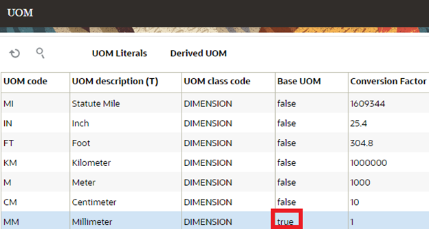

UOM Configuration Screen
The Unit of Measure (UOM)UI module (UomView) gives you the flexibility to configure other UOMs in addition to the existing supported system class UOMs (cubed, cases, packs, pallets, LPNs, and units.)

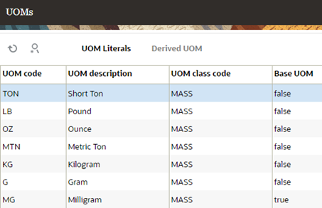

The UOM UI allows you to group and view additional UOMs that belong together in the same UOM Class.
In the following example, you can see all of the different UOM codes (measurement categories) that have been grouped as MASS:
| Field | Description |
| UOM Code | You can define a UOM Code for each UOM. This will serve as an abbreviated name for the UOM that typically correlates to the UOM description. |
| UOM Description | UOM description describes the type of UOM. |
| UOM Class Code |
Defines the UOM class associated with the added UOM.
| Base UOM | This field should be Set to True for the base UOM and False for the other UOMs in the same UOM class. |
| Conversion Factor | You can view the conversion factor of the UOMs with respect to the base UOM. |
| Predefined Flag | This flag is already automatically predefined and set to true for existing defined UOMs. It will be set to false for newly created user UOMs |
| Is Package UOM Flag | Set to Yes if the UOM is a package and No if the UOM is not a package. |
| Create/Modify User | This field filters the records modified by user. It also supports partial search and you can search for multiple users by providing comma separated values. |
| Create/Modify Timestamp | This field filters the records created and modified within the provided range. |
- Users should be able to view the system class UOMs by default upon launching the UOM configuration UI.
- System UOM Class encompasses our legacy UOMs like Packs, Units, Cases, Cubed, LPN, Pallet.
For example, where the UOM is 1 Millimeter, the corresponding conversion factor for Centimeter is 10.
