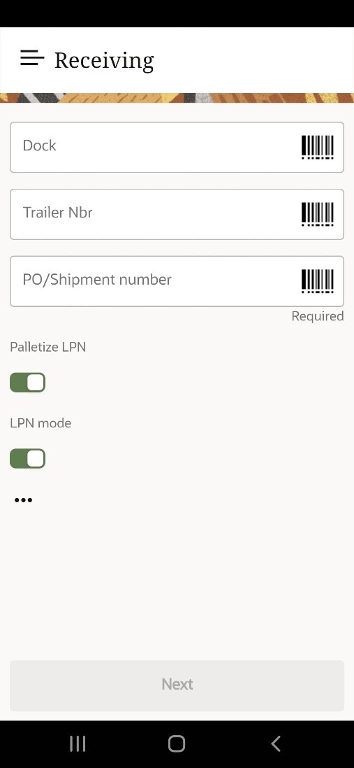

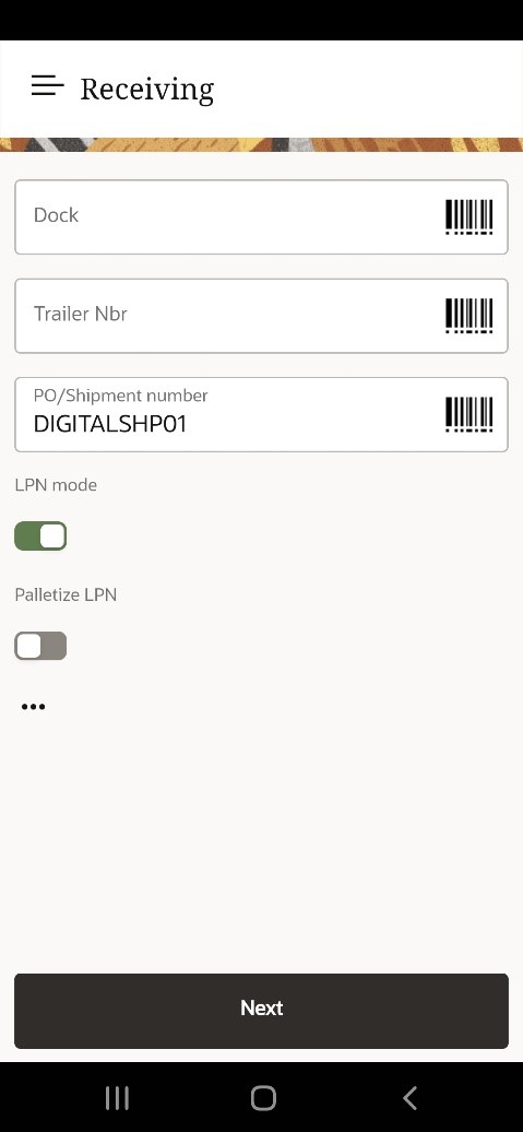

Login to your Mobile App > tap the Receiving module. The Receiving screen appears.
Receiving Main Screen
Receiving
Fields Description
PO/Shipment number (Required) Accepts PO or Shipment Number. If the PO has multiple shipments available, then a pop-up window is displayed with a list of possible values.
Dock Accepts the Location barcode or dock number.
Trailer Nbr Accepts the Trailer number.
Palletize LPN
Enabled, by default. Accepts the pallet number of the LPN and the pallet screen appears.
If the toggle is off, the respective receiving mode appears.
LPN Mode
Enabled, by default. Receives LPN and prompts you to enter the content for the LPN.
If the toggle is off, the receiving mode is switched to SKU mode receiving. An advantage of SKU mode is you can receive multiple LPNs that have the same content.
Cross Dock Disabled, by default. Allows you to cross dock LPNs during receiving to help fasten the order fulfillment.
Allows you to customizes the Receiving screen layout.
Next Click to proceed to the next screen.
The Receiving screen has toggle buttons that are enabled, by default:
  • Palletize LPN: When this toggle is enabled, you are prompted to scan a pallet in the next screen.
  • LPN Mode: If the LPN mode toggle is enabled, you are prompted to scan a LPN and then the SKUs or inventory that belong to the LPN. If this toggle is disabled, you will be receiving using SKU mode.
  • Cross Dock: The cross dock LPN is functional only after enabling the toggle and configuring a valid parameter values.
  • Pallet contains

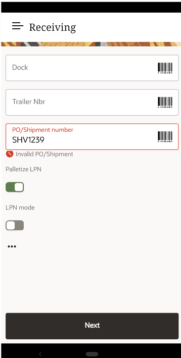

    1. If an invalid PO or Shipment number is entered, the system displays an Invalid PO/Shipment error message. For example,
      Invalid PO Number

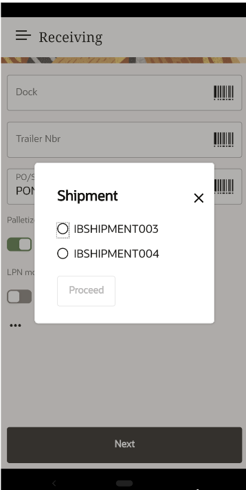

    2. If a value is available in the PO table, and the PO is related to multiple shipments, then a pop-up is displayed for you to provide with the Shipments linked to the PO. It will only show Shipments that are in a status less than receiving completed. On selecting the shipment value, the system will start the receiving process for the IB Shipment.
      Inbound Shipment

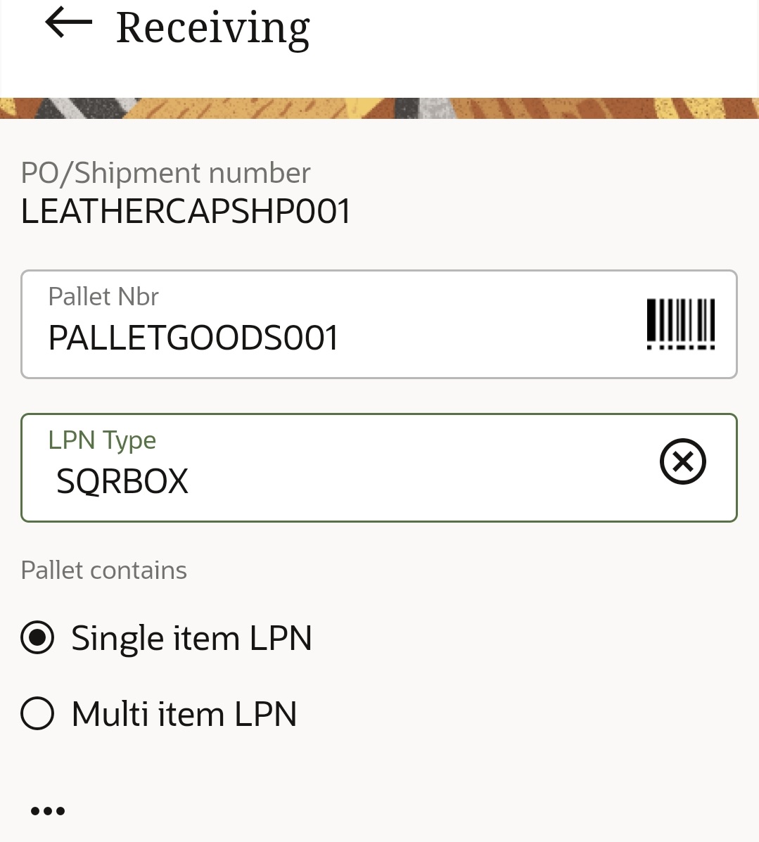

  1. If Palletize LPN toggle and LPN Mode toggle is enabled. The system prompts for the pallet number in the next screen.
  2. Click Next.
  3. Enter the Pallet number in the Pallet Nbr field.
  4. Select the type from the list of values in the LPN type drop-down field.
  5. Choose the Pallet contains type:
    1. Single item LPN: Supports receiving of single item LPNs.

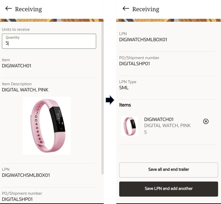

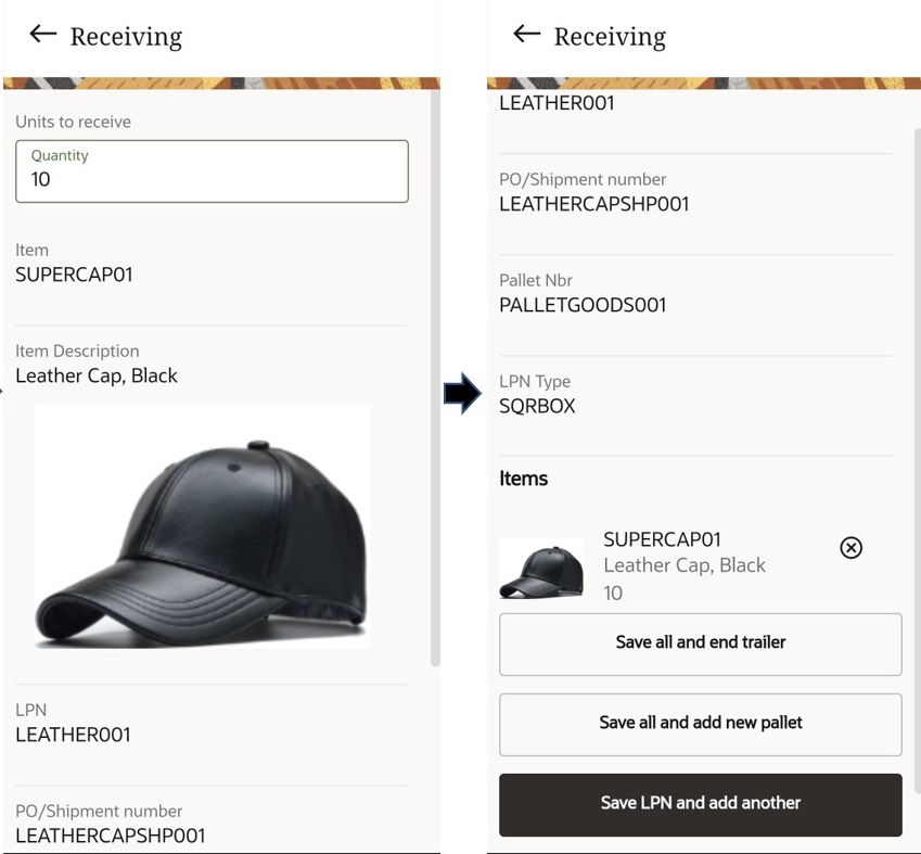

    3. Enter the LPN number in the LPN field > Enter the item Barcode in the Item Barcode field.
    4. Enter the quantity in the Units to receive > Quantity field.
      Single Item LPN Mode Receiving

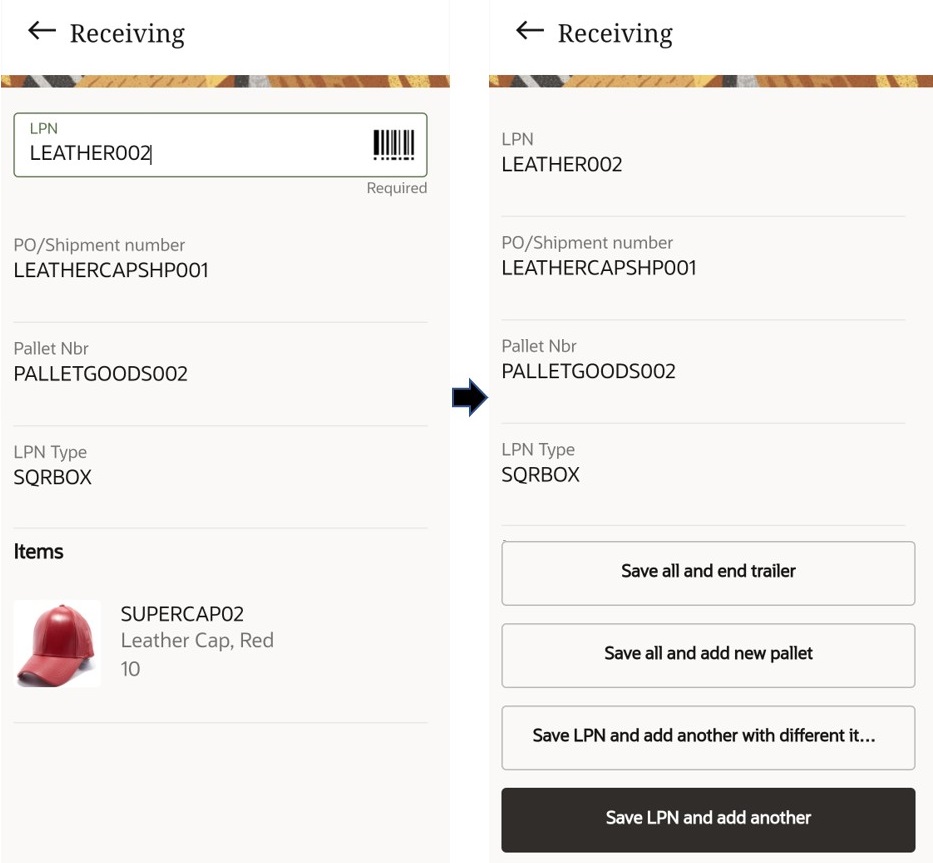

      After successful receiving, the summary screen is displayed with the following options:
      Summary Screen
      Options Description
      Save all and end trailer Saves all the records, ends the trailer, and the app routes you back to the main Receiving screen to scan a new shipment.
      Save all and add new pallet
      Saves all the LPN records and ends the current pallet. You can use this option to add the remaining SKU from the same shipment but on a new Pallet. The screen flow returns back to the Pallet screen where you scan a new pallet number.
      Note: Enter a different LPN number for the new pallet.

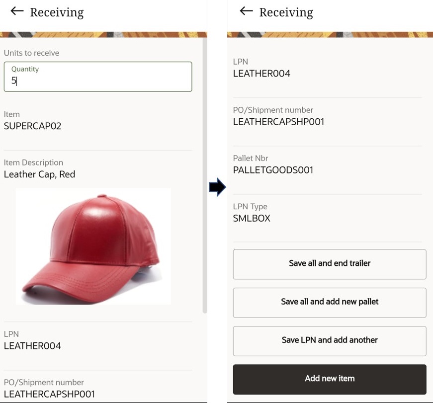

      Save LPN and add another Save the current LPN and add the same or different SKU from the same pallet but on a different LPN. The screen flow returns back to the LPN screen where you can scan a new LPN for the same pallet.
      1. Multi-item LPN: Supports receiving of multi- item LPNs.
        1. Select the Multi-item LPN button and click Next.
        2. Enter the LPN number in the LPN field > Enter the item Barcode in the Item Barcode field.
        3. Enter the quantity in the Units to receive > Quantity field.
        Add new item This option is visible only if you receive multiple items by selecting Multi-item LPNs radio button Pallet screen. On tapping this option, the application takes you back to scanning the item barcode screen.

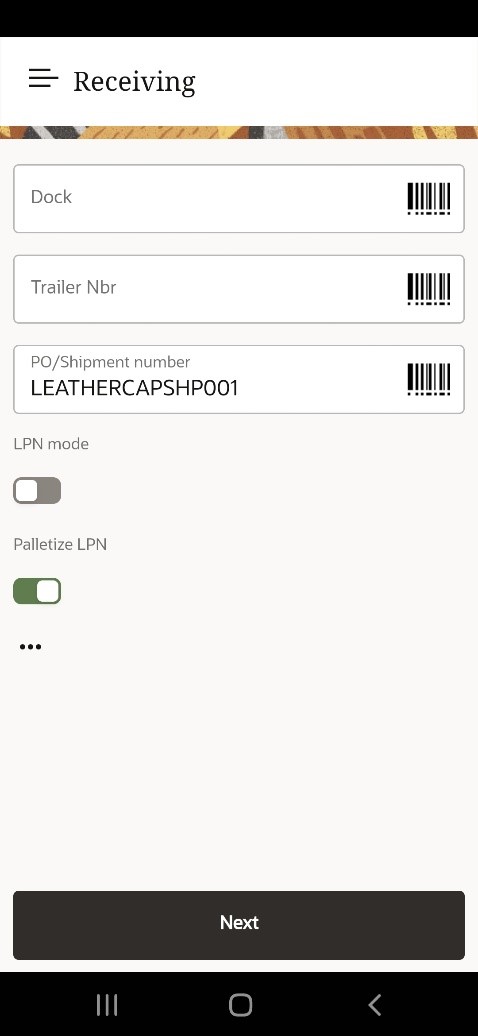

  1. From the Receiving screen, enter the PO/Shipment number.
  2. If Palletize LPN toggle = enabled and LPN Mode = disabled. The system prompts for the pallet number in the next screen.
    SKU Mode
  3. Click Next.

  4. Enter the LPN number in the LPN field > Enter the item barcode from the Item Barcode field.
  5. Enter the quantity in the Units to receive > Quantity field.
    Receiving LPN without Palletize mode
    After successful receiving, the summary screen is displayed with following options:
    Non-Palletize Mode Summary Options
    Options Description
    Save LPN and add another Saves the current LPN and add the same or different SKU from the same pallet but on a different LPN. The screen flow returns back to the LPN screen where you can scan a new LPN for the same pallet.

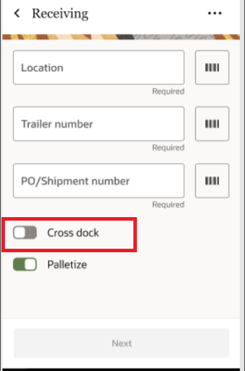

Cross Dock LPNs during Receiving
In your Receive module, enable the “Cross dock” toggle. On launching the receiving module, the Cross-dock toggle will be disabled, by default.
Cross Dock
To help reduce the time needed for order fulfilment during receiving, configure the xdock-mode in the receiving module with the following parameter values:
