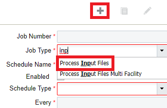

  3. To run the Process Input File:
    1. Go to the Scheduled Jobs screen, click Create (+).
    2. Select Process Input Files from the Job Type drop-down and populate all remaining Mandatory fields. Refer to https://www.oracle.com/pls/topic/lookup?ctx=fa22d&id=u30225849 section for description.
    3. Configure the respective parameter for the selected Job Parameter – Refer to OWM-ScheduleJob-v1-R21A.xlsx file.
