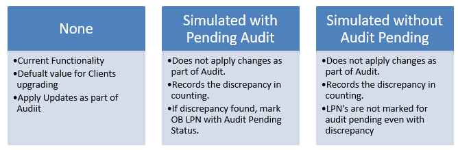

Audit Mode
The Audit Mode parameter has three choices:
- Simulated with Pending Audit
- Simulated without Pending Audit

Whether the Simulated Audit Mode is configured for Normal Mode or Simulated Mode, the following updates apply:
- When an extra unit or an item that does not belong to the OBLPN is scanned, the error “item does not belong to OBLPN Discrepancy will be recorded” displays. You can accept the message with Ctrl-A and physically take out the extra unit/sku that does not belong to the OBLPN at hand. If you press Ctrl-W, you are returned to the Sku Prompt screen without recording the discrepancy.
- Scanned items and quantity per item are recorded for each sku. The scanned items and quantity are stored and displayed in the Audit Detail History screen.

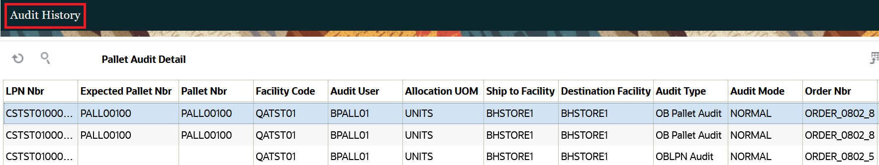

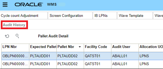

Audit History
The Audit History screen shows most of the detailed information for the audit so that you often do not need to go to the details screen to view details and discrepancies. The following screen shows what the Audit History screen looks like. Refer to the Audit Detail History Columns section below for more details.
From the Audit History screen, you can click Pallet Audit Detail to view details such as expected and scanned number of LPNs, difference, number of expected LPNs scanned, and OBLPNs not anticipated.
| Column | Description |
| Pallet Number | Pallet Number which has been scanned in Audit, If Pallet not Scanned display null |
| Audit OB LPN Number | Outbound LPN which has undergone Audit |
| Load Number | Load Number associated to the Pallet/OB LPN. If OB LPN is associated with Parcel carrier then display Load Number field blank |
| Expected Pallet Number | When OB Pallet is scanned, this column depicts the pallet number associated with the OB LPN Scanned |
| Audit Mode | Normal or Simulated |
| Audit Type | OB LPN Audit or OB Pallet Audit |
| Item Code | Item Scanned, If Outbound LPN scanned has multiple sku’s write different rows for each sku |
| Packed Qty | Packed Qty associated to the inventory record for OB LPN. Qty Present on the OB LPN when the Outbound LPN was Packed. |
| Current Qty | Qty present in OB LPN during Audit (Can be 0 if Sku scanned is not anticipated in the OB LPN Scanned |
| Audit Qty | Quantity audited by User (Can be Zero or less or equal or greater than current qty) |
| Unit Variance | Current Qty-Audit Qty (If Audit Qty is greater than Current Qty, display the value in brackets). |
| Total Pack Cost | Unit_Cost for the item times the quantity expected for the sku in the OB LPN |
| Total Audit Cost | Unit_Cost for the item times the quantity Audited for the sku |
| Cost Variance | Total Pack Cost-Total Audit Cost. (If Total Audit Cost is greater than total pack cost, display the value in brackets). |
| Alternate Item Code | An alternate representation of the SKU, which concentrates SKU parts A through F into a single record. |
| Audit User | User who performed the audit transaction |
| Item Description | Description of the item. |
| Destination Facility Code | Destination facility for the OB LPN Scanned in Audit |
| Ship to Facility Code | Ship to facility for the OB LPN Scanned in Audit |
| Allocation UOM | Units/Packs/Cases |
| Pack Qty | Item’s Standard Pack Qty |
| Standard Case Qty | Standard Case qty from item |
| Pick User | Pick user associated to the Outbound LPN |
| Pack User | Person who Packed the Outbound LPN. |
| Audit _ts | Create time stamp of when Audit Performed |
| Packed_ts | Time Stamp of when the Outbound LPN was packed |
| Manifest Number | If Outbound LPN is not associated to load, display manifest number, if associated to Manifest |
| Order Number | Order Number associated to the OB LPN |
| Order Type | Order Types differentiate orders based on certain characteristics. |
| OB LPN Type | Container Type associated with the Outbound LPN Audited |
| Allocation Type | Allocation Type from the Corresponding Allocation Record associated with the Outbound LPN |
| Batch Number | Batch Number for the Item Associated with the Outbound LPN Audited. |
| Item Hierarchy Code | Describes the item hierarchy. |
