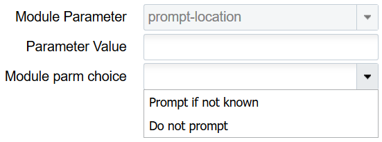

- Select the “prompt-location” parameter. Click Edit ().
- From the “Module parm choice” drop-down, select the desired option. The screen parameter “prompt-location” can be configured with one of the following options: The screen parameter “prompt-location” can be configured with one of the following options:- Prompt if not known: Location prompt will be displayed
- Do not prompt: Location prompt will not be displayed
- If this parameter is not configured, system will default to the behavior described for the option Prompt if not known above.
